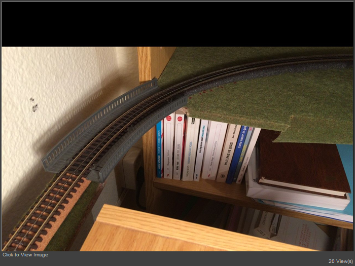

I have used a steel cable designed for the changing device in bicycles, together with Peco flexible rail. Its diameter is 1,1 mm and may be glued to the centre of the sleepers with very small drops of epoxy two-component glue (Araldit for example). The cable used for the brakes is a bit thicker (about 2 mm). It works perfecty. You may watch the general aspect in the image.Via Peco flex.jpg

The diameter of brake cable is actually 1,5 mm
