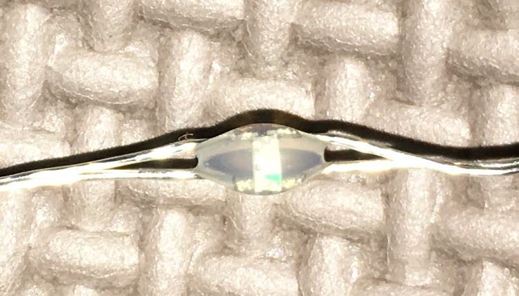

Posts: 3,575
Hi Andy
This will not answer your question as AFAIK those LEDs do not exist BUT there are very inexpensive Christmas LEDs strings on 2 wires (all LEDs are wired in parallel.
So by taking a warm white LED and adding a resistor (1 kOhm or so) allows to have a simple inexpensive solution (here that kind of Christmas LED is priced around 3€ to 4€ for 20 LEDs
Here is one LED (approx 1.5 mm long and less than 1 mm wide
Don't forget to remove the insulation coating on the wires and figure the proper orientation (it has no rectifier bridge nor resistor)
