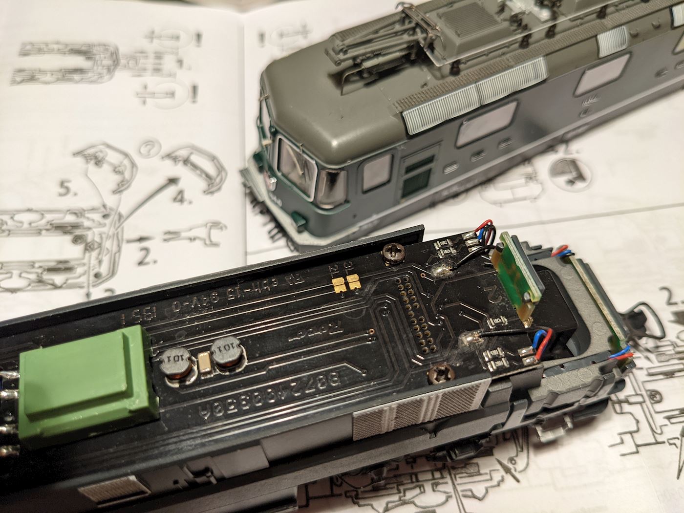

After programming it, I however struck an issue while calibrating/"einmessen" the model. It "slowed down" or stopped on some places on the layout.
Made no sense, investigated, found that the common denominator of the spots where it slowed down is that they are all contact tracks.
Next step I found that the slowing down depended on the way the engine sits on the tracks.
And pulling out my multi-meter measured that
- all wheels on the right hand side are electrically connected with each other, and
- all wheels on the left hand side are, but
- there is no electrical connection between the left and right hand side wheels.
Perfectly appropriate for 2 rail/DC but useless from an AC perspective, particluarly when one uses S88 contact tracks.
I'm on the point of soldering a bridge between the ground contacts of the PCB to connect left and right.
Did you, or anybody experience something similar?
For completeness: I got a few other Roco AC engines and they are all fine and none of them showed this behaviour.
Any feedback welcomed,
Thomas

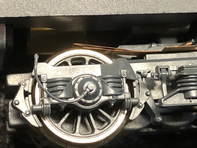

I have noted on recent locomotives that there seem to be a greater number of contact issues. I have not investigated the models in depth.
One thing that I did note is that there is a tendency to use wheel contacts whereas older models were more likely to have axle contacts and that the wheel contacts tend to be smaller and have a reduced contact profile compared to older models.
The fact that you suggest that your 79404 has insulated wheels suggest that the wheelsets are DC (not AC) as AC wheelsets would normally be a single piece and would bridge the two rails.
I would check the model to see how the return contacts are designed/installed. On the DC model, each bogie has a contact on one side, one for the left rail and one for the right rail. On older AC models, one bogie would have the AC slider and the other bogie would have the return contacts (wheels). To save money, a company might decide to keep the DC wheel contacts but to add the slider, which would allow them to use the same parts for the wheels and contacts for all versions. The 2 return contact leads would then be merged at or on the PC board.
The DC model has 4 powered axles, where, AFAIR the AC model has 3 powered axles. One option would be to ensure that the 4th axle (not powered) is a non-insulated axle, which would bridge the two rails together for purpose of contact tracks, etc.
My preoccupation here would more be that lateral movement of a locomotive bogie in such a setup could cause the locomotive to have a weak contact or to stall if said motion reduces the contact between the wheel used for return contact and the rail, as the opposite wheel would not serve to maintain contact in such an instance.

to run my purchased DC locos, all I have to do is connect the 2 wires from each side of the wheels and solder them to the ground soldering pad and your problem is solved, you don't have to touch the PCB.

I have the Roco 79404, it is a terrific model, but initially there was a problem.
The factory had set it up for neither two rail or 3 rail on the PCB, but luckily it did have the slider installed.
I had to solder on the PCB the 3 Rail solder jumper.
Easily done, it seems all manufacturers are having quality issues during the pandemic.

Snap! Same problem here. I soldered/bridged the 3L connector on the PCB.
Now the wheels from both sides are electrically connected and the contact tracks are fine.
And I agree, it is a nice model.
