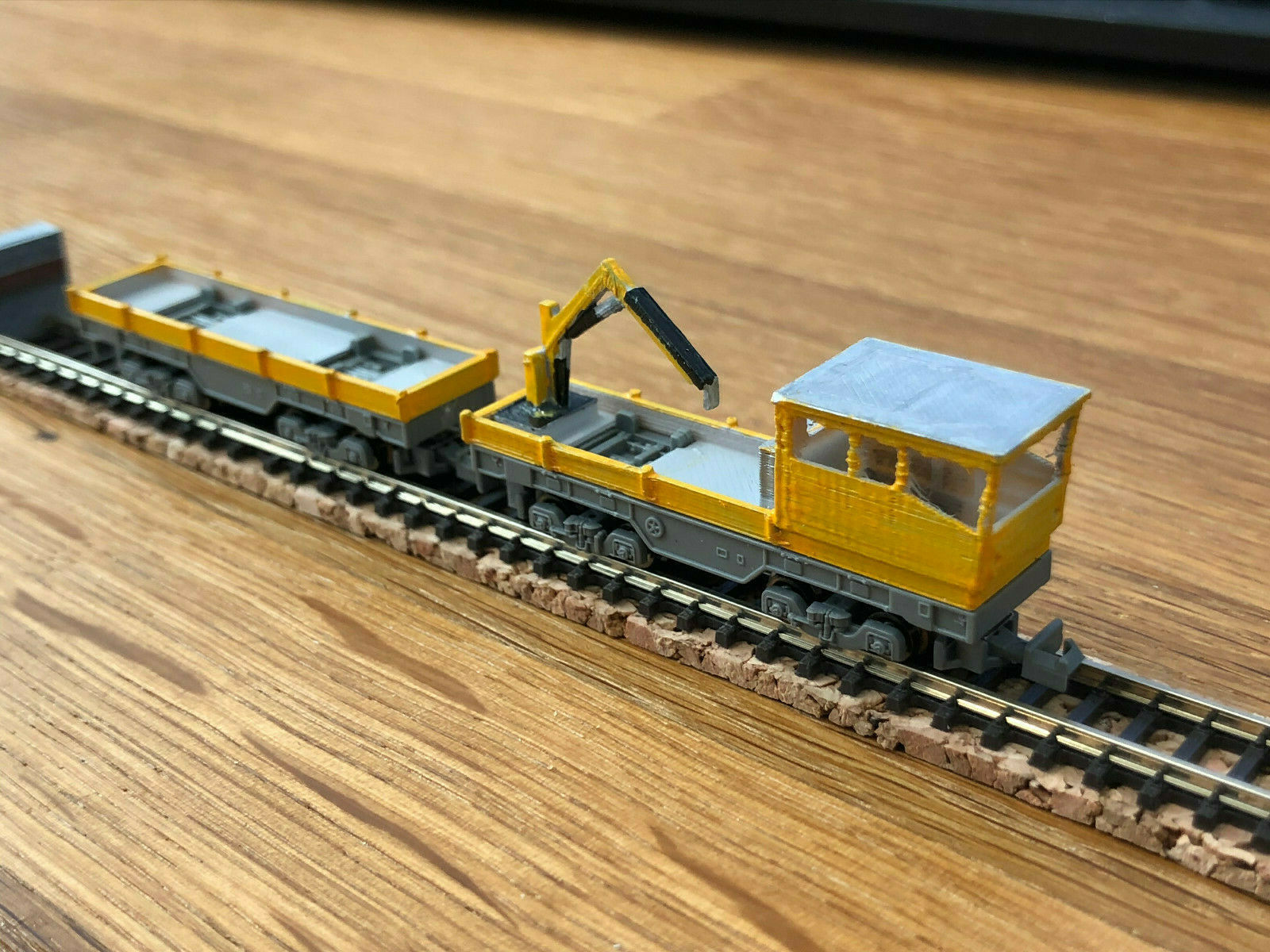

Hello Fellow Enthusiasts
One thing I have always liked are maintenance trains. After searching, I found that there isn't much alternatives available.
So after some extra search I found this on Ebay:
However it is not powered.

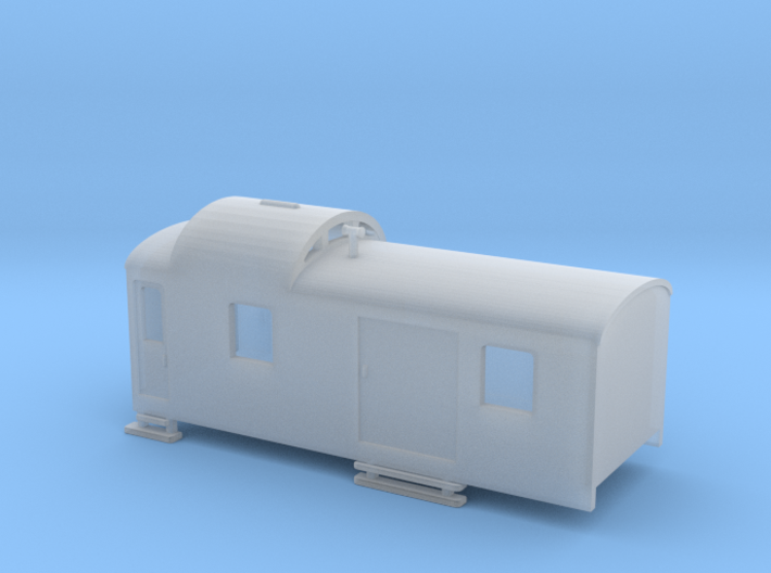

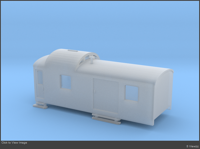

So a after searching a little more I found this on Shapeways:
That can be converted and used as a mobile workshop.
And this one can have a Rokuhan Shorty Powered unit inside.
Hope it doesn't derail, since the traction power will be in the second car. Fingers crossed.
So the order as been placed and I am waiting for the shorty. The rest as already arrived.
While it doesn't arrive I would like to ask you all, if by any chance you have photos of the interior of the draisine. I imagine it will be a very spartan interior with black seats.
What I don't know is the interior color, as well as the color of the console.
Does anyone can help?

Hi. That is always my problem, painting the Shapeway railcars or locomotives. Also the painting may highlight some of the grain in the print medium. Or does it cover it up? I am not sure. I tend to stay away from Shapeway shells because of this. Not that the shell is the problem, they look excellent. I just don’t know if I could get one to look correct with enough details. I have seen sites which sell decals, but you have to ask for them in z scale.
Is that a photo of a z scale work car and your intention is to add the Shapeway shell to it as a motorized unit?

Hello Dwight
Since the Crane car hasn't space to be motorized, my idea will be to power the work car. This means I'll have to put the work car (the power unit) right behind the leading car (the draisine).
I know that the second car should be the flat car where the spare parts are transported, but I am afraid that having the power unit in the third position will be an invitation to frequent derailments.
I'll have to dig more deeply to find photos of the internal layout of the draisine cab and some color references.

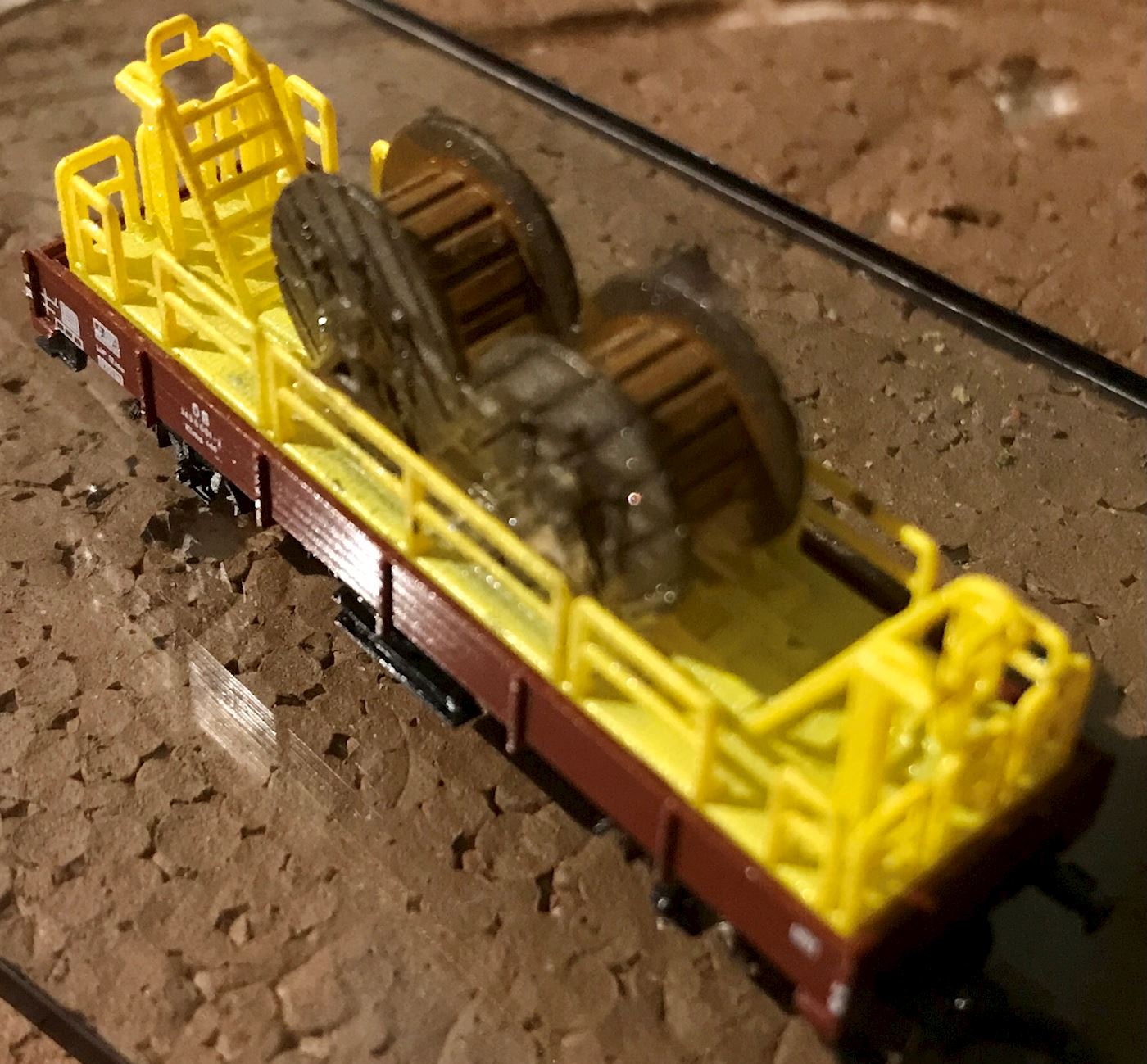

Hi. There is not much added on the weathering link I gave you.
On the Marklin z work trains, the passenger type wagons are usually in a blue shade. I have a work train set with the older three axle passenger wagon in blue, as is the two axle included in that set. It is possible, in that ERA blue was the color to indicate work wagons.
I was thinking about your work trains and was wondering if you found the Shapeways work racks which are designed to be added to the regular low side flat wagon (8610). I have one which is depicting the wagon used for overhead line maintenance. I believe there were several different ones. I used spray paint in yellow and it looks fairly good.

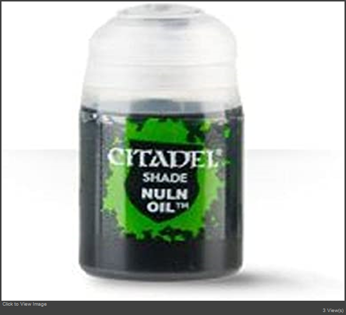

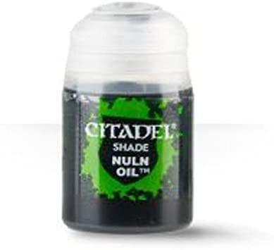

Hello Again Dwight
It looks great, I'll search for it.
I use with great results Citadel Nuln Oil to do washes that represent dirt, shades, etc. You just have to use it as paint, all over your painted the model. Do it with a normal paint brush and remove the excess with the same brush (after a bit of drying). It will flow to the edges of the panels, holes, fissures, etc. The effect is very good after you master it.
You should practice a little bit first, otherwise will leave the model just to dirty. Another tip is just to paint the base color in a lighter shade, because the Nuln Oil will darken it a little bit.
You can find this product in any modeling or wargaming store.
Give it a go.

Thanks. Will check it out.
I photographed this on a piece of plastic which caused that shinny appearance. I got some Velajo acrylic paints and they have a similar product.

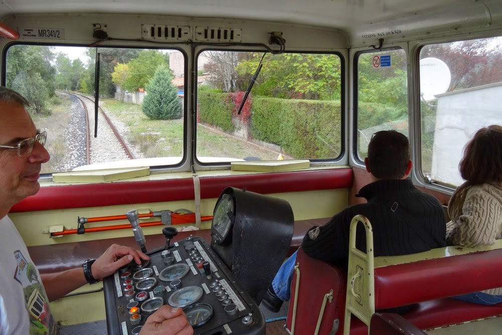

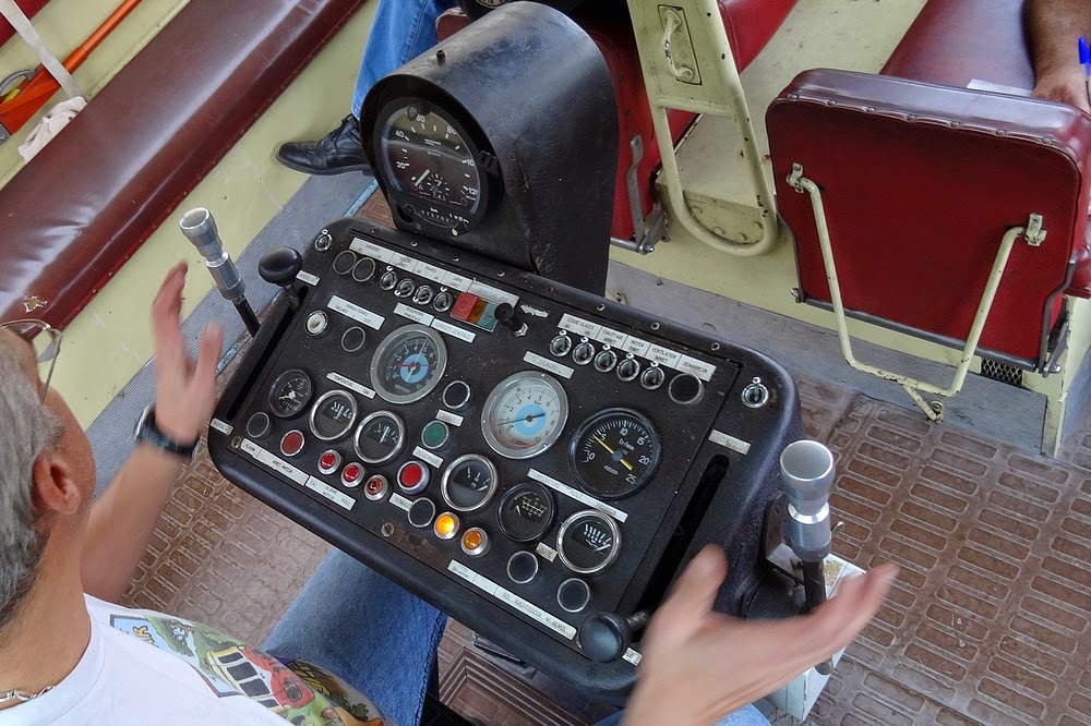

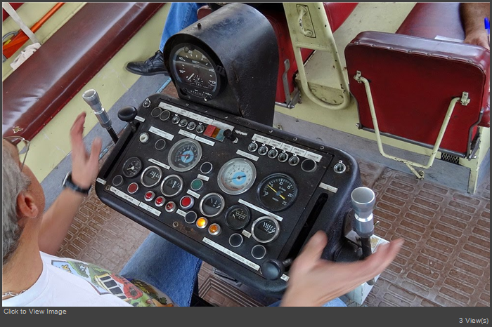

Hello fellow enthusiasts
I final found some pictures of a possible internal layout and colors used inside a draisine.
Of particular interest is the driving post (facing sideways). It makes some sense, since it allows driving in both directions (and maybe using the crane).
