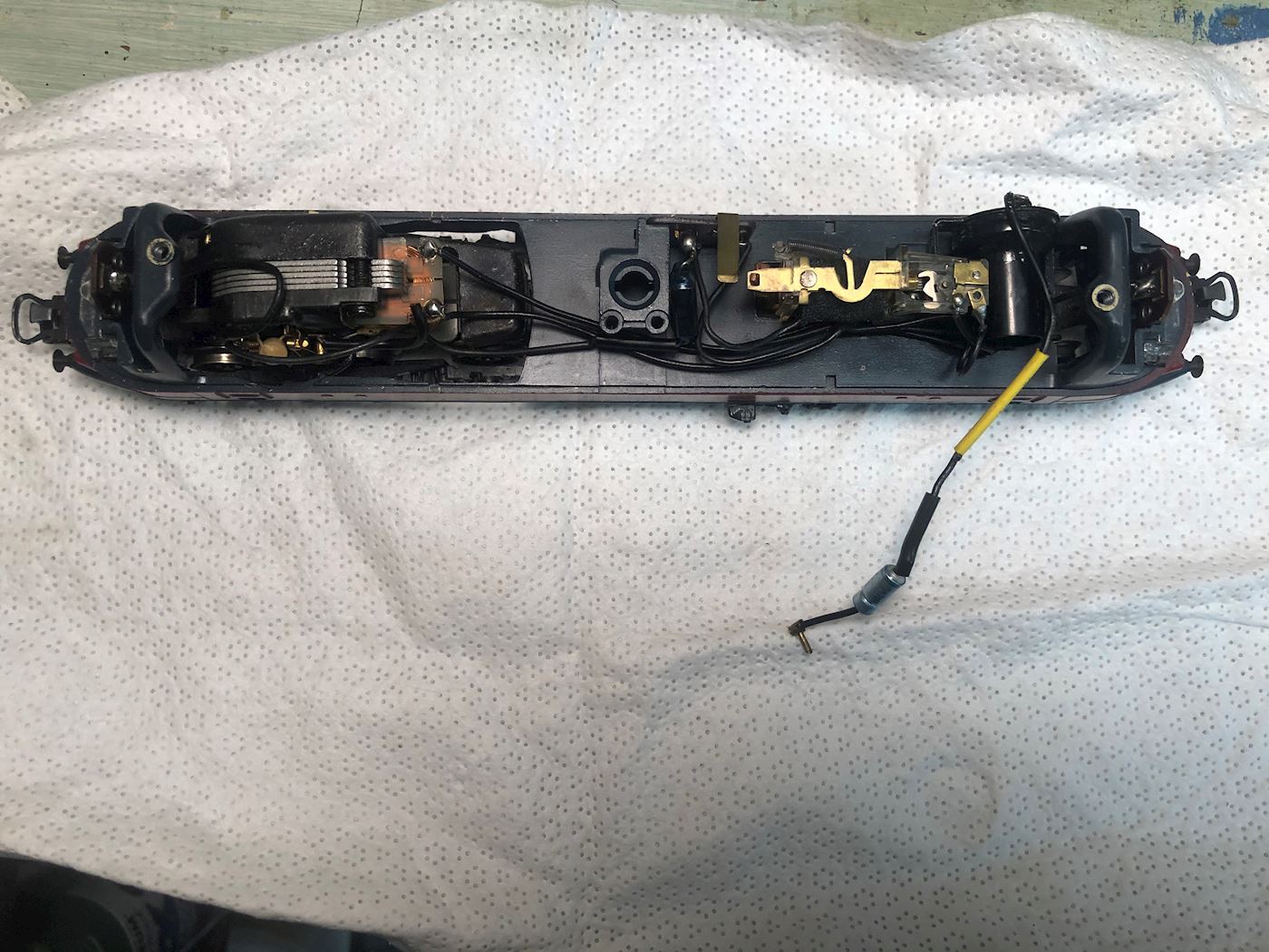

Does anyone have or know if there is a wiring diagram for the Marklin 3053? One of the wires on my came off and I can't figure out where it goes. Any help is appreciated.

I have that loco. What wire has come off? Pictures.!! I may be able to help.

Here is a picture I hope you can see the wire.

I don't think the question can be answered by somebody looking at the OEM schematic or at a like new model.
The wire that is loose on the tablecloth seems to be the one leading from the aftermarket Maerklin speaker/horn
This topic might answer your question: https://www.marklin-user...818-Old-7214-horn-wiring
The horn had to be installed in the locomotive as shown in the diagram for the 7213 and was actuated by the 7215 unit.

Your provided image of your locomotive innards suggests that it is analogue (because there is no
visible decoder, there is an analogue reversing unit and there is an analogue era choke which I have
circled in red) :
and provide further examples:
As noted above, I am a rather naïve Märklinist OhMyGod but (notwithstanding the speaker/horn connections),
the analogue choke was usually connected to the “common solder point” (circled in red below):
So , perhaps it would be worthwhile to try connecting the loose wire to the “common solder point”
/ "main solder point" shown in the image above and referenced as #4 in the circuit diagram below :
I do note from your image however that there is not enough distance from the tip of your loose
wire to where one might expect the CSP to be on the motorshield, so it was probably soldered to the
similar CSP connection on the reversing unit as shown as a blue circle on the circuit diagram
below :
I have not ever encountered the “aftermarket Märklin speaker/horn” Huh (fascinating), nor did I know that
“the horn had to be installed in the locomotive as shown in the diagram for the 7213 and was
actuated by the 7215 unit.” – I learn something everyday on this fantastic forum ! (thanks mike C) ThumpUp

Looks like yours is different to mine. All my wires are black. mine doesn' t have that cylindrical object in front of the reverse unit. Mine has the engine room light in the middle whereas yours doesn't. Unlike PJ's thpough, all the paint came off my top body.

If, as has been suggested, this is an aftermarket add-on horn, then I suspect that is a capacitor. But it would still need to be connected somewhere to the pickup shoe. So look for where the wire comes from the pickup shoe onto the reversing unit, and that is where I would expect to connect it.
On the other hand, if you do not have the other item that is required to make the horn operate then I would suggest removing the horn altogether.

I agree that that wire is part of the horn along with the condenser or choke on the wire. That end would be connected to red side of track power (slider, centre rail, bahnstrom, etc.) so it may have been connected to the centre board where the switch from slider to overhead pickup is located. As Mike C mentioned, you need a external box connected to the rail to actuate the horn. The horn is attached to the locomotive frame by a small screw which also provided the grounding for its circuit.
My experience with that horn: It's not worth the trouble so get rid of it, it was a terrible piece of aftermarket accessory for analog trains.

Thanks for your help I got it working
