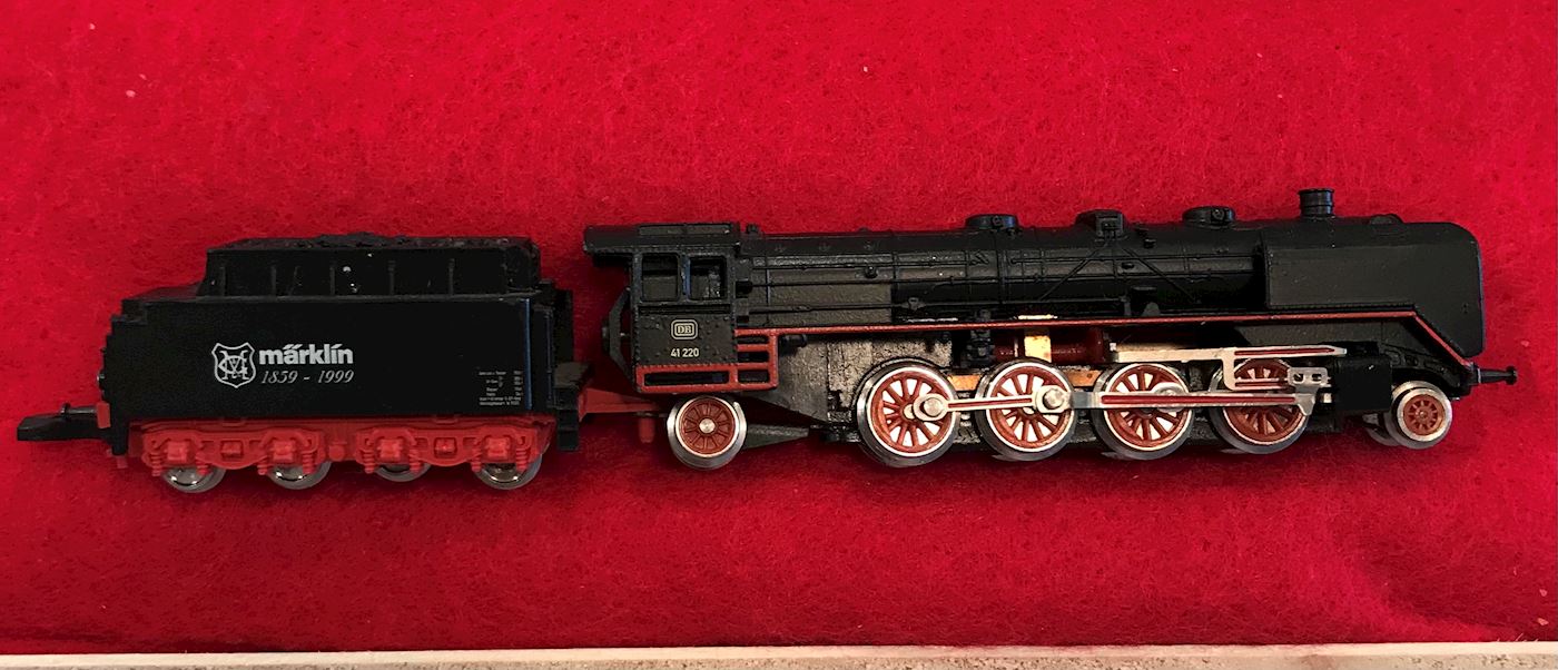

I’m sorry for the 150 year Marklin. It’s actually 140 year Marklin and the locomotive number is 41 220

Hello again. It is possible that is a special model loco which was part of a set #81780. It consisted of the following parts:
1 freight train locomotive with towing tender BR 41 of the DB (8827), 1 low-board wagon with tarpaulin Klms 440, 1 mineral oil tank wagon BP, 1 open freight wagon E 037, 1 beer wagon Warsteiner, 1 freight train companion wagon Pwg 012, 12 straight tracks, 12 curved tracks, 2 electromagnetic turnout swaying assistance, switchboard, distribution plate, cable, plug, etc.
That loco by itself is an 8827, in 1999 the set included the tender with this engine which was scripted with the logo mentioned. This is a three pole motor version, metal shell and frame, 4 drive wheels arrangement 2-8-2. A five pole version came out in the set in 2000.
Yours is a fairly limited production item.
Hope this helps.
PS. that boxed set has not been added to the Wiki yet.
Dwight

I contacted Marklin in Germany. They answered my request and asked me to send them a picture of my Locomotive. I sent it earlier today and their is a five to six hour time difference. I’m hoping to hear from them this evening or tomorrow. Thank you for your information. I’m going to post a picture of my Locomotive on this site.

I have to find a way to send my photo. I have been away to long. Any help would be appreciated.

Click the paper clip icon. The photo icon is for web based images

Offline zscalehobo

I hate to break it to you but that's just an 8827 with a special imprint on the tender.
Same loco as in 81780. Identical. 2-8-2 shields 41 220 ......

Thank you for the info as I’m just looking for product details for the Locomotive. I’m sure you ‘re right about it being the 8827. I ‘ll just see if there was any thing other than the Logo under the product details. I’m glad to be back on this forum.

Hi. As I mentioned earlier, I found it in this loco in the set 81780.
Here is a link and photo of it in the set. The write up says it was only sold in the set in 1999. 140 years of Marklin would support this conclusion 1859 - 1999 but it might have been manufactured in 1998 or thereabouts.
https://www.lokmuseum.de...ahr=-1&bisbaujahr=-1
I don’t have the Koll’s or other reference for z scale but have found lokmuseum to be fairly accurate.
Sometime sets are broken up and sold separately, this might lead to some confusion about the individual pieces and their history.

The photo was posted to Trainini Spur Z Facebook page where the foremost experts in Z reside.
They all said "81780 with special anniversary printing." I think Dwight nailed this further above
