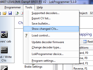

4. Once you open it go to "Function Mapping" notice you will see the functions mapped by default on your loco, when you press a function button you get the sound/function corresponding to what is shown in the table (see screen shot)
5. Remap the functions buttons to your choosing. For more on how to remap/use function mappings here's a good video. In my case example I wanted the loco to make steam on F3 instead of the announcement #2 sound (see screenshot)
6. You can also modify any other function mapping of your choice; i.e. dimmable headlights, sound on reverse, max speed...etc. Once you are satisfied with your customizations. go to the the Tools Menu > select Show Changed CV's (see screenshot)

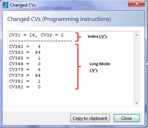

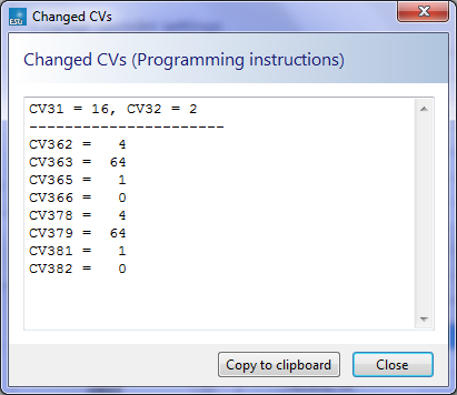

7. Once you click on that you will get the code of CV's that need to be changed to new Values (see screenshot)

n. So if you look at CV list we generated (see step#7) it's made of short mode CV (index CV's) and Long mode and I am going to explain how to input them using your 6021. See screen shot
o. Remember from step "L" your Headlights are still flashing waiting for CV to be entered: so here we need to set CV 31 = 16, so on your 6021 enter "31", click REVERSE and then enter "16" click REVERSE the headlight will turn solid light for a sec and then flash again. Next we need to enter the second Index CV32 = 2. on your 6021 enter "32" click REVERSE and then "02" click REVERSE your headlights will turn solid light and then will flash again.
p. Now you need to enter the Long Mode CV's we have a a total of 8 to enter. These are made of 3 digits but your 6021 can only accept 2. so Lets starts with the first one this is how you do it
q. Enter "07" click REVERSE enter "07" again click REVERSE notice how your headlights will begin to flash faster, they are now in long entering Mode.
r. We begin with the first one CV362 = 4. Remember the 6021 does not accept more than 2 digits and no 00 and no 99. so you have to enter it in double digits this is how. To set CV 362 = 4. You enter "36" click REVERSE (here you will get long headlight flash-short) "02" click REVERSE (long Headlight flash -short-short) "80" click REVERSE (long Headlight flash -short-short-short) "04" click REVERSE Solid headlight Flash it is now registered.
s. So in simple terms the long mode always has 4 inputs of double digits: "XX" REVERSE "XX" REVERSE "XX" REVERSE "XX" REVERSE
So when you want to set 362 to 4 meaning "36-02" to "00-04" and to do that enter"36" REVERSE "02" REVERSE "80" REVERSE "04" REVERSE. NOTICE instead of 00 we entered 80 remember because the 6021 does not accept 00. And for the second line CV363 = 64, it would be "36" REVERSE "03" REVERSE "06" REVERSE "04" and so on. More Details in manual on page 33 in section 8.2.3.1 "Please bear in mind that the 6020/6021 only permits you to enter values from 1 to 80. The value 0 is missing. Always enter „80“ instead of „0”"
t. and then you go through the remaining list of CV codes and there you have it! your customized functions are mapped and programmed into your loco using a good old school 6021 unit.
