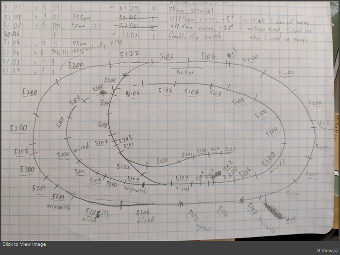

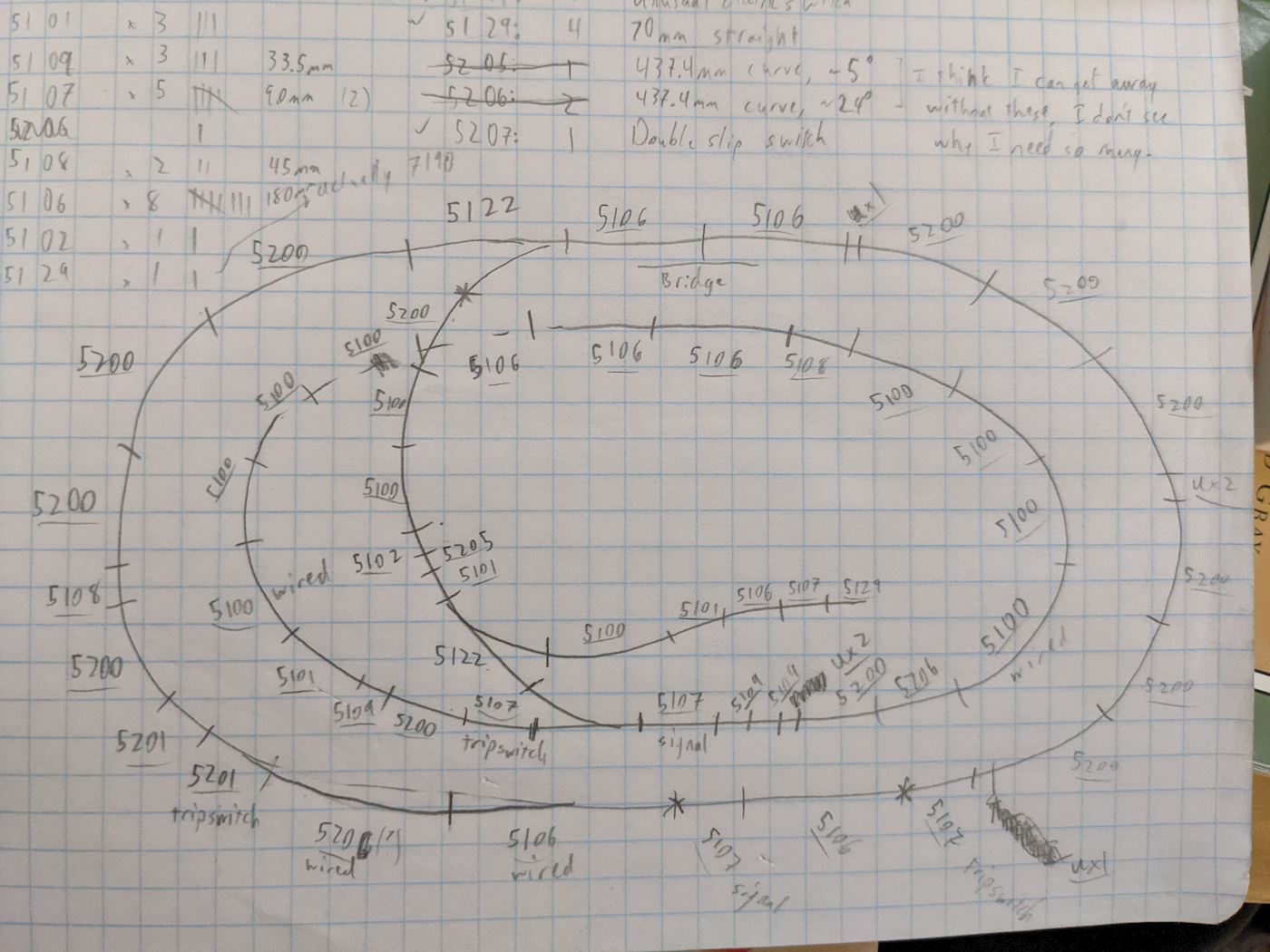

Offline Nate
#6 Posted : 03 December 2020 20:45:10(UTC)
Nate
Joined: 02/12/2020(UTC)
Posts: 5
Location: California, Mountain View
Thanks for the advice everyone!
I audited the layout and compared it to the ones Jimmy Thomson & JohnjeanB found. The track used by my layout is pretty different, but they might be reconcilable if I decided I wanted to mix them.
I noticed that the example layout uses a 5117 switch. Aside from the larger lantern, is it the same as 5202, or an electric 5122? I haven't been able to find any info on either 5117 or 5122.
The image below is my audit, the PDF in JohnjeanB's post lists all of the parts in the other layout on the second page. I have a few 5202s and the my layout has three 5122s.
thanks 1 user liked this useful post by Nate
#7 Posted : 03 December 2020 21:01:08(UTC)
Posts: 3,712
Hi Nate
5202 Switches are R2 and 24.5° while 5117 are R1 and 30° angle.
You may either use your 5202 in combination with 5206 to have 30° or 5117 as you wish.
Enjoy your layout
