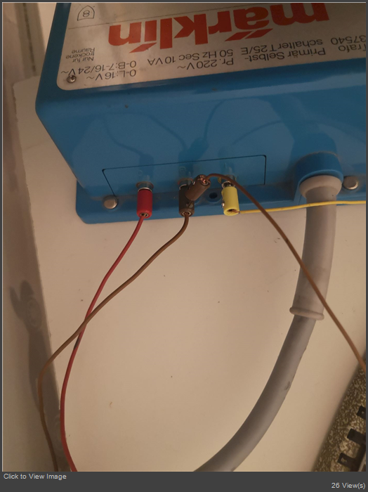

show a picture that shows the wires going into the transformer.
red and brown to track
yellow and brown to light

#8 Posted : 30 November 2020 02:59:34(UTC)
Posts: 3,997
correction: looks incorrect!
Edited by user 30 November 2020 17:01:05(UTC)  | Reason: corrected my answer
#9 Posted : 30 November 2020 06:36:40(UTC)
Posts: 3,595
No, doesnt look correct. "0" should be brown and "B" red?!
#10 Posted : 30 November 2020 15:50:51(UTC)
Posts: 3,997
is the zero on the left ?
certainly if the order is 0 B L it is wrong
#11 Posted : 30 November 2020 16:59:48(UTC)
Posts: 3,997
certainly if the ground (0) and the Bahn (B) wires are switched it would explain why the light gets dimmer when the speed is higher.
I have managed to finally discern the small letters and I think that is the B socket in the middle.
Switch the red and browns sockets and it should work.
