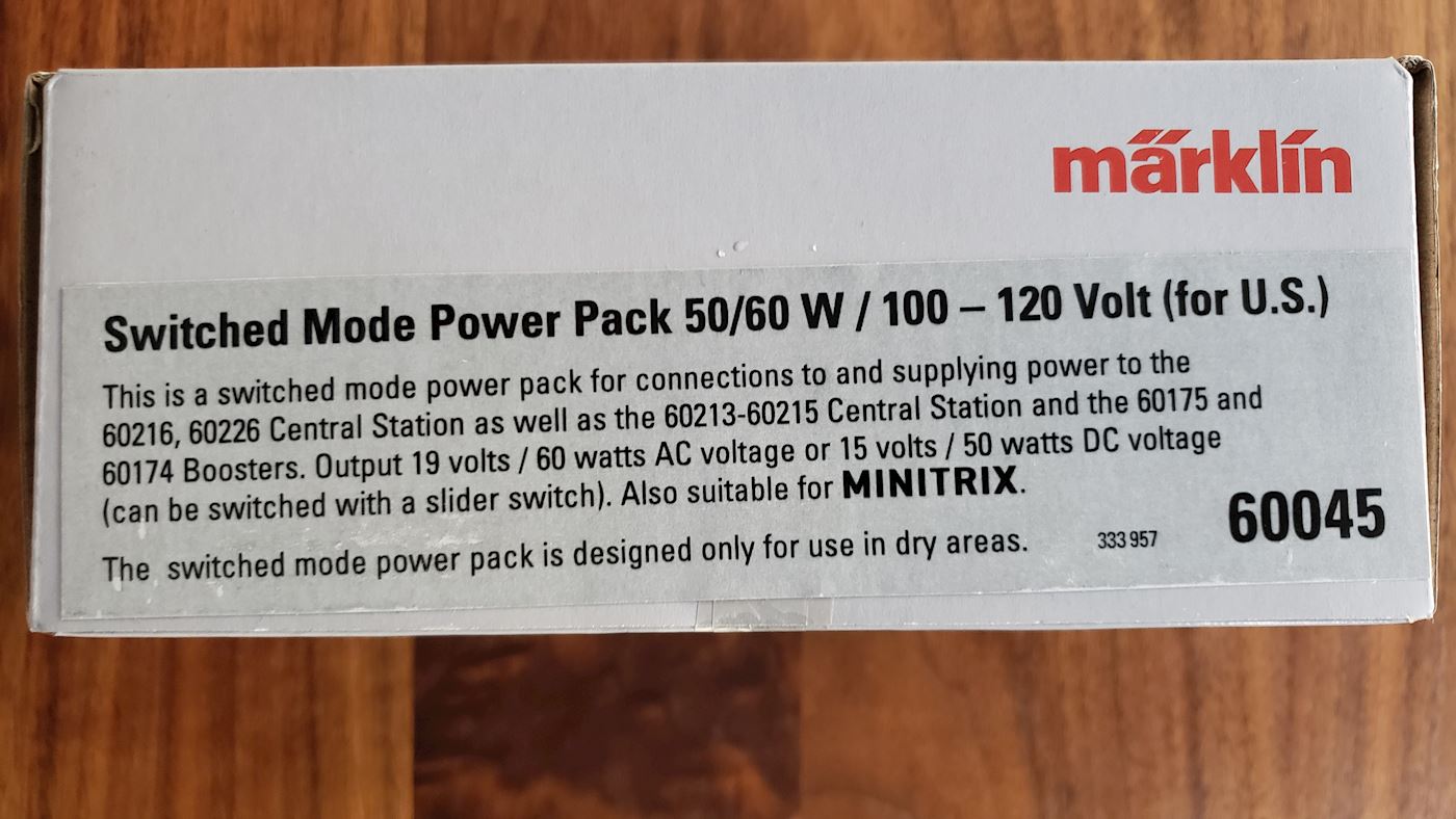

Bought it. The manual says DC but the box English text says AC 19V or DC 15V. It confused everyone.

Offline QQQ1970
#15 Posted : 28 November 2020 20:53:59(UTC)
QQQ1970
Joined: 06/02/2018(UTC)
Posts: 418
Location: Ontario, Toronto
See box pic.

Offline TEEWolf
#17 Posted : 29 November 2020 00:31:53(UTC)
See box pic.
Oh no - thanks for the picture. But it does not surprise Maerklin is printing this text on their boxes too. Is there a text in German as well on this box?
Maerklin is well known about its strange English. E.g. M names the CS central station, although a main train station in a city is normally called central station not a computer. I think the most known one is the Grand Central Station in New York City.
In the German language sometimes you say for a central station "Zentralbahnhof" instead of "Hauptbahnhof". But "zentral" can be translated by the word "central" too, but as far as I know not in connection with a computer. Probably saying for CS "controller station" name this computer much clearer than "central station".

German text makes no mention of AC
#19 Posted : 29 November 2020 02:37:42(UTC)
The text at Maerklin's German website reads as follows:
"Switching power supply unit for connection or supply of the Central Station 60216, 60226 as well as 60213-60215 and the booster 60175 and 60174. Output 19 V/60 W or 15V/50 W DC voltage (switchable by slide switch). Table power supply unit in plastic housing. Fixing straps. Dimensions 116 x 72 x 65 mm. Connection: 4-pin mini DIN high current plug."
Actually, no it doesn't.....But yes it does (sort of).
Note the 2 letters after 'Output 19 V/60 watts'
'AC voltage'!
The German text version however makes no mention of 'AC Voltage'.
#20 Posted : 29 November 2020 10:34:33(UTC)
Thanks and yes, this is what the original version at Märklin's German website is saying too. Did not know Maerklin is doing such bad and wrong information at its English website version and product boxes. It is very bad they cannot even translate their own words.
