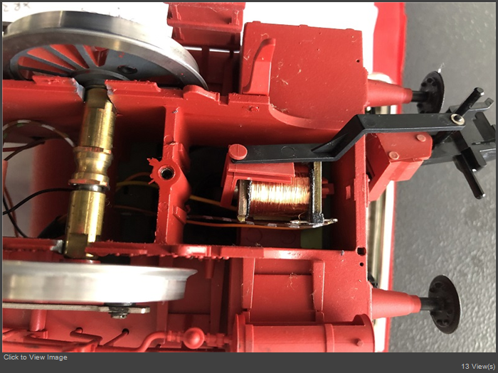

Perhaps more importantly, has anyone used a Loksound XL decoder with a 1 gauge Telex function?
I've tried setting it to coupler but not getting anything, unless I have wired it wrong...

Well I got the Telex working OK after a long struggle.

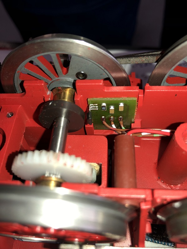

This just leaves the wheel sensor again but removing the wheel plate has exposed the wiring (and a small PCB) so I have more to work with now.
Can anyone identify this sensor and components and the wiring for use with a LS?

Looks like brown/white is input and brown/green is ground (brown/red remains V+) but it still does not work so it is either not a hall sensor or it is damaged.

It's OK I received a response on Stummi forums stating that the hall sensor does not work with a replacement decoder but can be replaced with a TLE4905 which does work.
