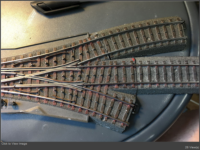

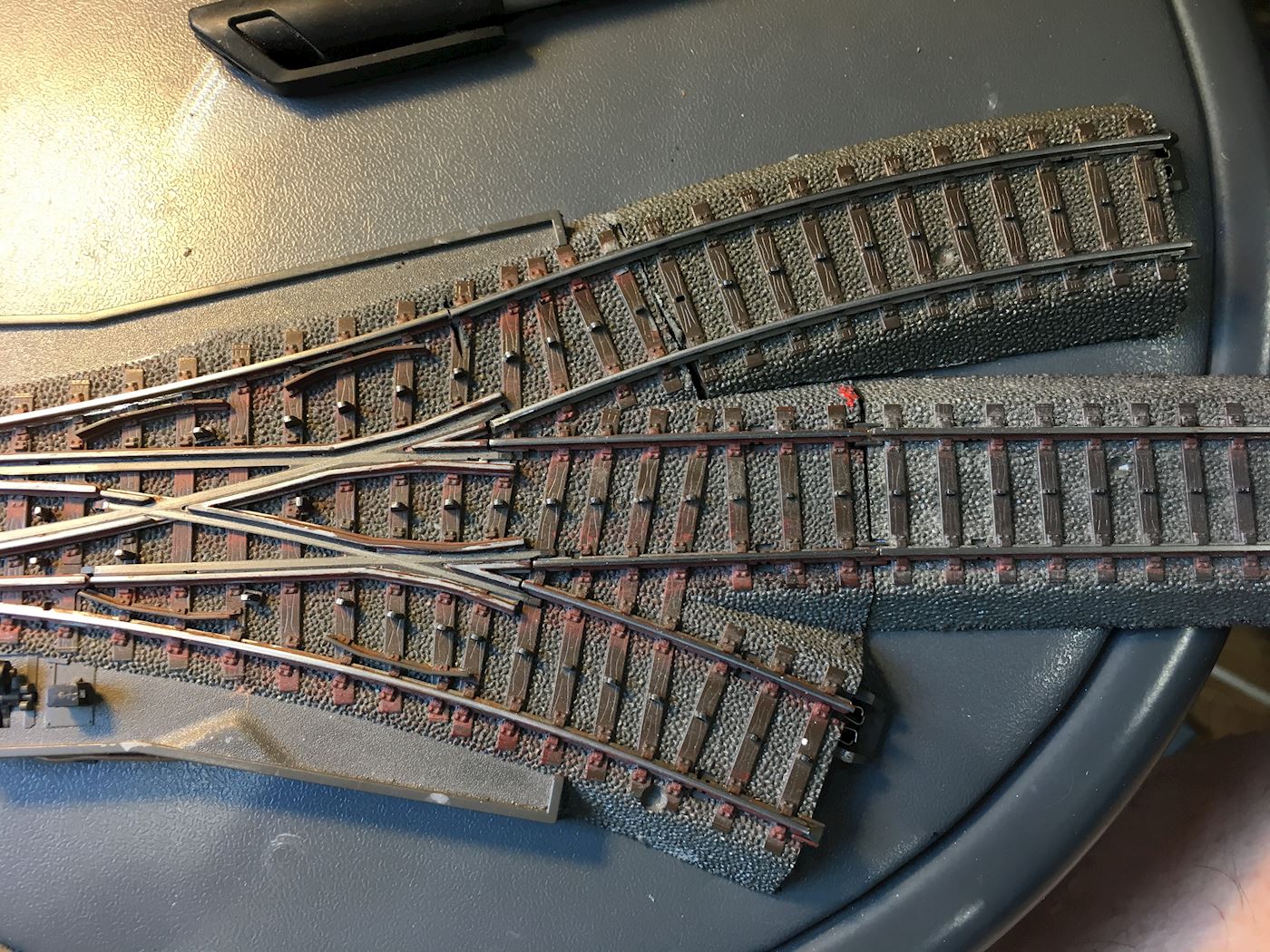

Below is an example with a 3 way switch (I don't recommend this on a M switch though)

They did not but I found how easy it is to cut and assemble track pieces while still keeping the nice "clic" interface
