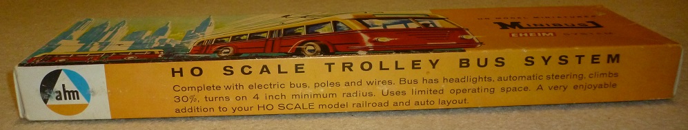

The Trolley Bus was also available under the 'AHM' (Associated Hobby Manufacturers) brand which I seem to recall was associated with Rivarossi for a time?.
Searching by alternate names for the same product can often lead to some unexpected bargains in the market.
Here's my AHM version as a very basic set, I picked it up many years ago but would prefer the AMS version myself without the poles so I can run it on the slot track.
