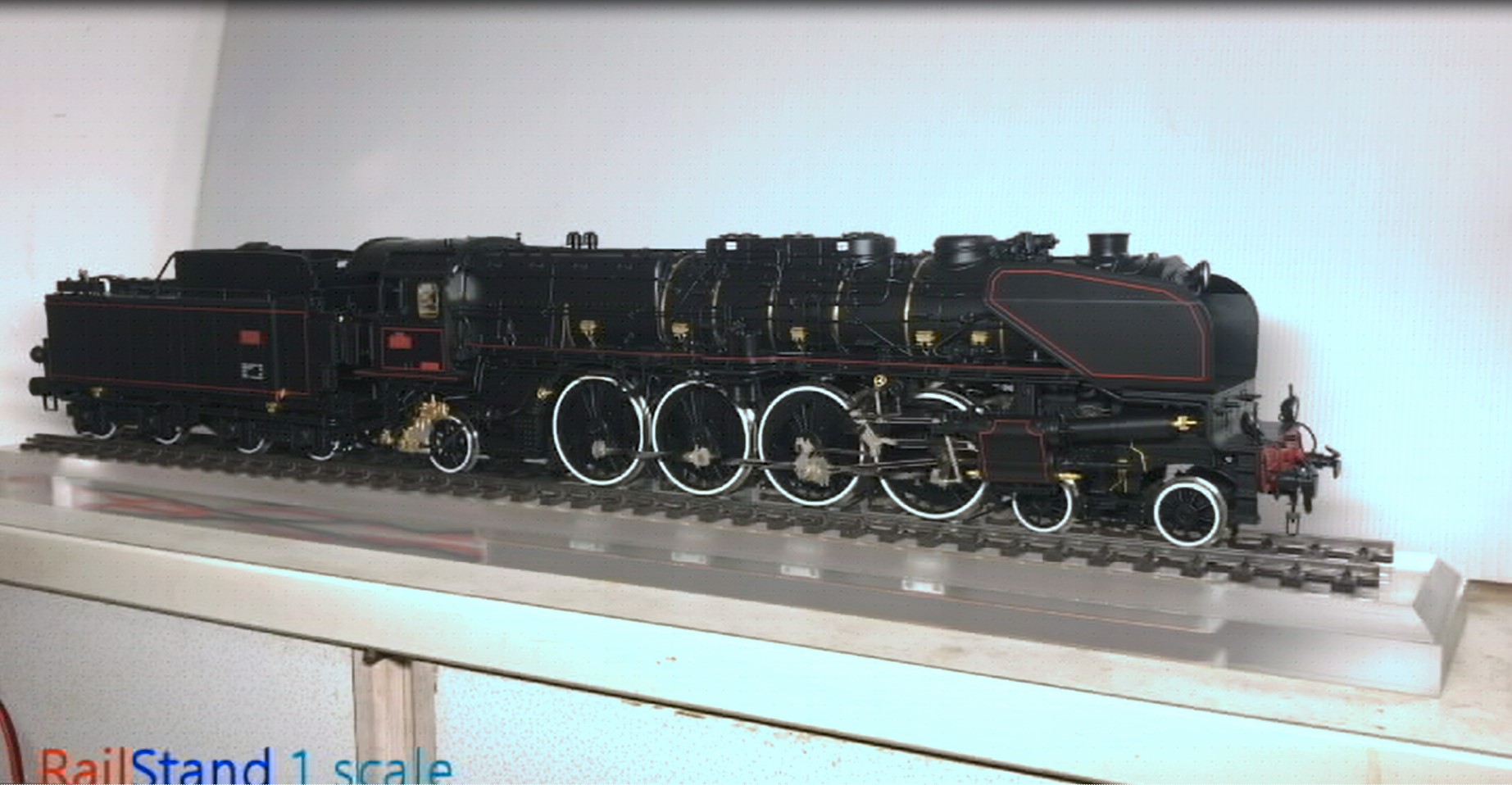

Railstand
This seems to be the “Mercedes” of rail stands, and is priced appropriately. I will be placing an order soon and will report my findings.
By far it’s the most realistic, since the locomotive sits on a real track, and the bearings are recessed and hidden from view (compared to the other offerings). And they use real bearings, so it should not suffer the squealing issues that KPF products do.

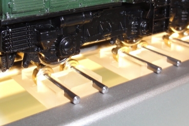

I inherited an SMT test bench.
The design in which the runners on the two sides are adjusted independently is the most stupid thing I have seen in a long time. It makes no sense at all.
To place a loco with (say) 7 axles means you have to adjust 14 runners instead of 7. It is very difficult to get them perfectly set at the same distance.
I would ignore all design that suffer from this flaw in your selection.
Not really, some patience needed of course...
Set one side of rollers correctly, set the other side to approximately the same but don't fasten them, and then it's quite easy to adjust the "other side" by plain feel...
Worth the extra effort since the ball bearings roll nicely and you can speed up to top speed without having the loco escape from the stand...
#11 Posted : 09 October 2020 00:17:47(UTC)
Posts: 3,997
yes, but the process you just described, I call "difficult" precisely because you have do jump through all those hoops. It is not hard to design it so that the opposite side is always at the exact same distance.

Another issue with the KPF-Zeller, which I just discovered, is that it's quite easy for a powerful locomotive to move itself off the rollers inadvertently. This could possibly damage the details like the sand pipes.
Even at the slowest speed, my Marklin SNCF 241-A will move itself off the rollers unless I'm holding it.
I think this is caused by the high coefficient of friction of the rollers -- again, because they are not ball bearings, they not only squeak, they also don't spin very easily. So that allows the locomotive to "push" itself off them!
I fully agree. But, I have learned to use 2 of the "rubber cross pieces" before and after the "roller bearings not", and to re-oil the roller bearings routinely. Your mileage may vary!!!
I am, like others, very cautious of running the big engines without monitoring their performance.
As far as cosmetics go, I think these "test tracks" look the best of all that are available. I have chosen the longest (
available for my I gauge marklin engines. I have two sets of the rails, and 40 plus rollers, and say 90 or so of the rubber stops. I frankly forgot the specific terminology of these parts. I am pleased with their overall performance.
I also bought some of the ho cars, etc from Zeller. I haven't been as adventurous as to try her pasta! Though.
Big daddy gave me the link to her website, and am very pleased to have been a small customer of hers. When I bought the delivery was very swift and well packaged . Things do change with all of our dealers in this hobby.
Thanks be to all, geneDrool
My experience with KPF-Zeller was horrible. I would not recommend working with them. Matthias was initially very nice and helpful. However, when my order shipped it was completely wrong. And I mean nothing was correct.
Instead of apologizing, the woman I dealt with tried to claim it was my fault. Clearly she didn’t speak to Matthias. Anyway, he reluctantly acknowledged the mistake but wanted me to pay for return shipping, which would cost hundreds of dollars.
Sorry for the rant, but they were by far the worst vendor I have dealt with in this hobby, and maybe ever.
Not sure if I dealt with the woman who makes pasta, but I’m guessing it was the same one. She has the absolute worst professional courtesy I have ever encountered. If she puts this disdain for humans into her food, I’ll pass.
I urge you all to steer well clear. Their roller tracks are subpar anyway.
