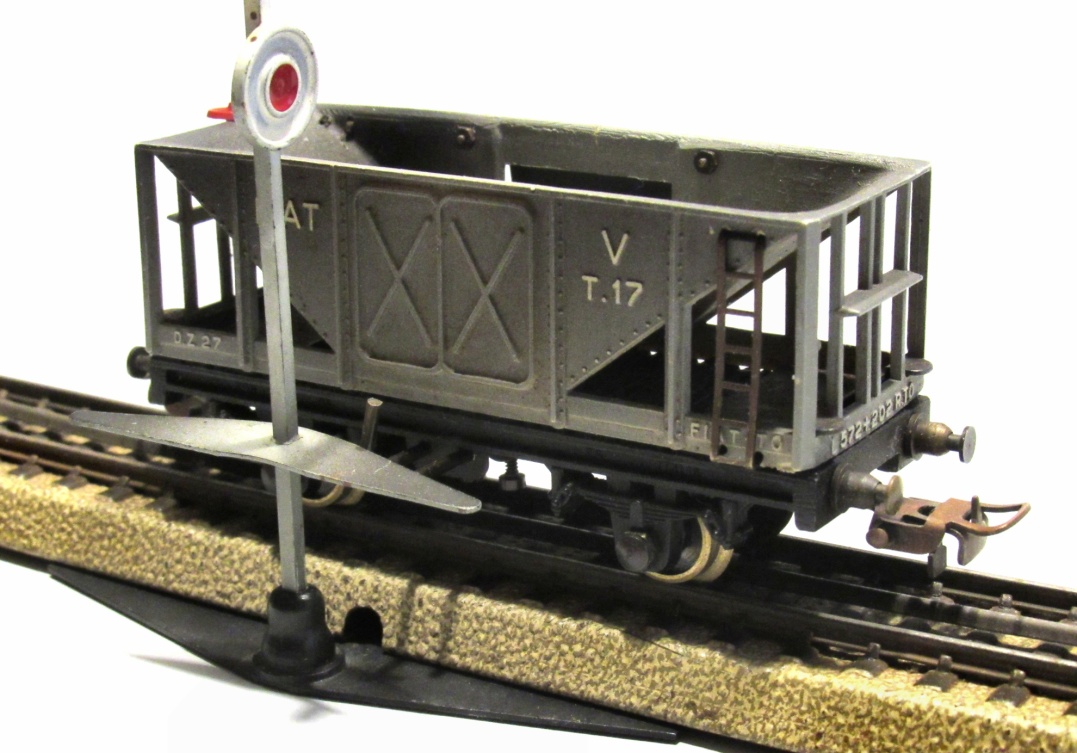

The wagons are activated by a trackside mast with a horizontal tapered section which gradually pushed the lever mounted on the wagon inwards.

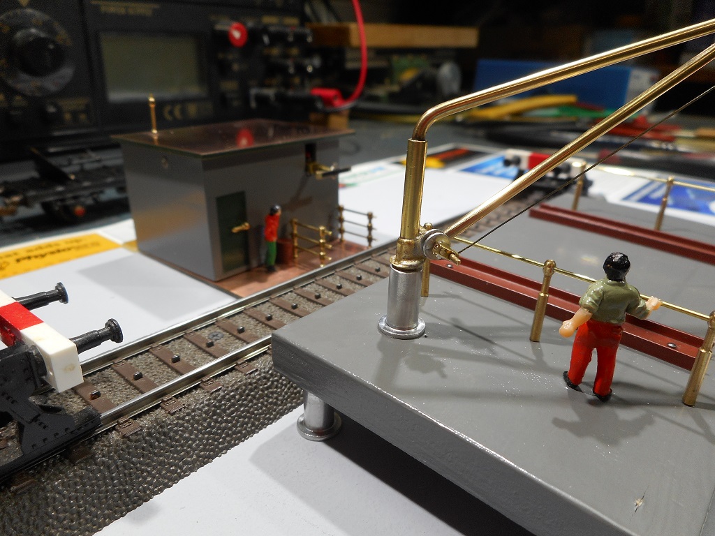

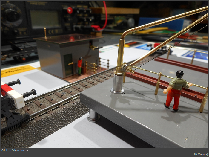

As I wanted to set mine up as a small diorama I had to provide a mechanism to push the lever inwards while the wagon was stationary.
A swinging lever was ruled out as it would move the wagon backwards or forwards rather than activate the mechanism.
The best solution was an operating arm applied at right angles the the side of the wagon.
Some photos of the set up.

Wonderful! As a Pocher fan, you solved a big mystery for me! I have the Fiat coal wagon and always wondered what the levers do. I must dig it and and have a second look now.
All I need is the platform and other cars!
