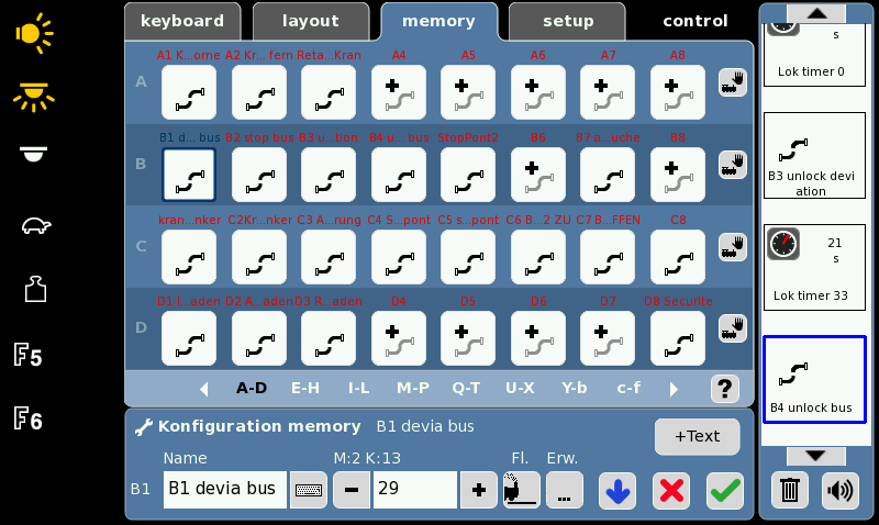

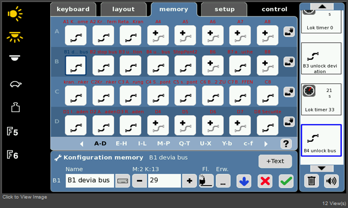

I use a CS2 and regarding the memory tab there is nothing so complicated
Here is the first screen in edit mode (the wrench is pressed):
In this case the itinerary B1 is selected with a name "B1 devia bus"
To the right you see the sequence of events which may be timers, a command or another itinerary.

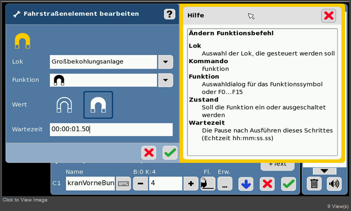

Here is a way to edit those individual commands (you double click on one of them and can set the timing (waiting time)

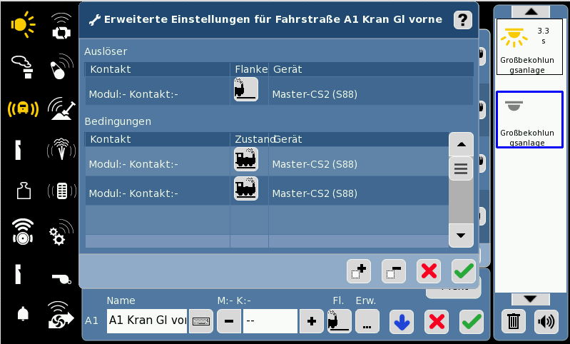

On the screen above, below in the center you see what contact (event) will start the itinerary. Here contact 29: 2nd M88, contact 13
On the cell to the right, there is a loco approaching: this means that CLOSING the contact will trigger the itinerary.
The next cell right (Erw.) means the full triggering screen allows you to add a condition to the triggering. Here is the screen you get to when pressing "Erw"
In this screen the first line is to describe the TRIGGERING signal: the module#, the contact#, the triggering moment (here when occupied) and the group of sensors (here those connected to the main CS2)
The second and third lines are for OPTIONAL conditions (contact statuses) to be satisfied for the triggering to take place
