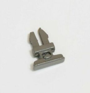

And the actual piece that hits the lantern is the break magnet ("Widerstrom bremse"). Click here for picture
Well, decided that no breaks are required on my layout for this train BigGrin
That the standard R1 bridges don't work is a bigger issue that will need some tinkering.
And yes is is due to the length and the positions of the bogies at the very end that this occurs. Thanks for confirming that dominator.

Leave the break magnets off when running then. They can get knocked off anyway. Put them back on when you stow it away or have it as an ornament. I have had to remove items from or modify various locos and carriages to make them work on my layout. You wont notice the lack of the magnet.

These little things are part of the Swiss Integra saftey system, nothing which breaks the train mechanically like electric magnetic breaks which e.g. trams have.. It is not a break magnet.
