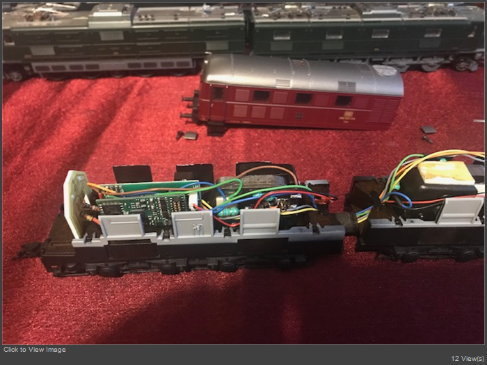

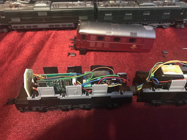

I have the Ae 8/14 and also the V188 in both cases I have converted them using Marklin MDL/3 decoders. They can handle perfectly well the two motors and now the sounds comming from M[arklin Data base are just amazing.
I will take some photos. And will share here. For the Ae 8/14 there are two ways to do the job, you can replace the original electronic plate and use the solution plate from Lussy (a Swiss shop) it solve the resistor need for leds and converts the loco in a plug a play with any decoder (more expensive solution but gives to you a better estetical view or you can work a little bit more using the 21 pin adapter that comes in the MSD/3 and you solve the led problem using some resistors.

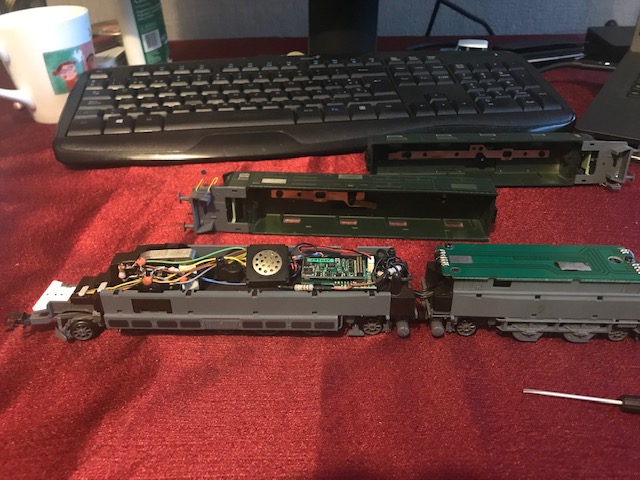

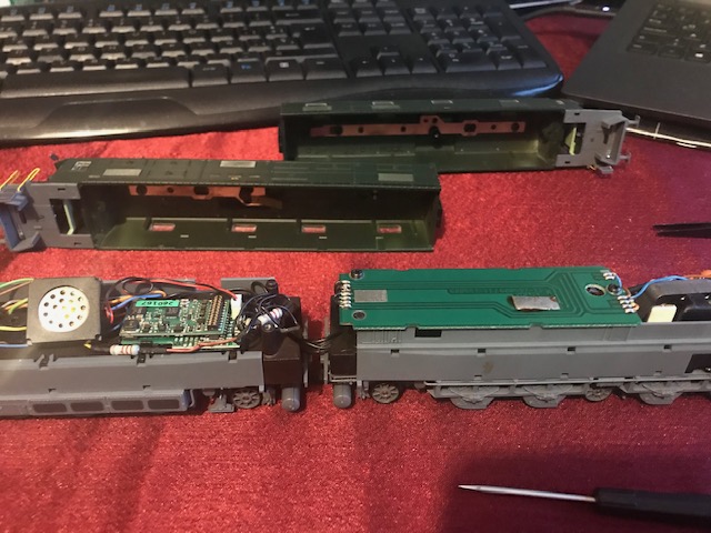

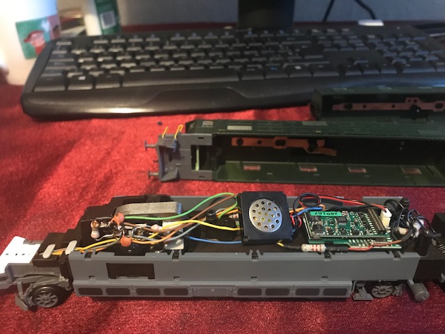

Here is an update on my Ae8/14.
It took a while before they were sent, but I received the PCBs with from luessi.ch to change the decoder. I got the 8051mtc version and I also ordered LED boards to replace the original yellow LEDs. One remark, the 8051mtc is actually designed to work together with the original LEDs, not so much with the new LED boards. For the new LED board, if you want to use the red LED you need seperate function outputs for the white LEDs, to be able to disable them. You also need to modify the original PCB (replace some resistors with 0R and remove the diodes). I digitized the loco using a Lokpilot5 MKL. The "MKL" has amplified outputs on AUX3/4 so that they can be used for the LEDs. I connected the front lights to F0 f/r, the single white rear leds to aux3/4 and the red leds to aux1/2. With some function mapping you can then program them as required. The AUX3/4 are not made available on the PCB on seperate pads sadly, so you have to solder to the mtc21 pins.
To note, with the new LEDs there is some light leakage when the single rear LED is on. This can be fixed by cutting a piece of the light conductor, I removed about 1cm in the middle, and the light leakage is gone. You can easily remove it before cutting.
As for motor control, it is much better now, no more speeding up on descents or slowing down on climbs. Currently I am still using the default profile for 5* motors, but I will try to get the behaviour even better. If you have any tips for motor parameters for a Lokpilot 5 driving 2 motors, please put them here.
