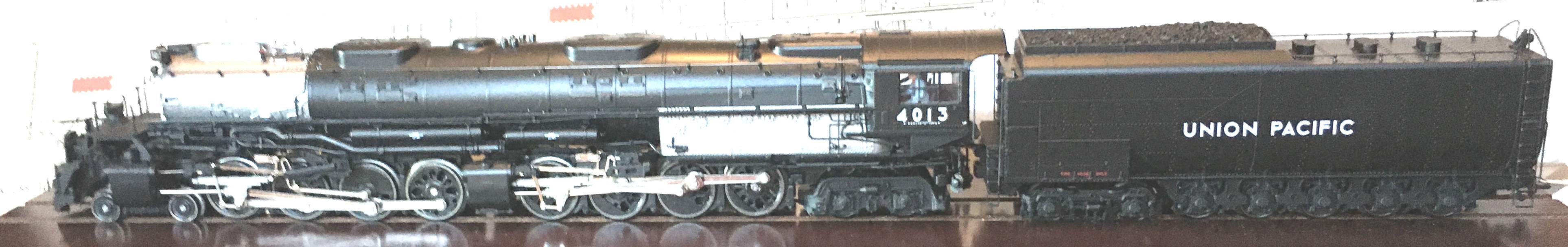

The Big Boy in the set 29848 has a 4013 road number and only one Sound function
Another one is the Delta Version also with a 4013 road number, no Sound
The last one (I have it) is also with a 4013 road number. It is the insider version 37990. A separate sound decoder is in the tender with 4 sound signals activated with a separate address. Running sound is made using a Hall transistor to sync with wheels. 2 different whistle sound and a Bell sound complete the sounds
This is to say that sometimes Märklin re-uses the same road number with different electronic features or accessories

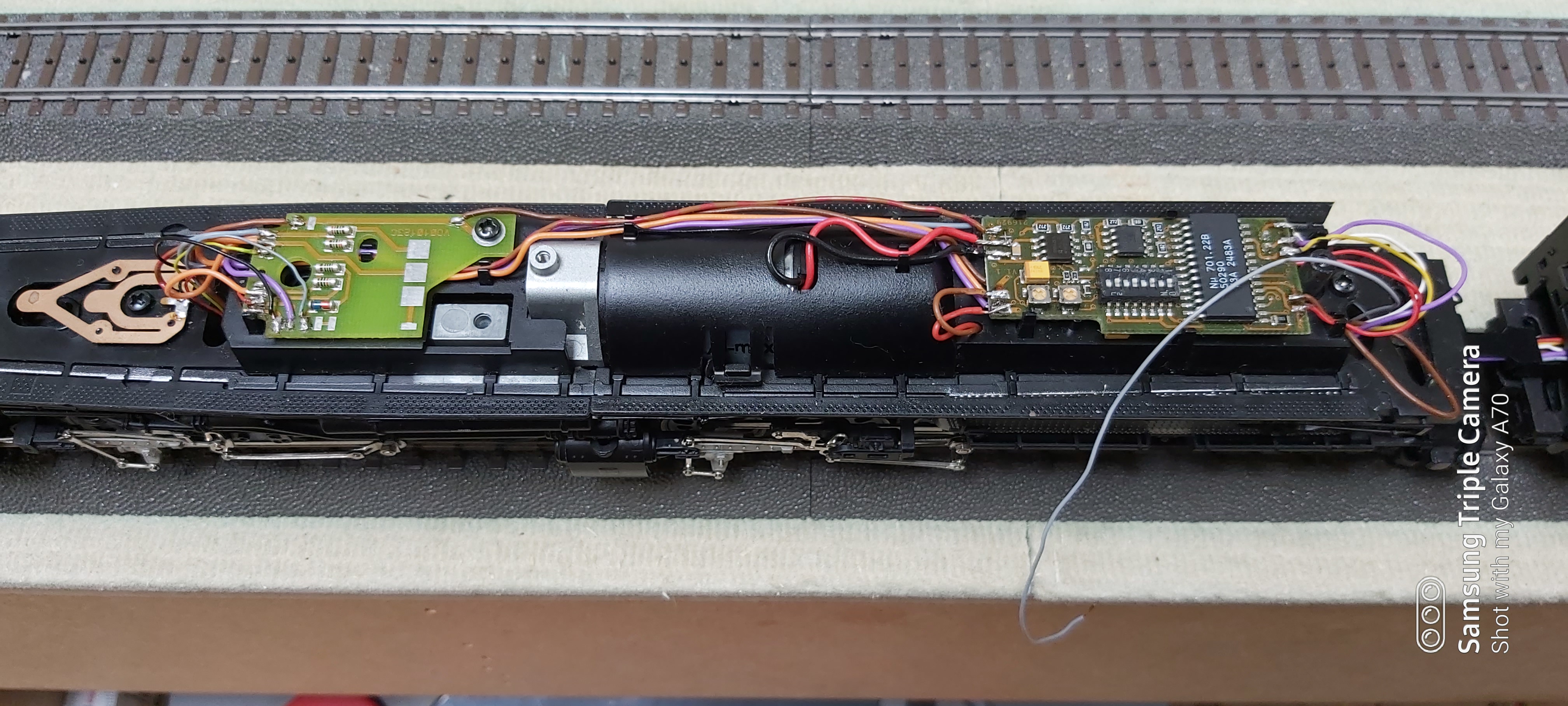

OMG after all of that, you picked the only locomotive that I have upgraded with a new sound decoder! I'm sorry but I don't have the original decoder on this one.
From what I see that is left of the original wiring is that there are 2 grey wires going to the lighting board. One is for the cab light and the other is for the number board light.
Rick

In haste, here are two pics of my 4015:
Good luck!
Jeroen

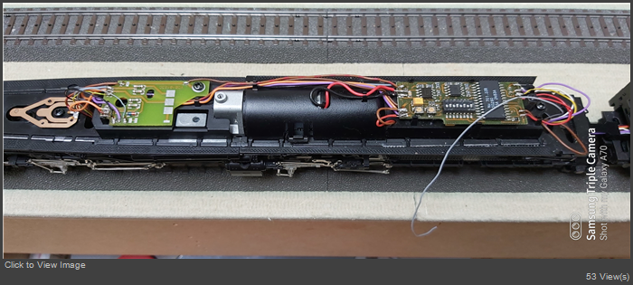

Offline johnmarklin
#9 Posted : 31 August 2020 19:51:42(UTC)
johnmarklin
Ireland
Joined: 31/03/2011(UTC)
Posts: 174
Location: Ireland
Thank you Rick and Jeroen for the images.
Rick, your loco looks the same as mine except my loco does not have a wire soldered to the pad adjacent the three tabs that the boiler springs press on. Jeroen your image is most like mine but the grey wire that I refer to is not shown.
If you look at my second image it shows the decoder in the tender. On that decoder are two solder tabs stuck to an IC. On one solder tab there are two red wires soldered, one going to the board and the other connected to the decoder in the boiler. The second solder tab has two grey wires, one going to the board and the other going to the locomotive but where should it be soldered to? there are no free solder pads. It is a puzzle
Any ideas?

Offline jerdenberg
#11 Posted : 31 August 2020 22:50:19(UTC)
jerdenberg
Joined: 10/01/2005(UTC)
Posts: 1,028

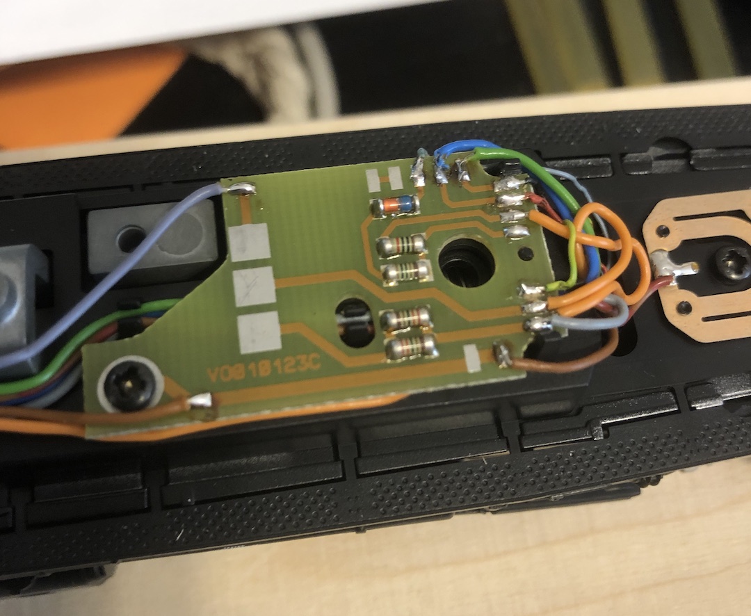

Hi John,
With my 4015, the grey wire is in the lowermost bundle-of-three going to the tender (it emerges from under the main decoder) and it would seem it comes from the board at the front? If you find that helpful I can check if that is really the case.
Jeroen

It would be very helpful if you could find where on the front board it is soldered to.

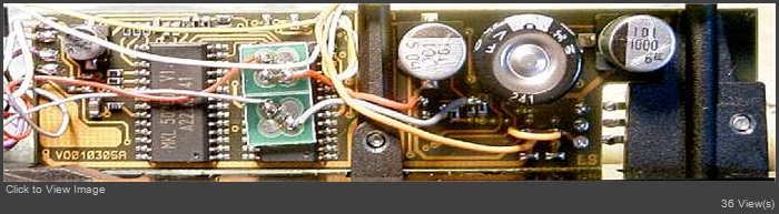

Offline Alberto Pedrini
#13 Posted : 01 September 2020 12:11:08(UTC)
Alberto Pedrini
Joined: 02/07/2004(UTC)
Posts: 1,454
Location: Italy

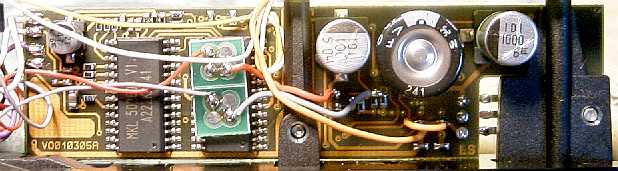

The first model of Big Boy had a poor sound, the ciuff ciuff was piloted by a camme (two of the four wires that go in the front) that after some years, used or not, have problems.
I have replaced the decoder with a locksound, that work without camme.
Open a close the model is very difficult, but not impossible.
I have a topic in italian that you can translate by google, if you want have a look:
http://www.marklinfan.co.../topic.asp?TOPIC_ID=4326
Alberto

Offline jerdenberg
#14 Posted : 01 September 2020 14:07:53(UTC)
jerdenberg
Posts: 1,028
Hi John,
As I saw in the manual that the main decoder has to be tilted in order to get to one of the lubrication points of the transmission, I gathered that would be simple – it wasn't. Due to all the wires connected to it I could not tilt it upright; I had to shift it around a bit to reach the lubrication hole. This issue also made it impossible to make a decent picture of the bottom of the decoder; the best I was able to do was to focus on the side of the board with the relevant connections to bottom soldering pads:
As you can see, the grey and red wires that enter from the tender and vanish under the board are soldered to pads on the bottom of the board, as is the grey wire that leads to the contacts for the number boards (the red wire for the number boards is soldered to a pad on top of the board). The grey and red wires to the tender are connected to a board in the tender that serves the back-up light.
Hope this helps.
Jeroen

Offline johnmarklin
#16 Posted : 02 September 2020 00:03:59(UTC)
johnmarklin
Ireland
Posts: 174
Location: Ireland
Alberto,
Thank you for for your reply. Your images show the way my locomotive was when I got it. I think the sound unit on mine is damaged as I cant get any sound from it now. It looks as if a power transistor has been damaged on the sound module. The ESU sound definitely sound better.
Jeroen,
Thank you for the image. it will be useful to me. As far as I remember there are no wires soldered to the underside of the board on my loco. As I mentioned to Alberto I think the sound module was damaged when I got the locomotive. I cannot get it to make any sounds even though it made the long horn sound which is not a sound for this locomotive when I placed it on the track for the first time. It never made any other sound. It has me puzzled. A replacement sound module is impossible to get now. I will check my locomotive tomorrow and report back.

The image is a great help. I have been able to remove the decoder on my locomotive but have not soldered the wire yet. Hot water system at home needed attention and takes priority. I hope to do the soldering tomorrow evening.
