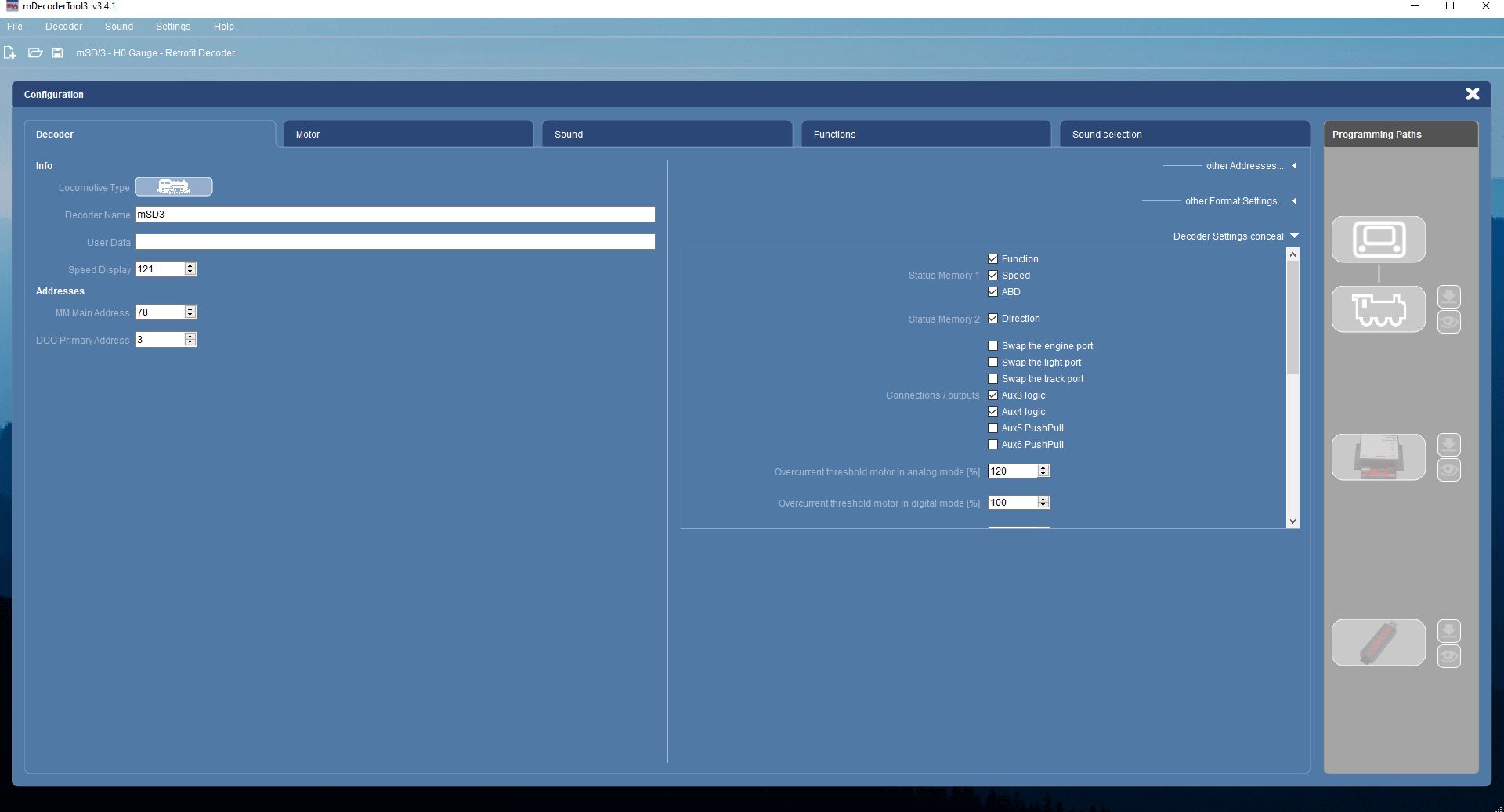

The MSD/3's Aux3 and Aux4 can be configured to be either logical (so it can control a transistor) or amplified (so they can be connected to a led, a telex, a smoke generator ….)
From the factory the settings for them are amplified.
When programming the decoder, you need to specify that they are logical:
Then you need to add a special function - always. This is then configured to control aux3 forward and aux4 backward.
The enginetype needs to be set to sinus.
Leif
