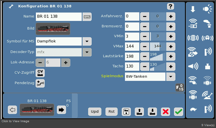

Like Dave writes, if there are no issues with the lubrication, brushes, then it is a matter of adjusting the max speed parameter on your MFX loco.
Using a controller such as a CS2 it is on a screen like this one below. See the V Max parameter.
The manual is here https://static.maerklin....2745b9401e1434542570.pdf
On page 22 you have the list of CVs (configuration variables)
You may:
- reset the loco to factory setting by writing 08 on CV8
- set the max speed by writing the speed (1 to 255) into CV5
I hope this helps

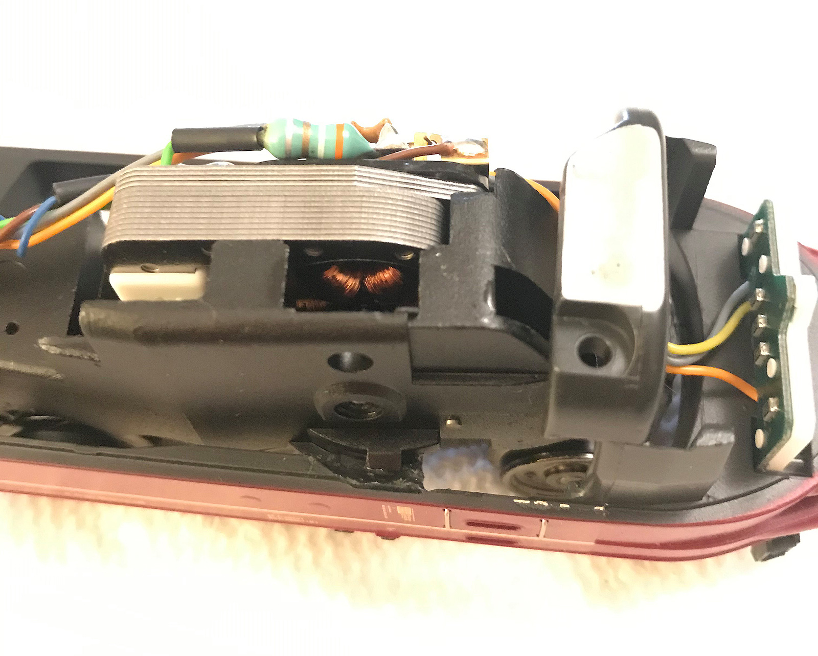

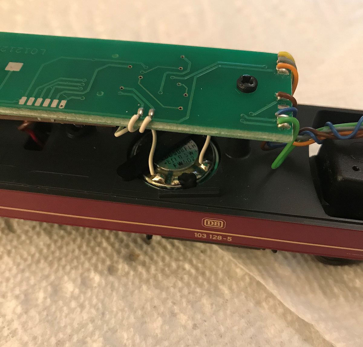

Ok reset the loco several times , no change
opened up the shell, the motor looks good, nothing obvious at least. this locomotive has been run less than 10 hours since I bought it. you can see the pics below
this video shows how slow it is compared to the SBB Re6/6
and loco running by itself, notice how slow it runs even with speed set to almost 50% range
is this normal or is it bad?
