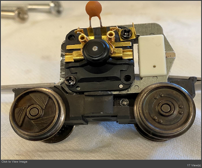

(4) I then decided to remove the bogie to see if Marklin was right about the 60941 fitting which it did, however the mounting screws did not line up so I drilled and tapped 2 new holes opposite the originals. (See photo)

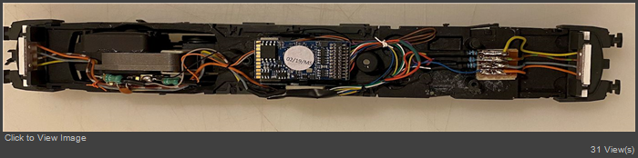

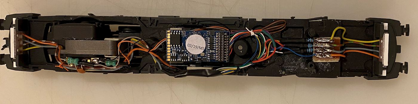

Hi thought i would update you on progress of fitting a full sound decoder in my Porsche l82 locomotive. I purchased a Loksound 5 DCC/MM/SX/M4 21MTC decoder along with the Adaptor board 21 MTC an d i had a good friend fit it as i was very dubious about fitting the decoder my self because of the complex lighting the locomotive has. He made a marvellous job of fitting the decoder looks real professoinal Regards
