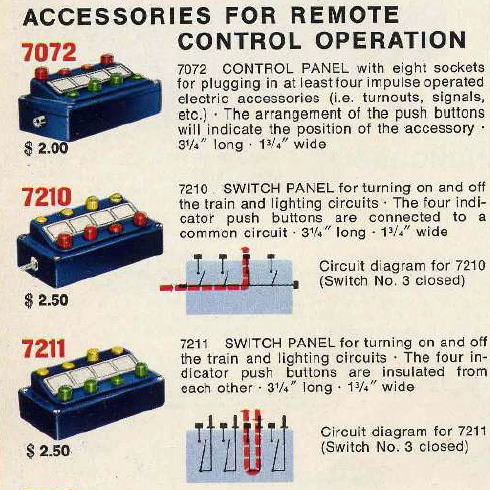

I did notice it needs a 7211 box which I guess is for the circuit separation of the trains? Not sure yet how these work. Are they mere on/off switches?
thanks
#7 Posted : 11 July 2020 22:30:29(UTC)
Posts: 3,630
Hi Carlos
7211 boxes are a group of 4 independent switches (no common pole) packed in a blue control-room-like buttons. They are perfect for powering branch lines
The 7210 boxes are very similar to the 7211, the only difference is that all switches are all connected a a same common pole.

Thanks!
$2,50.. lol
