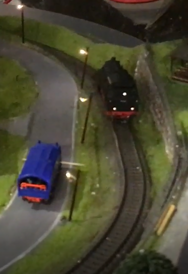

Using those inexpensive white LEDs for Chritsmas, cotton swabs and enameled copper wire (e.g.: from a disposed Switch motor) I did rural lamp posts
It looks like this (not great but not too bad for less than 1 Euro apiece
They are powered by 12 VDC with 2 lamps in series
thanks 6 users liked this useful post by JohnjeanB
