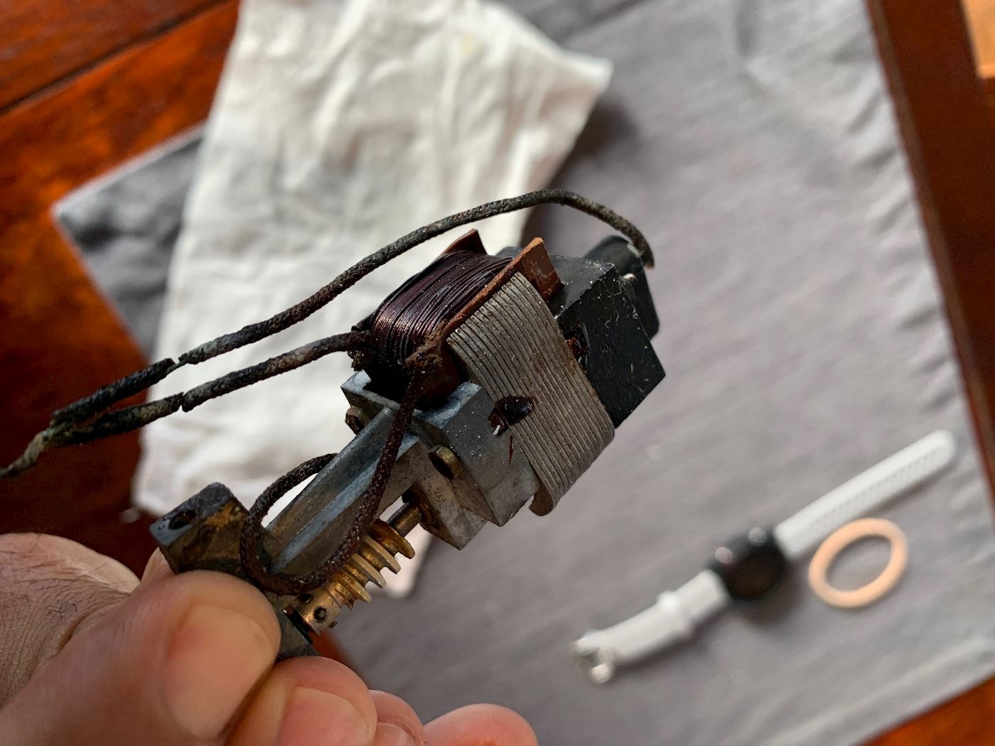

In a random way, I came across a beautiful vintage SNCF 231 type steam locomotive, made in the 1950s by a brand names "Antal" The locomotive was in very bad shape, but I've done a major cleaning and the most important thing is that the train is almost 100% complete. The problem is somebody in America bought the engine, and rigged it for standard DC two rail pickup.
Factory it was 3 rail, although the center shoe is long gone. I have now gotten to the motor, but while I thought it was 3 rail DC, it has a coil. Can anyone tell if this is AC or DC? Naturally I don't want to test it with the wrong current.
Thanks in advance for any tips! Also where to put test leads?

Thanks Kimball. The 3rd rail is gone on my locomotive, as is/were something "under the hood". I suspect this was due to an American DC modeller converting it to a 2 rail setup. That white wire is clearly not factory, and the center pickup is gone.
What I'm trying to sort is whether the motor is AC or DC, so I can test and then bring it back to life accordingly. I'm fairly sure a Marklin analogue reverse unit would be an easy retrofit if it is AC, or a digital decoder (just for control and reversing) if it is DC. Looking underneath I think the addition of a Marklin pickup shoe/ski will not be difficult.
Reality dictates I will rarely (if ever) run it, but I would like to bring the engine back to running order. Ideally in 3 rail AC trim, but even 2 rail DC is fine.
I found this low-resolution schematic, but it appears my missing electronic component is a partial key to the solution. (and for sure never to be found, so a Marklin E unit or a decoder is the answer) Also, my engine does not have a headlight so it may be different

I suspect it will turn out to be an AC motor. I think a DC motor needs a permanent magnet.
#5 Posted : 19 May 2020 22:21:11(UTC)
Posts: 3,687
I agree with Dale, your loco is definitely an AC current locomotive

#7 Posted : 20 May 2020 01:49:38(UTC)
Posts: 4,044
The original Märklin 6080 decoder works with AC motors and I believe that the 60906 decoder does too.

Before adding a relay (what type?) I suggest to verify that the inductor winding is double (like Märklin's). If it is then a regular Märklin relay is OK
On the drawing you displayed above (alas difficult to read) there seems to be a selenium rectifier just left and slightly above the motor (I am really not sure) for the 20 VDC version.
The drawing was provided with kits as an alternative to finished products.
#11 Posted : 20 May 2020 19:29:38(UTC)
Posts: 3,043
Thanks everyone! So last night I did not manage reassembly, but I did test the motor on a Marklin transformer after a little more cleaning. It ran quite well, but REALLY hot. Actually hot enough to cause concern. I have to sort out how to pull the engine apart without destroying anything, but tonight's project will be the brushes and armature to see how bad (or not) they are, and then another test after cleaning. Hopefully that tunes it and tempers the heat situation.
From there I will give the pickup slider project a go, as some fabrication will be needed.
JohnJean- agreed the diagram is likely a DC locomotive. Mine has what appears to be a double winding, but I may try the digital chip out so I have either option.
Images to follow later, sorry to keep teasing...

Of course temperature needs monitoring, but in those days the motors were not high efficiency.
On a recent Märklin loco I have a can motor which needs replacing because it rings 10 Ohms and 900 mA at full speed when it should be 65 Ohms and 150 mA
In your case make sure the motor is mounted in series (inductor and rotor)

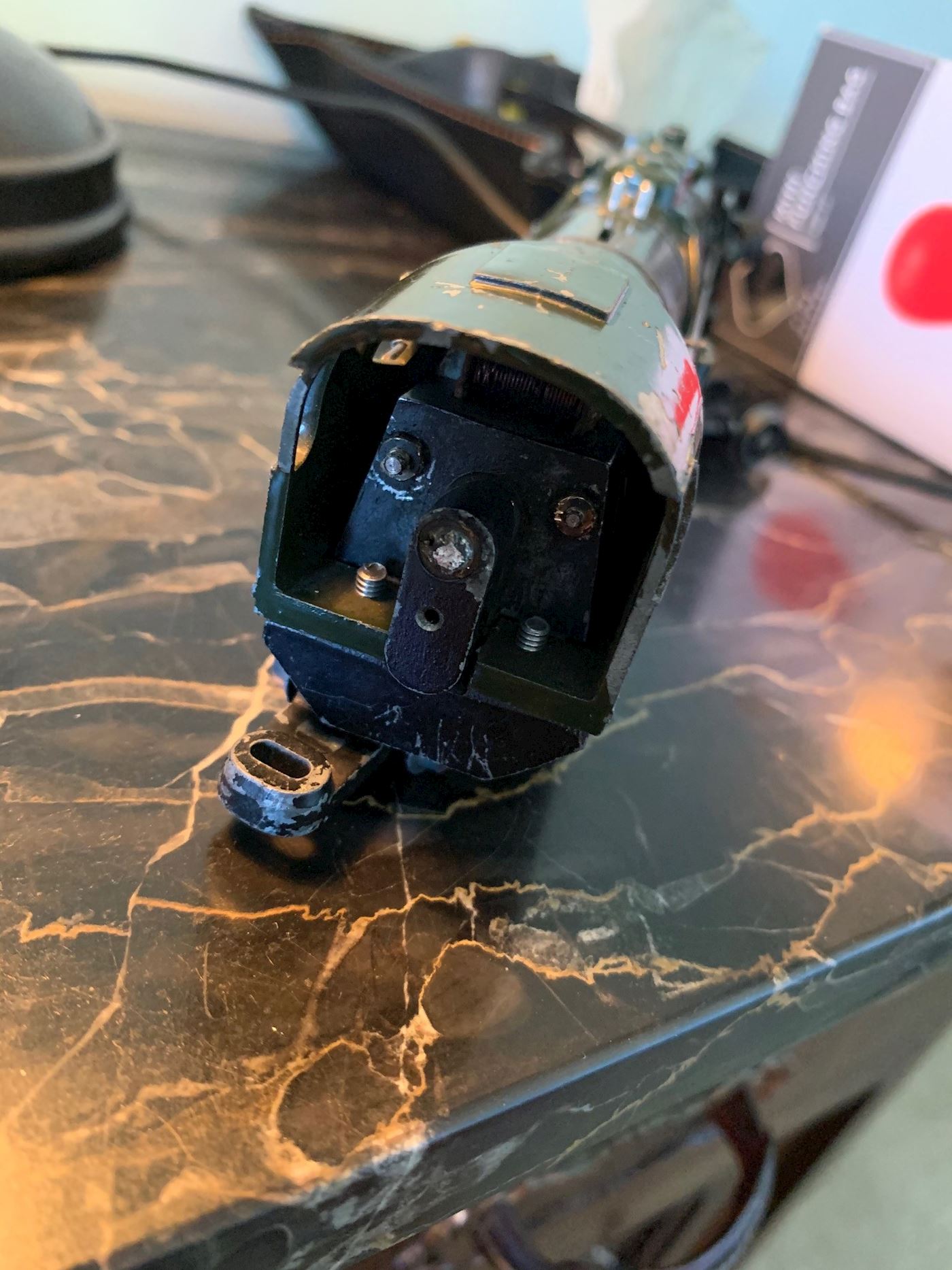

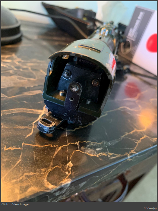

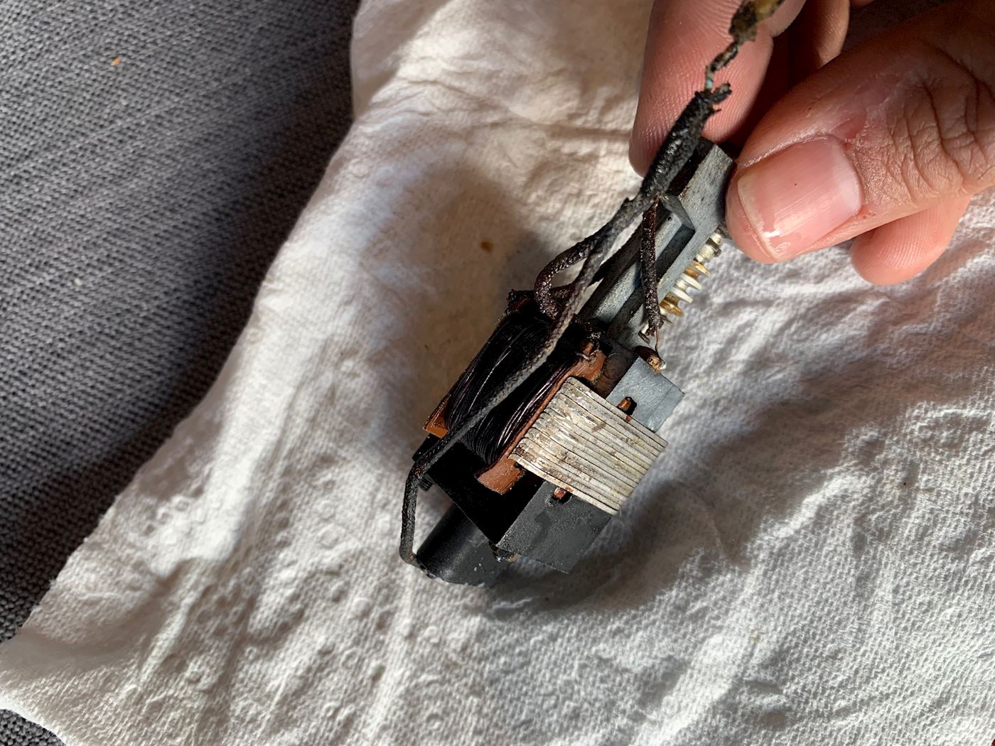

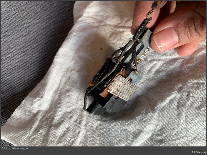

#13 Posted : 21 May 2020 05:48:13(UTC)
Posts: 3,043
Here are a few photos of our troublemaker, which I'm pleased to report I'd sorted all the hardware on. It came to me with kadee couplers, missing parts and other headaches. I removed all of the "bad", made a tender drawbar piece from some metal bar, fabricated a mount and marklin coupler to the tender, and of course a big cleaning etc...
I need to sort how I'm mounting a pickup shoe next- the marklin 7175 is just a few mm too long on either side, so I need to find a creative solution for either the pickup, or the two screws in the way on either end which will short the loco out.
Then of course, the electronics. I did not have luck with the cleaning experiment. I did a big clean, but the heat persisted and now it may have shorted or something. It needs some vetting, but I'm hoping i can be solved.
For now, enjoy the pics!

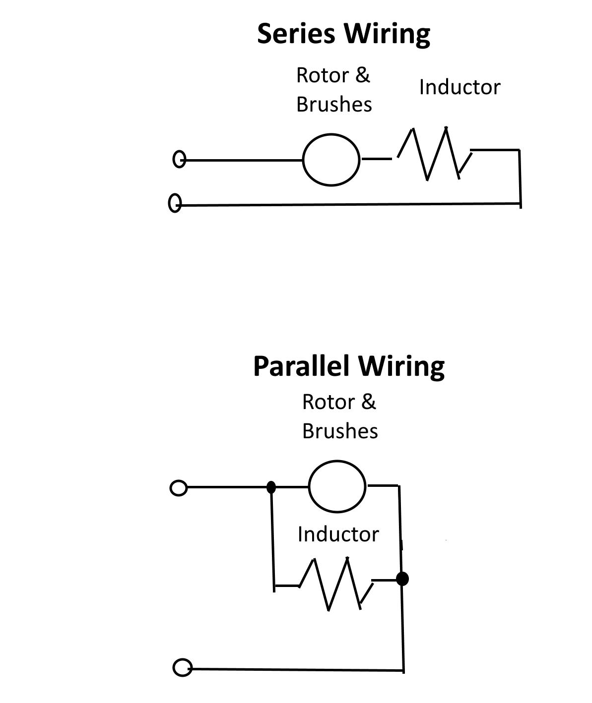

Hi Jean,I'm trying to learn some electrics concerning models,please explain how I
would do the above.
Many thanks
Warm regards
Jay
#15 Posted : 21 May 2020 14:15:37(UTC)
Posts: 3,687
Hi Jay
Series motor means that one of the brushes (both connected to the rotor) is connected to the inductor (one widing of the large fixed coil) in a way to have the same current but split the overall voltage (rotor voltage+ inductor voltage = track voltage).
Parallel motor means that both the brushes and the inductor receive each the full track voltage and the resulting overall current is the sum of collector current and inductor current.
The result is that the same motor connected in series will have a reduced current and power dissipation compared to the same motor in parallel arrangement.
All toy train motors (except DC motors with a magnet) that I know are in cabled in series (Märklin, JEP, ..).

Hi Jean,thank you so much for the simple and understandable description of series and parallel wiring of model train motors.
The diagrams helped greatly in understanding the Logic. Much appreciated
Warm regards

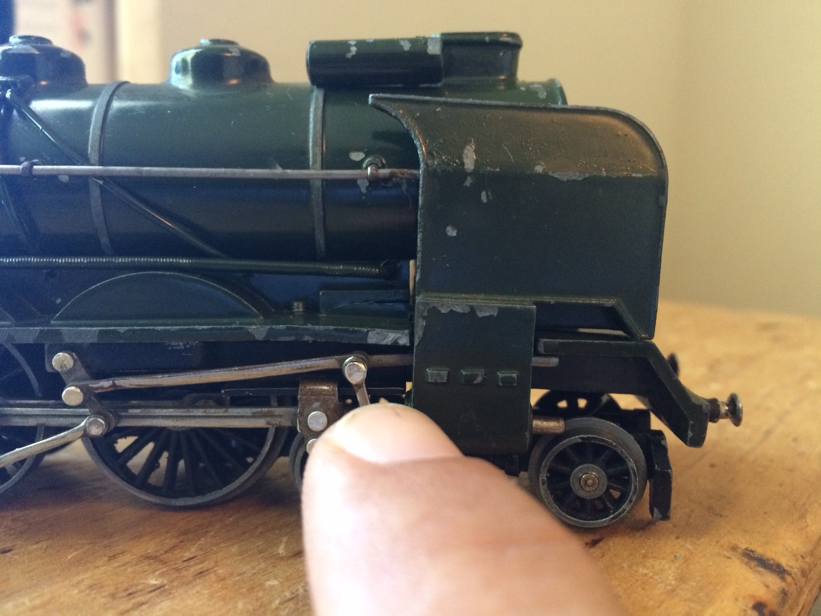

#18 Posted : 22 May 2020 11:00:01(UTC)
Posts: 6,805
Hi John,
Here is a picture of the Märklin style slider on one engine. (Same engine as my previous photo).
I bid on this engine about 8 years ago, but missed out.
But I kept pictures.
#19 Posted : 23 May 2020 19:30:09(UTC)
Posts: 3,043
Hi- very interesting Kimball. Your image at the top struck me as odd, but I didn't give it further thought. Seeing this second image confirmed the "odd"
I think the locomotive you posted was either a different generation/model, or has been retrofitted with what appears to be a marklin drivetrain/motor. An image of my motor is below. (one wire is missing from that block center and it is currently a test assembly)
Your image does show a few things of use. The front truck has a lower profile screw than factory to clear the pickup shoe. Studying on my side has revealed the fact I may have a bent front chassis. The pilot truck was not sitting right, the quick fix was loosening a fastener so it sat flat on the rails, but now i found the cause is a bent front of the loco. (note the bend "forwards" in the second image on on the smoke deflectors and chassis where the upper valtrain mounts) This could be the kiss of death for the locomotive if I can't fix it.
Looking at the rear of the locomotive in your image, that is a different trailing truck. perhaps Marklin, or a later version as well.
My next moves are attempting a front end fix, and if I am successful I'll approach motor situation.
