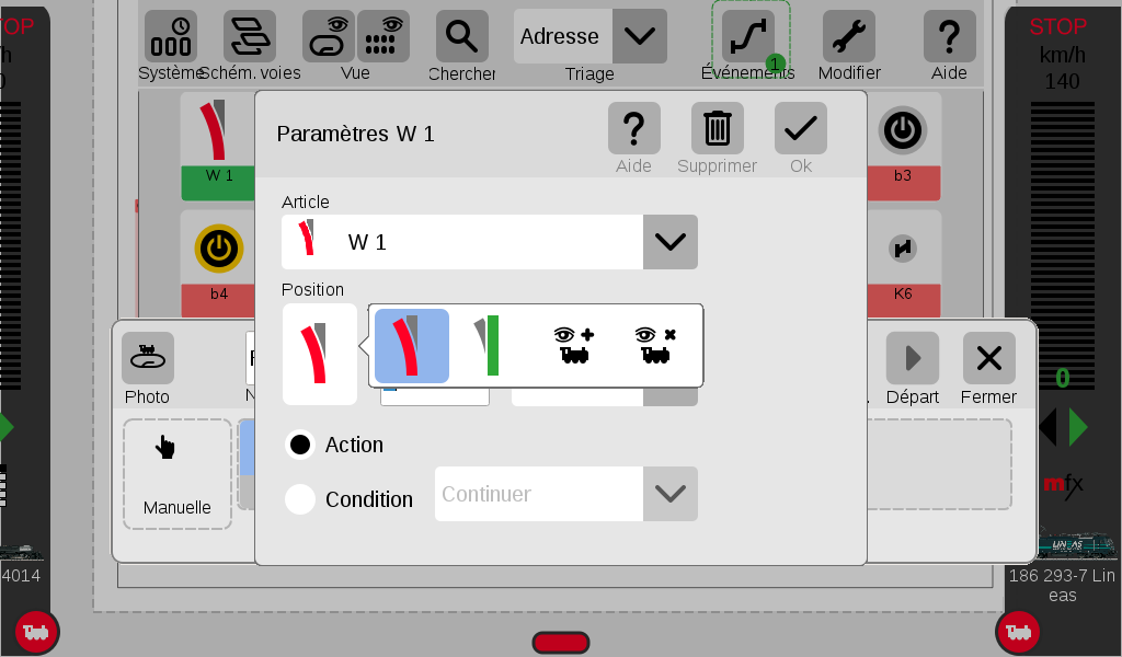

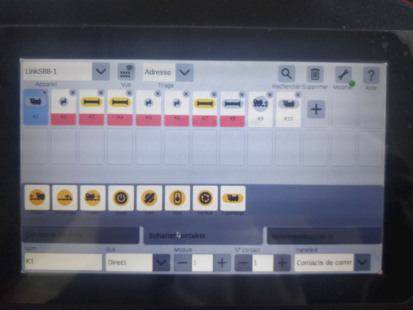

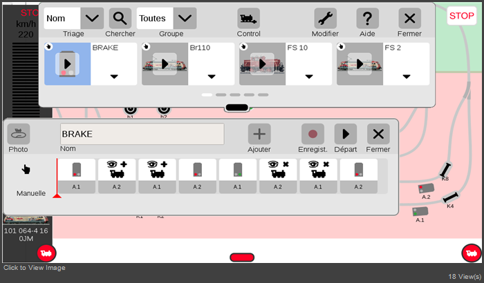

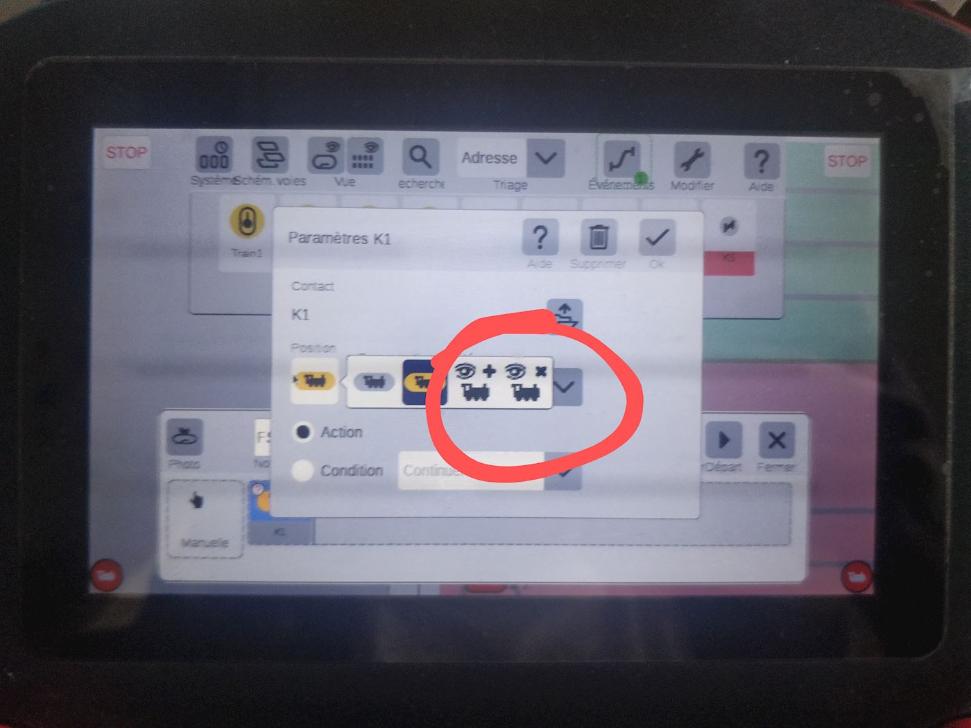

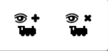

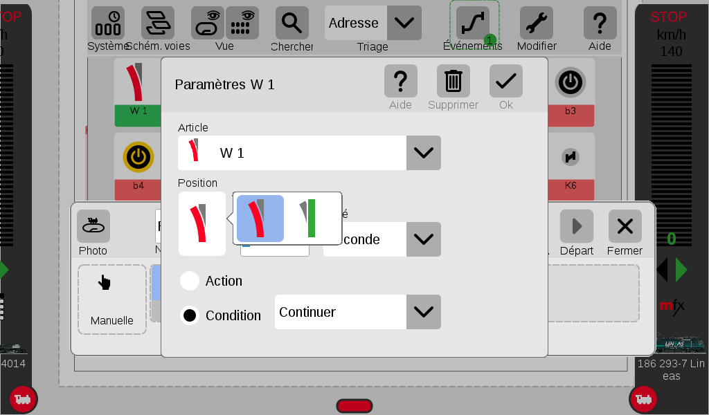

Hello everyone,
Do you know the signification of this icon?
I have seen this with some contact and signal.
Thanks for an answer
E-V
cs3_screenshot_2020_05_10_09_43_25.pngIMG_20200501_194813.jpgIMG_20200501_194859~2.jpgIMG_20200501_194859.jpgIMG_20200501_194914.jpg

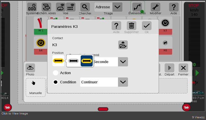

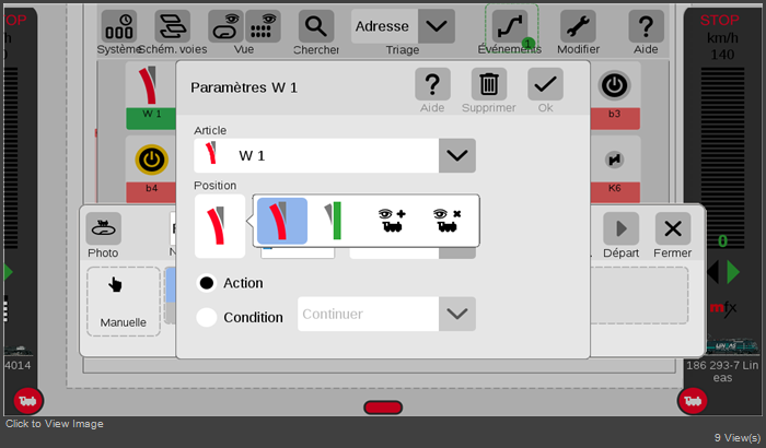

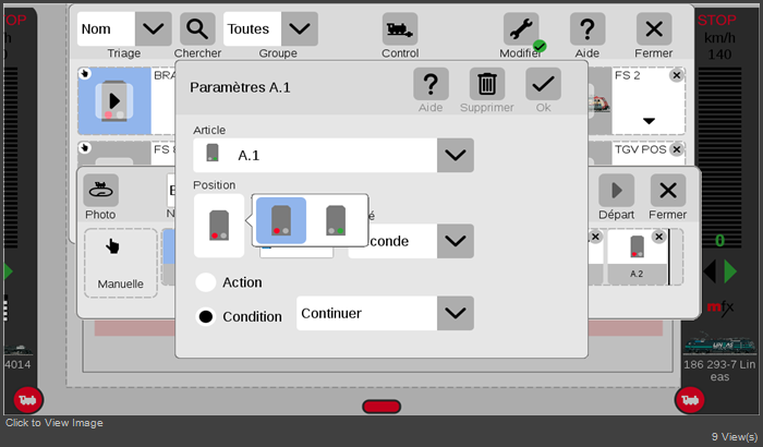

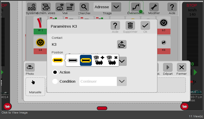

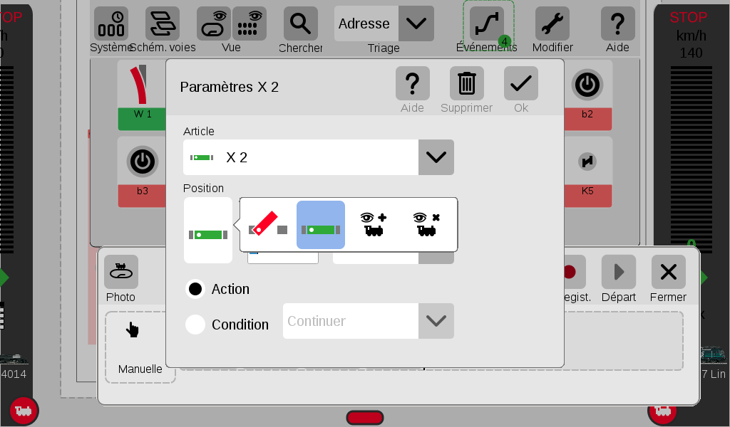

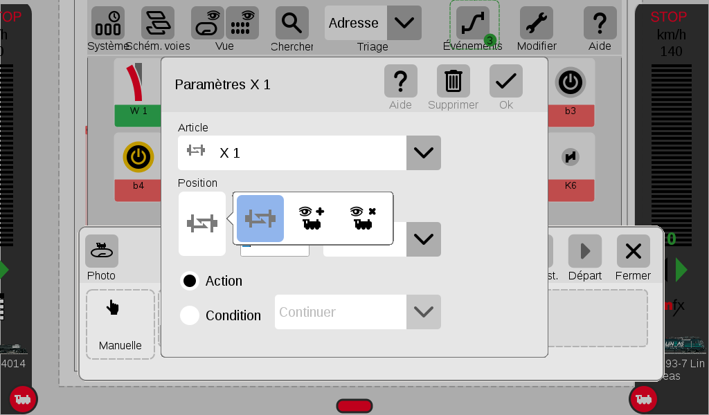

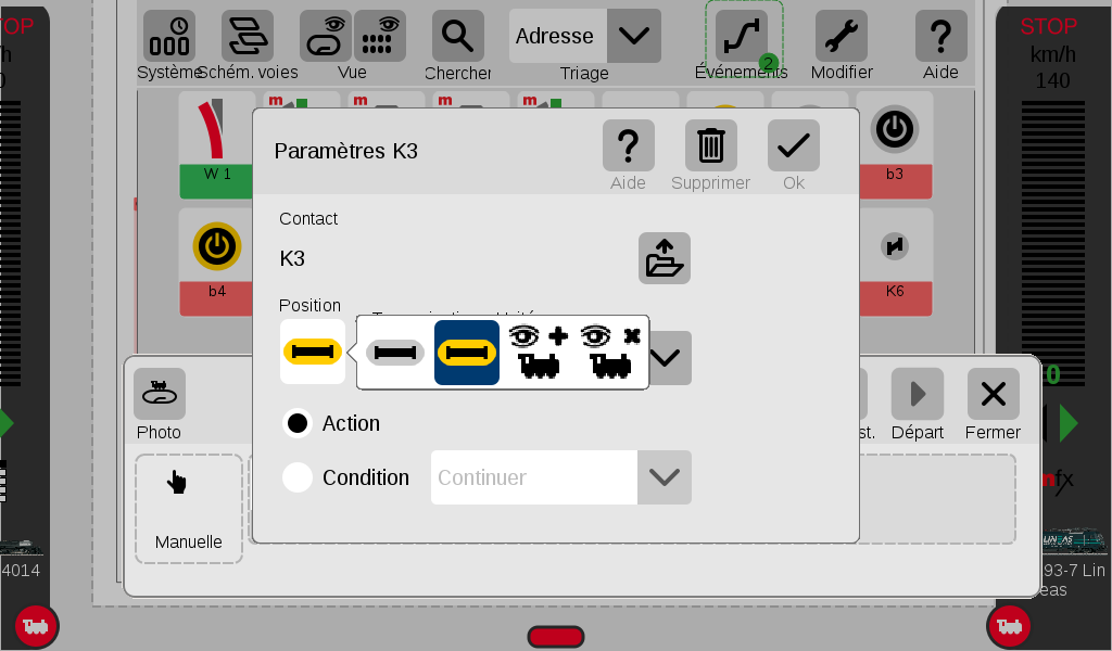

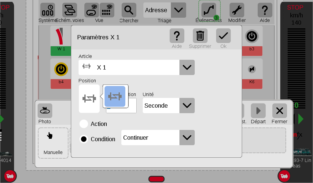

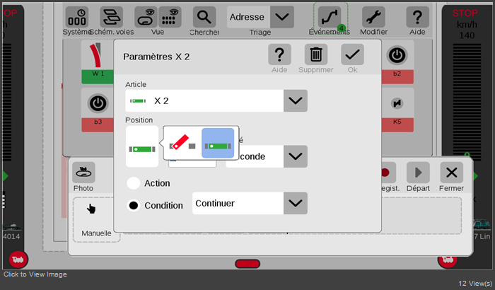

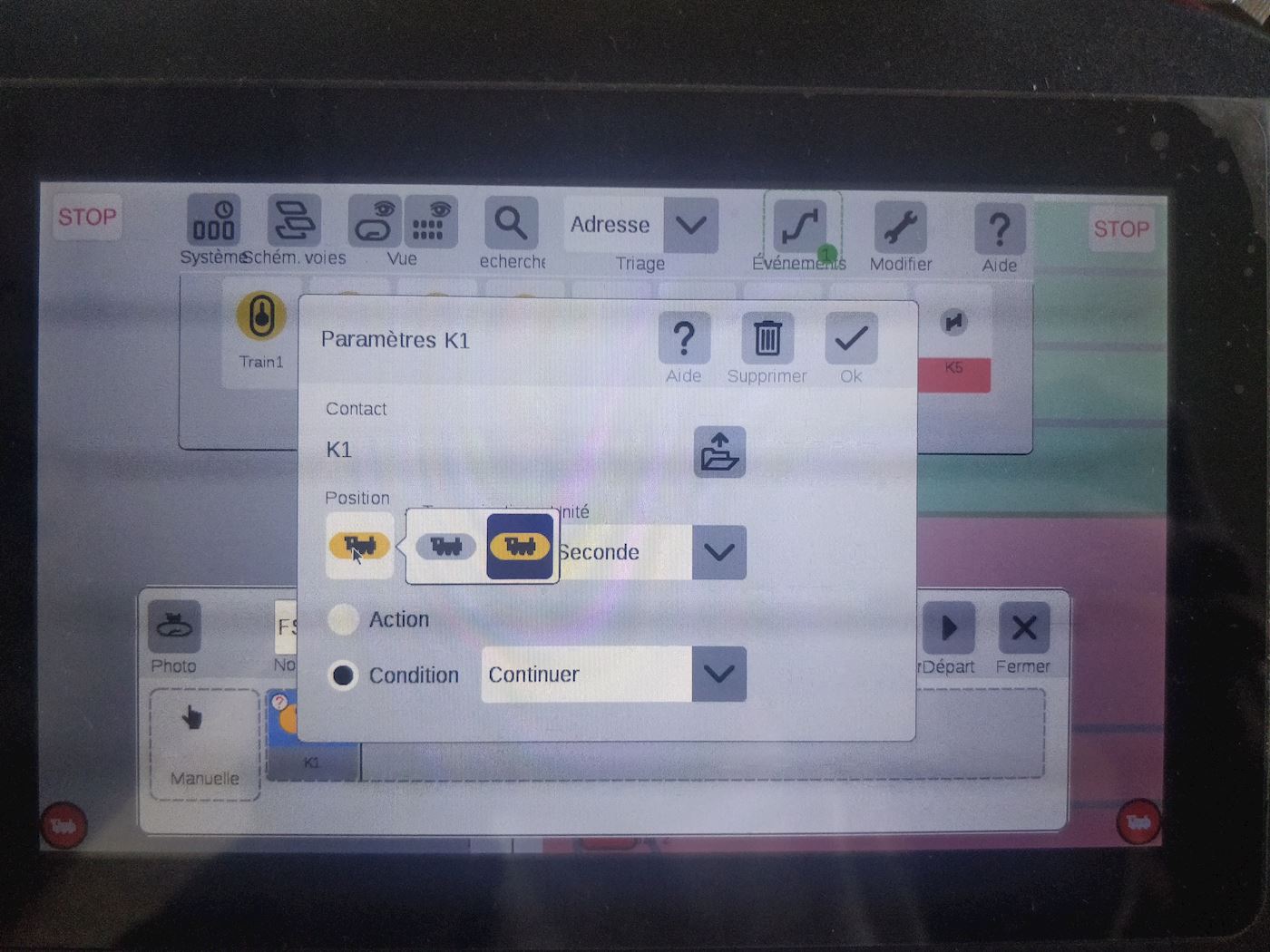

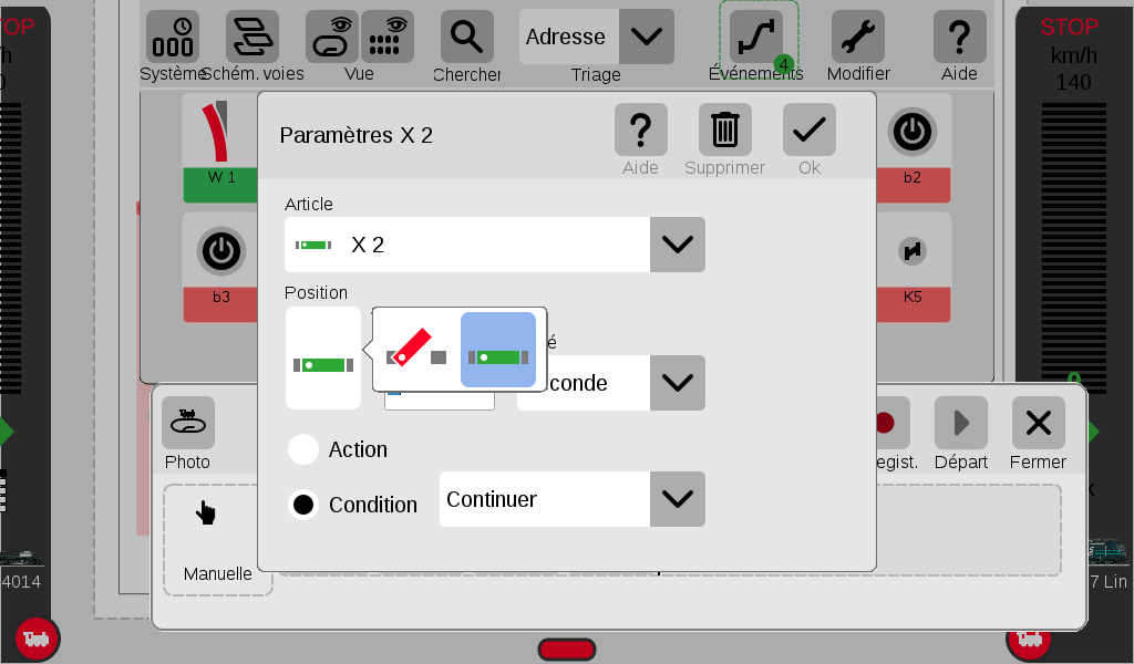

Here are the 2 Symbols
This symbols is at every accessorie with a action, and isn't with a condition.
With a m94 symbol
With a signal
With a turnout
With a Uncoupler track
With a s88 contact

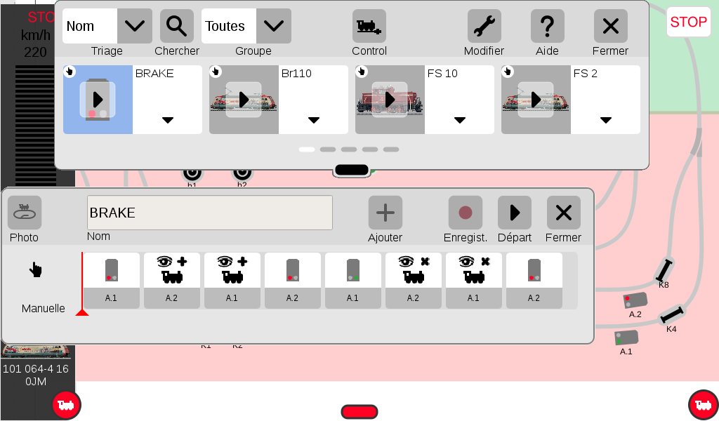

Offline clapcott
#4 Posted : 17 May 2020 03:13:23(UTC)
clapcott
Joined: 12/12/2005(UTC)
Posts: 2,459
They add or remove the the loco name on the track board next to that sensor/accessory
Prior to referencing these, the Event needs to have a Loco mentioned earlier in the sequence.
This may be direct or implied.
For implied, if the event is called from a Locomotive function button, that Locomotive will be used (i.e. override the placeholder if you have set one)
You may also drag/drop a locomotive onto the event BUT only when the event is expanded and in view. i.e it will not work if you drag onto the accessory/sensor or the event button. (I think this is more of a debug tool)
Other comments.
- if you add a locomotive that has been placed on another layout object previously, that old reference will (usually) be deleted
- if you try to load an item that already has another loco assigned to it, it will not work (i.e the add will only work onto an empty object)

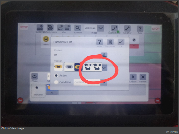

On second reading the new icons simply add eyewash to the layout. Meanwhile I seem to have lost the location or how to access the icon of the eye + loco which posts the name of the loco over the feedback track that is part of the event. How can I bring it up? And what does the one with the eye x loco do?

Hello rhfil,
For this icon, you can find this in event with a accessory blocks. The blocks must in action fonction.
The icon eyes with X is for remove a loco to a accessory .
E-V

Offline clapcott
#12 Posted : 20 May 2020 13:05:16(UTC)
clapcott
Posts: 2,459
Originally Posted by: TGV POS Go to Quoted Post
Can you start a event if a locomotive is on a contact or accessory, or this fonction is only for layout.
For example :
If the Big boy is at the contact k1, then the bigboy shut down, else the locomotive on the contact continue.
The answer is probably yes but not in the simple way one might hope.
The whole "logic" that Marklin is offering with the various advances event functions is based on the premise that you "prime a route" such that you know who is going to go over a sensor in advance.

I am not sure what that youtube video is supposed to be showing
It is just showing an example of the Locomotive name being assigned to different sensor locations
The assignment is done with the use of the the Loco-Eye+ action (as is the subject of this thread) in CS3 Events
it does not look like any CS3 layout
It is a CS3 layout
In the CS3 you may have "Track Diagram Control Board (TCDB)" and/or "Control Desk" layouts
The update to the CS3/3+ only came out in December ....
The Loco-Eye-+ and the Loco-Eye-x options came out with v1.4 around Jan last year

But other than showing you where the loco is on the layout and that your feedback tracks are working what purpose does showing the name of the loco serve?
This statement confuses me a bit. this thread is about the two identified event actions ,which is to show/hide the locomotive name.
Maybe, the issue is not 'what purpose does showing the name of the loco serve?" - which is self evident to me - but understanding the aspects needed in order to achieve that.
For the CS3 to know what name to show, there must be a means to know what locomotive to target.
It is this underlying knowledge that also allows functions like ..
- reducing the "specific locomotive" speed as it is about to enter the throat of the fiddle yard
- setting the speed of the "specific locomotive" to 0 as it enters it road and stop at the signal.
This can be observed in the video if you watch the locomotives speed indicator bar as the locomotive moves around the layout.
