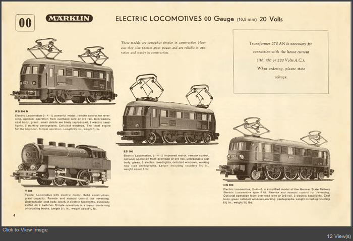

I believe the loco on top is a RS800N in the 1947 Catalogue (page 4) alas in the final stage of "Zinkpest" and has been "repaired".

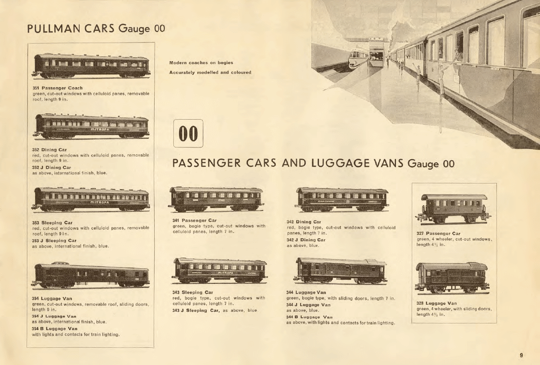

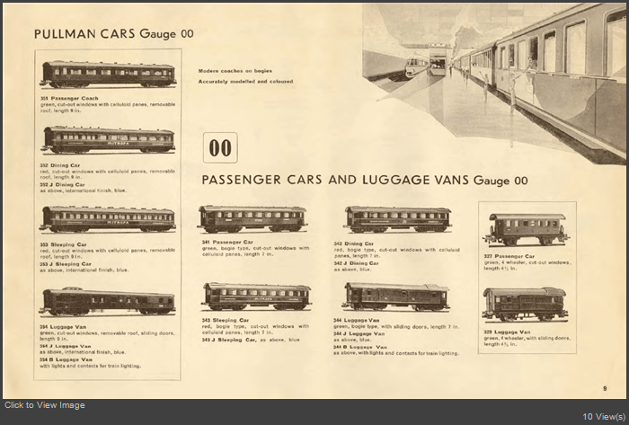

The car is a 353 Sleeping car "Schlafwagen" of the same year with cast bogies. Usually the wheels get loose on their axles and good only for showcase.

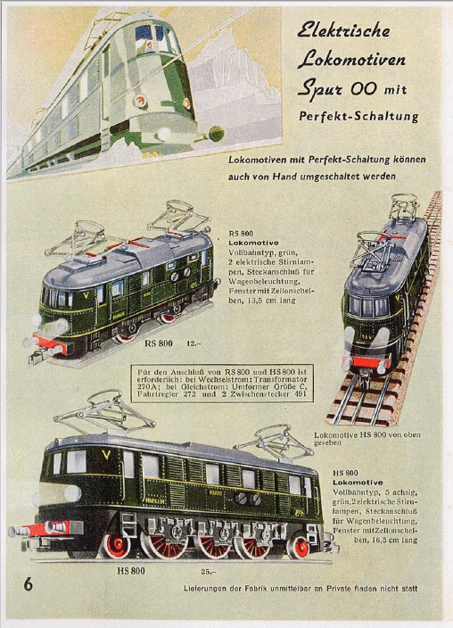

@ kweekalot Yes, the loco was already in the 1938 catalogue
As you may see, the loco has not changed much, except the coupler and perhaps the material quality: in 1946 to 1949 Germany was re-using scrap metal of various origins (Downed planes) which gave very poor results and "Zinkpest" (Intercristaline corrosion).

The RS 800 is not a post-war model, but earlier e.g. 1939-1940: it still has the opening on one side to access the coal/brush screws which was changed (closed) in the postwar models which also had one step instead of two beneath the doors. The ctalogue picture does indeed show the later version and you can see the difference. In another post from today I have shown my 1939 RS 800, this one here is about the same vintage.

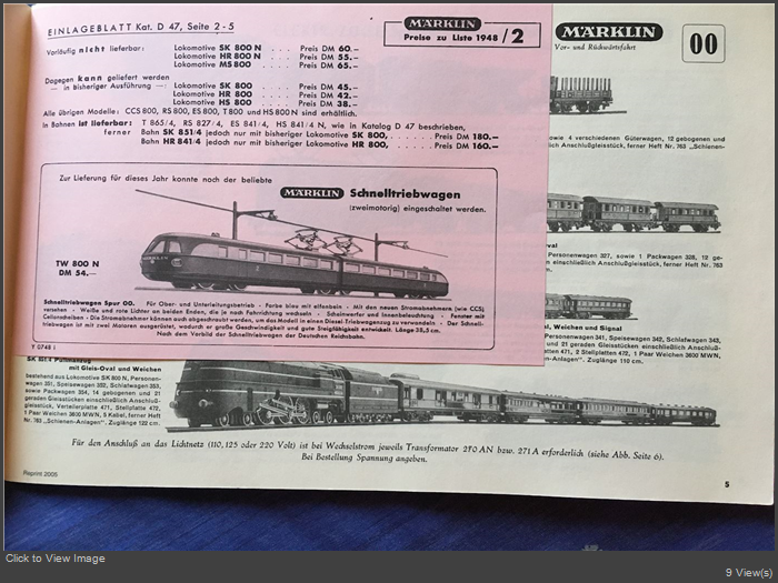

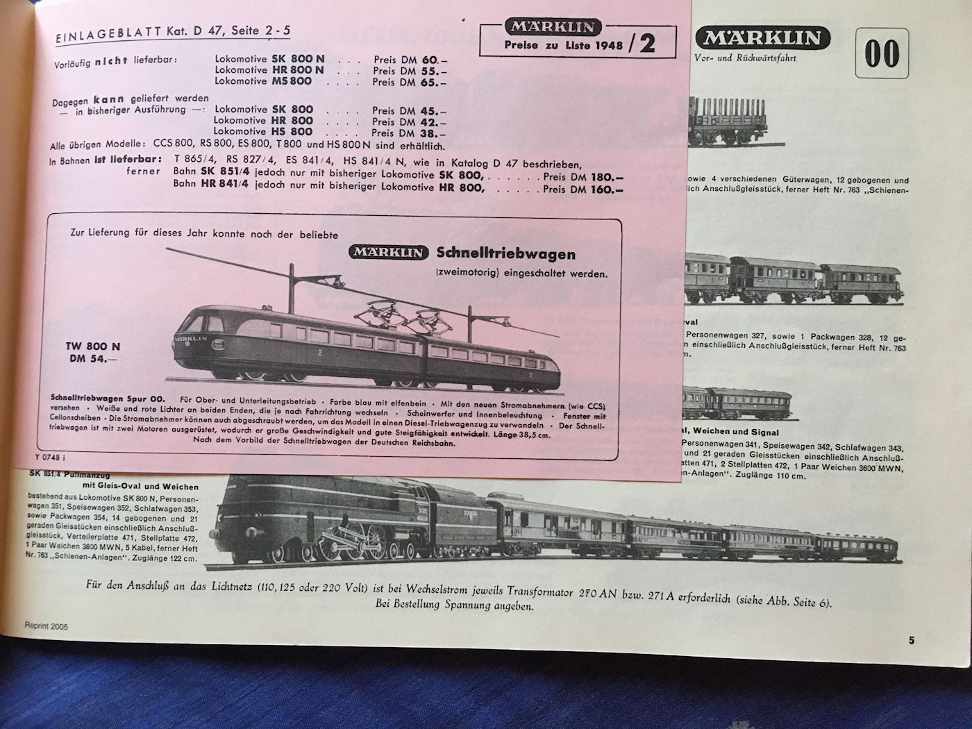

This is assumption on my part but when Märklin resume their production in 1946, they made changes on the catalog (1947) but in the interim continued to produce pre-war-like models (SK800 instead of SK800N, etc).
On the 1947 Catalogue there were pink leaflets glued on the catalog to indicate the "new" models were not available
See the picture below
So why wouldn't they have produced RS800 (with openings for brush holders) or used existing parts stock instead of RS800N? IMO they just did.
There is a clear difference in metal quality used for "Guss" by Märklin in 1939 and 1946-1947
