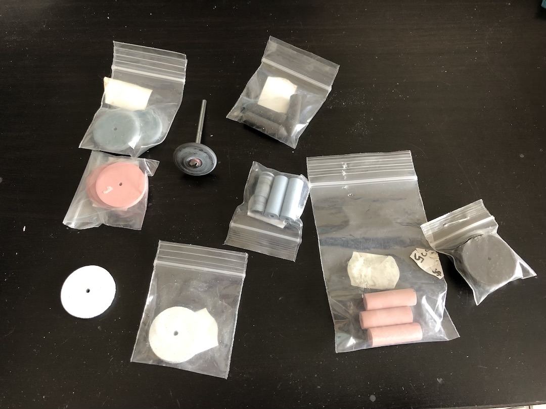

I think you are on the right track (pun intended) with the Dremel.
I use it to clean wheels and armatures. The trick is to find SILICONE POLISHING bits for a Dremel. These are basically like the track cleaner/erasers (Bright Boy) for a Dremel. I get mine from jemcousa.com
These are accurate and make short work of dirty wheels. There are various shapes to choose from.

#6 Posted : 20 April 2020 01:54:21(UTC)
Posts: 3,004
Originally Posted by: owidgie Go to Quoted Post
Hello all.
Rick
Brilliant Rick! Much better than a wire brush on the dremel. I'll have to order some up.
The other amazing tip is cigarette lighter fluid (which I had heard of using before) on "eye tees" which are a makeup thing of sorts that is much more durable than a q tip. I've ordered a box on amazon to try out!
Offline owidgie
#7 Posted : 21 April 2020 19:57:02(UTC)
owidgie
Joined: 03/06/2007(UTC)
Posts: 169
Great, I think they work well and it is fast.
What John said is correct but I put drag on the other wheel of the axle with my thumb so the wheel doesn't spin too fast when I do this. Also give the dremel about 25-30 degrees of angle and have it on the slowest speed.
Rick
