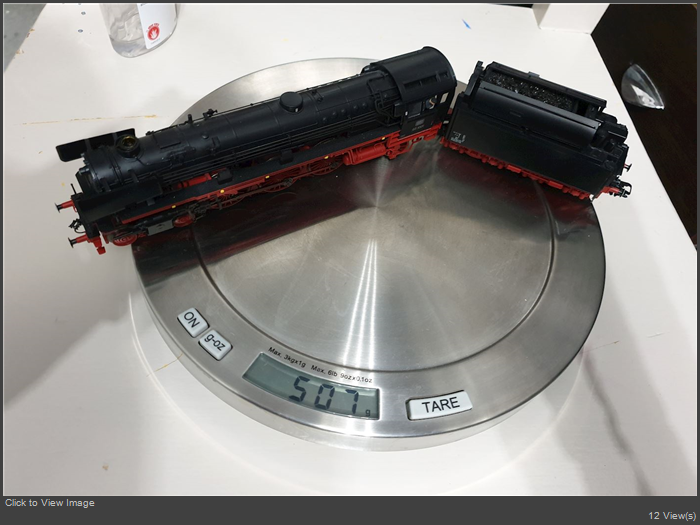

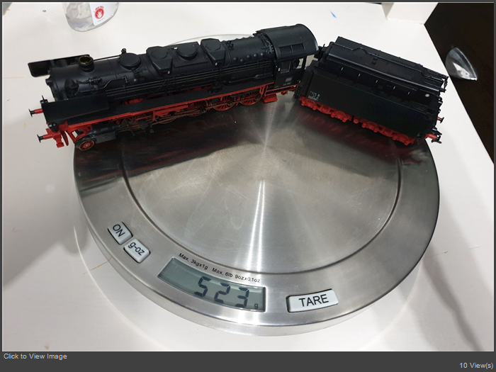

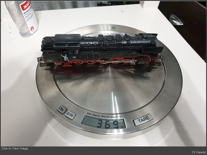

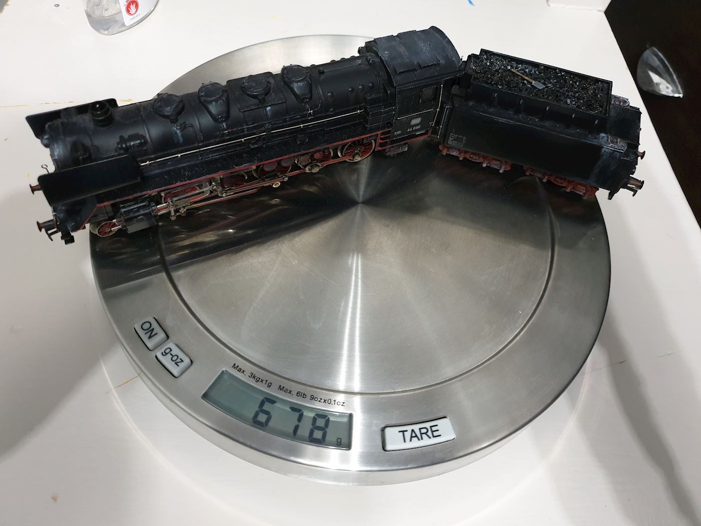

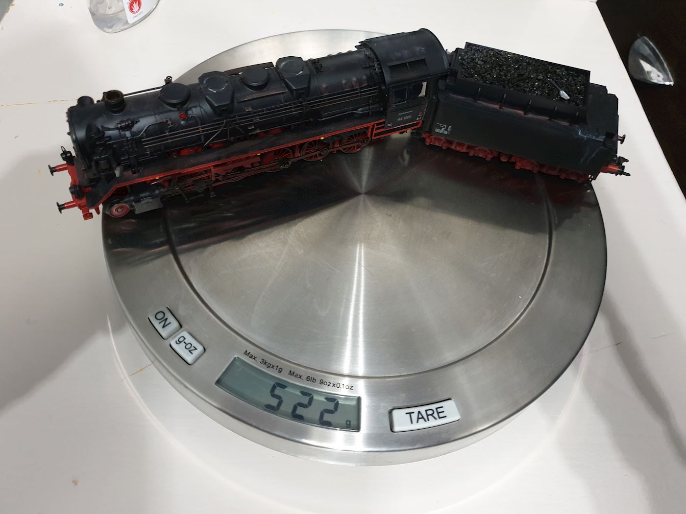

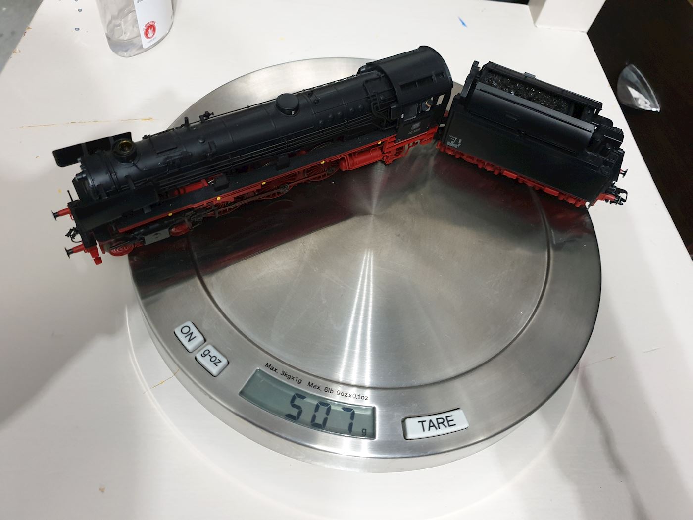

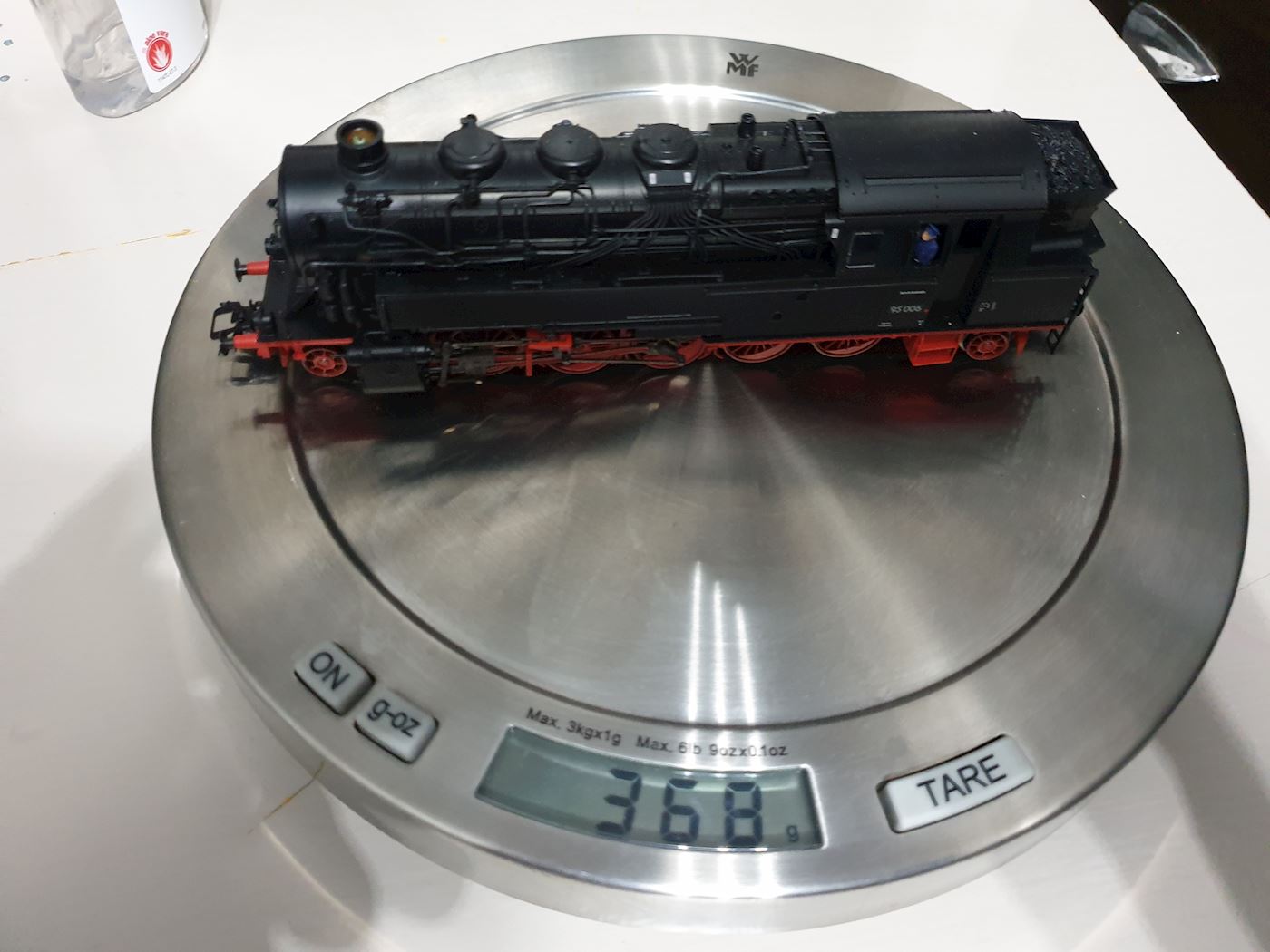

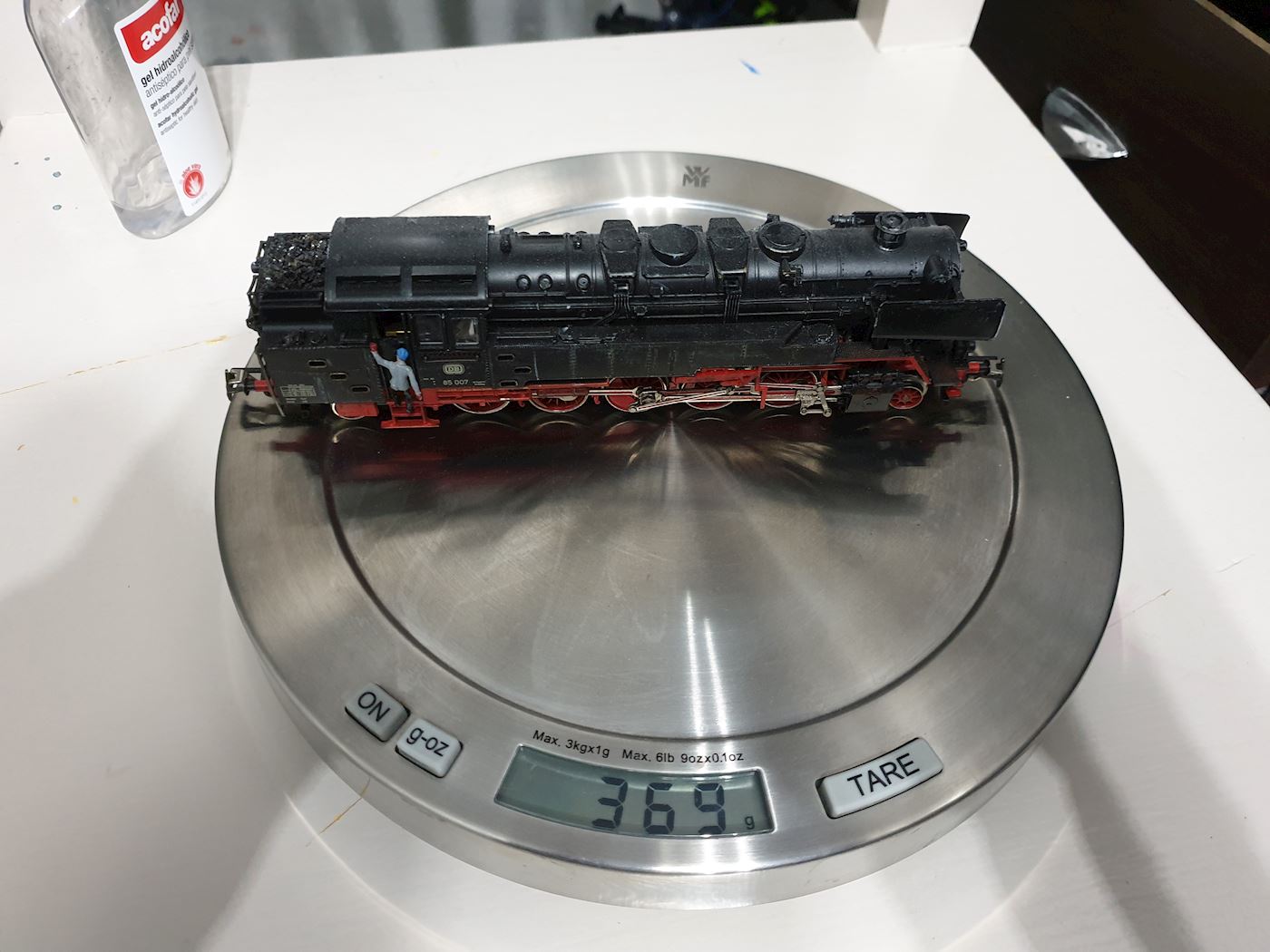

Reading the thread I had the need to weigh some of my locos...here you are, the well kown BR 44 3047 vs modern day BR 44´s and BR 03. In addition, two similar tender locs: a middle eighties produced BR85 versus a modern BR 95.
I don´t know for sure but I guess 150-160 grms is quite a big difference as we´re talking about scale traction power...
Carlos
Carlos
In the pictures you show here, your are also weighing at least part of the tender... which absolutely doesn't participate to the traction effort ...except on the old 3047 where a coiled spring transfers some of the tender's weight to the rear drivers of the loco.
Told you those were really clever! Laugh Wink Wink
Carlos
Anyway, the loco has to pull also the tender alongside the consist so all in all is traction power. Maybe I´m wrong: you know, I´m a not a Science man, just your humble History teacher...

My problem was related to the 3102, the metal boiler was off set and its weight was heavier towards the front bogie lifting up the rear bogie and therefore losing its traction force, I had to add a small washer to align the boiler to its rightful position where you actually tie the screw to the frame, there was enough play for the boiler (1mm) to drop in the front.
