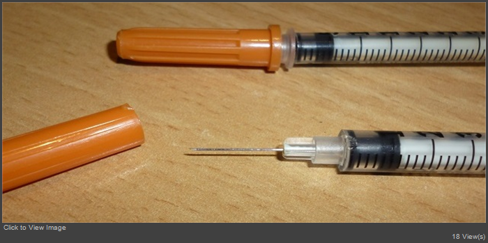

Very easily done and M. don't really make it that that easy with their applicator. The older style with the metal applicator is easier than the newer nozzle but both still allow too much oil to be applied.
But I realise that there is a safety aspect to them as well.
Next time you visit your Doctor, Nurse or Dentist, ask them for a syringe with the needle. You'll need to explain why of course but I just finished a project with a friend where I had to lubricate maybe 200 Locos and rolling stock.
I can tell you that using a syringe not only gave me far more precise control of where I was putting the oil, especially getting right onto the loco wheel axles, but it also means I applied only the smallest drop.
DISCLAIMER
Of course, it goes without saying - you cannot be careful enough using these. These are EXTREMELY SHARP and will pierce skin without you even feeling it.
If you have a tendency towards clumsiness, this may not be a tip for you. Scared
