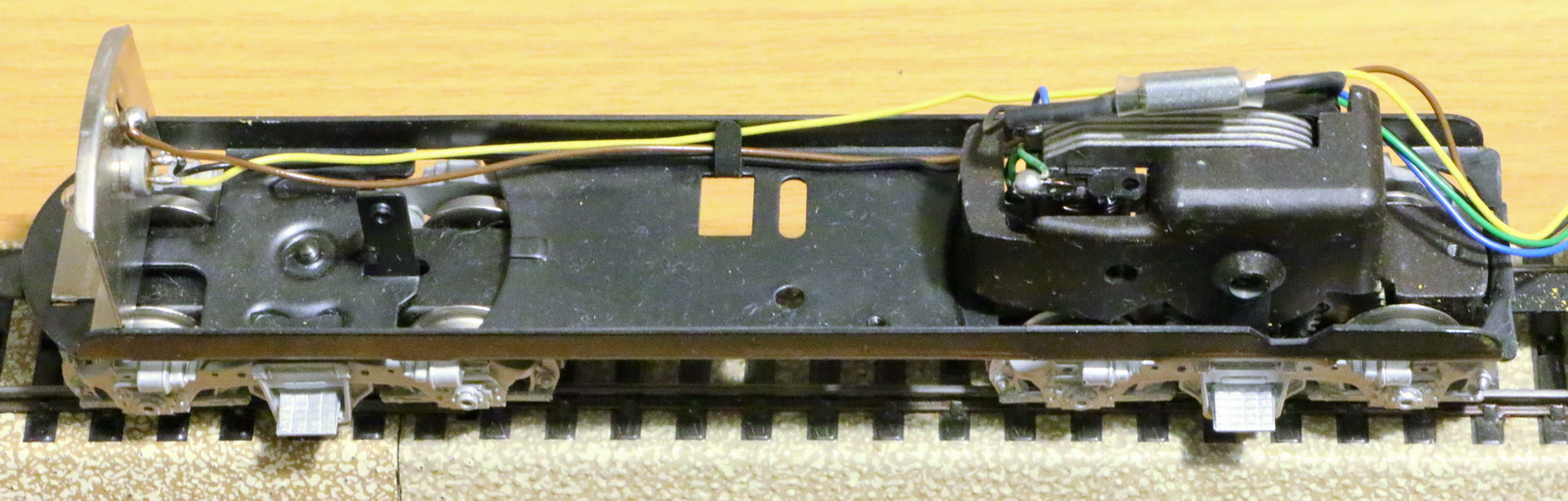

Put marks for the end A units who is front and who rear
Inside we can see the motors the reversing unit etc.
The A unit with the motor and the E-reversing unit
The front light

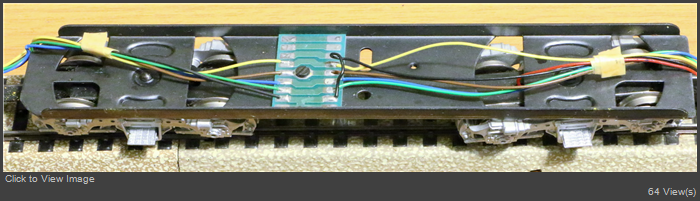

The B unit.

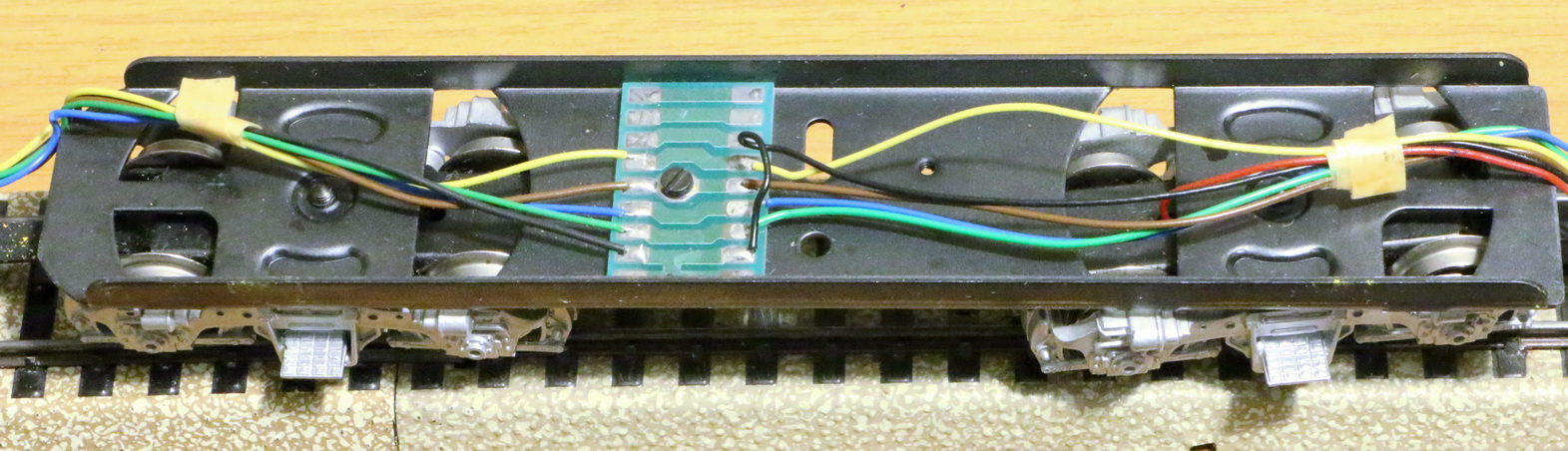

There is a contact PCB there like a main distribution board.

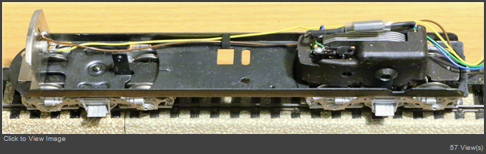

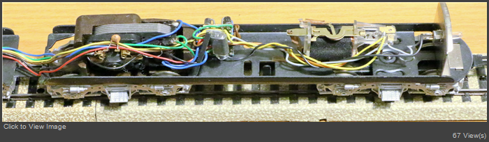

The other A unit with only the motor
Desolder everything
Check and clean all the parts and especially the motor bogies

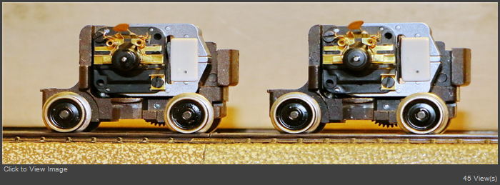

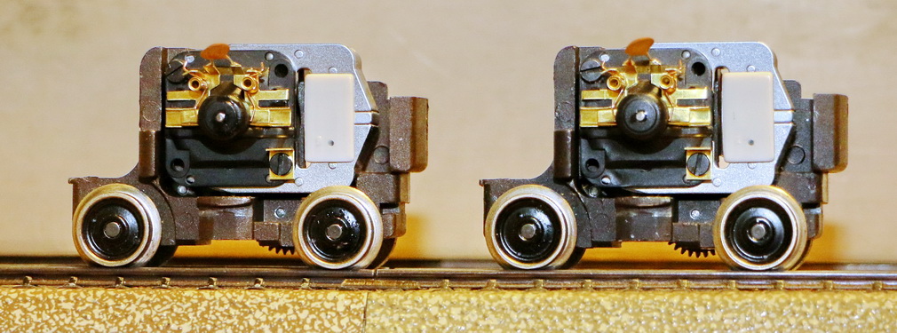

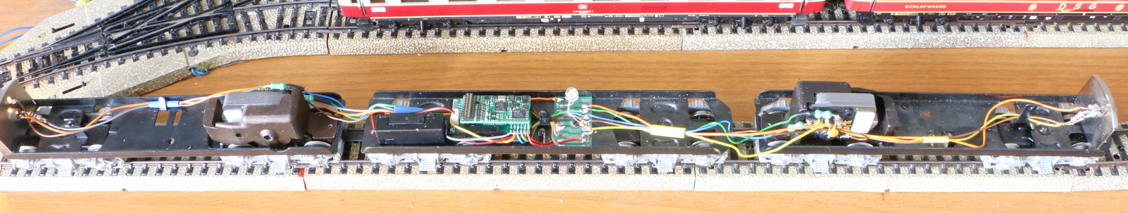

The bogies with the new motors
The motor in place

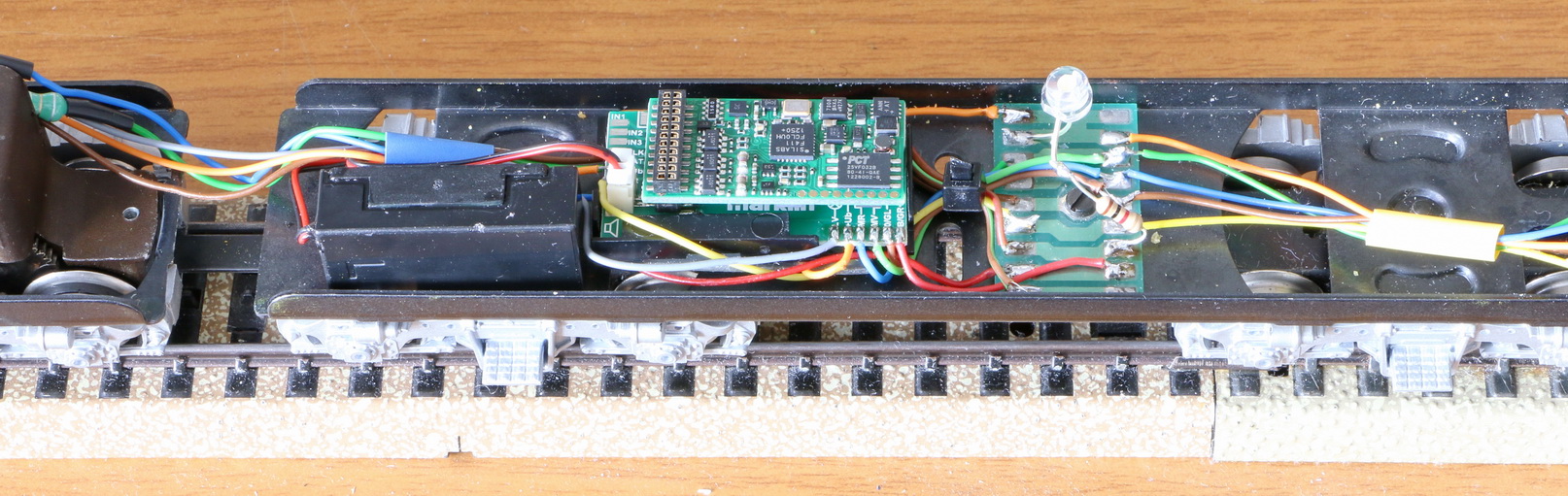

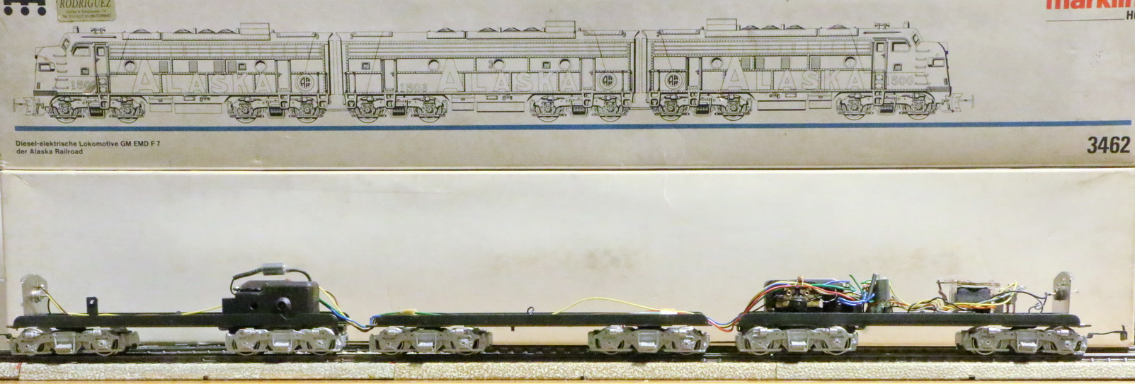

I decided to put the decoder and the speaker into the B unit.
Next to the distribution PCB.

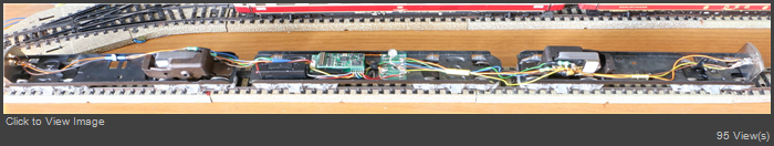

The two motors connected with the decoder in parallel.
The measurements of the consumption of the two motors with the CS3 reveals that the decoder output is enough for the two motors.
I put a 5mm WW LED soldered on the PCB with a 1kΩ resistor on AUX 1 for some light in the engine room B.
You can see the soldering of the various wires. Märklin color code
The B unit with the decoder speaker etc

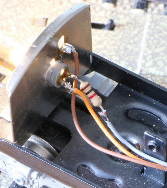

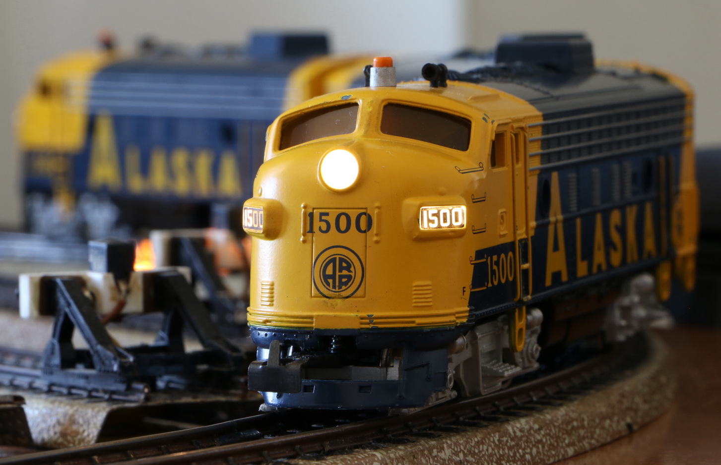

For the front and rear lights I used 5mm WW LED's plunged in the original socket, with a dropping resistor 1kΩ in series on the negative for each LED.
Of course there are many lighting possibilities as there are 3 AUX still available plus plenty of space in the loco complex.

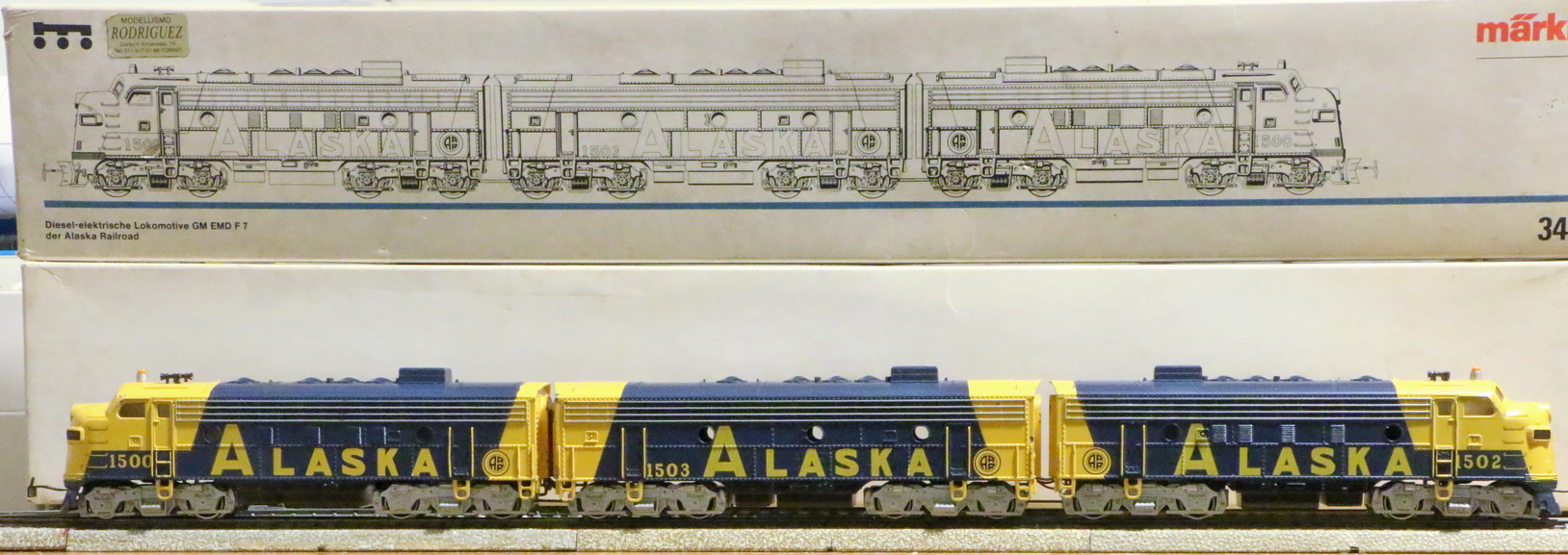

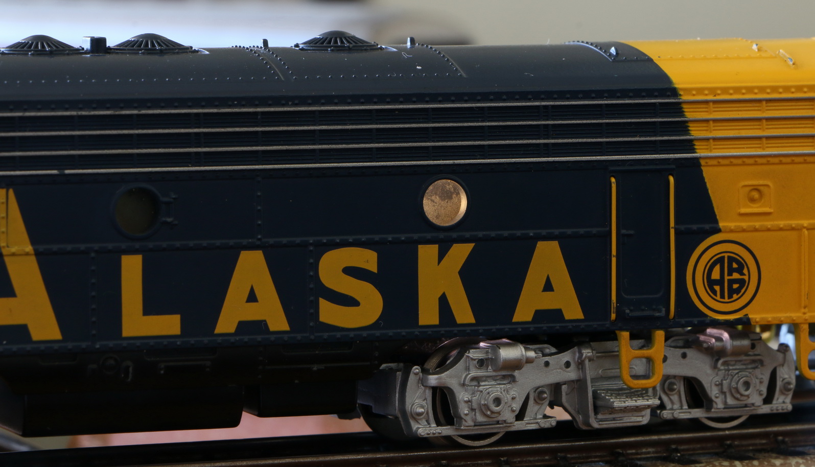

The final result:

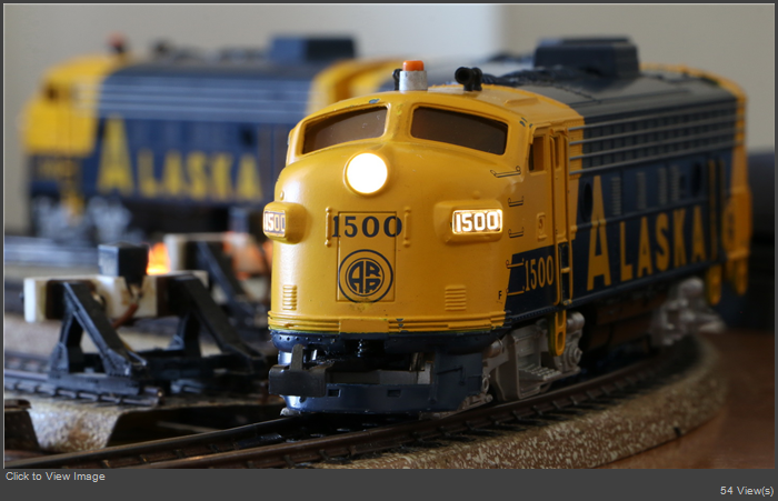

The front 1500

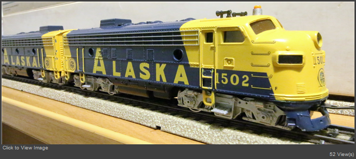

The rear 1502
The middle 1503

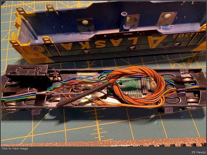

I'm about to embark in this conversion, waiting for decoder and motors. In the meantime, the set came with a couple of yellow foam pieces between the units (see pic). I got the foam out but there's residue left over. Not wanting to damage the paint I decided to consult this fine forum for advice. What solvent would be best to get the residue off the bodies? Alcohol, acetone, goo-gone?
Thanks in advance for your help.
Regards, Tony

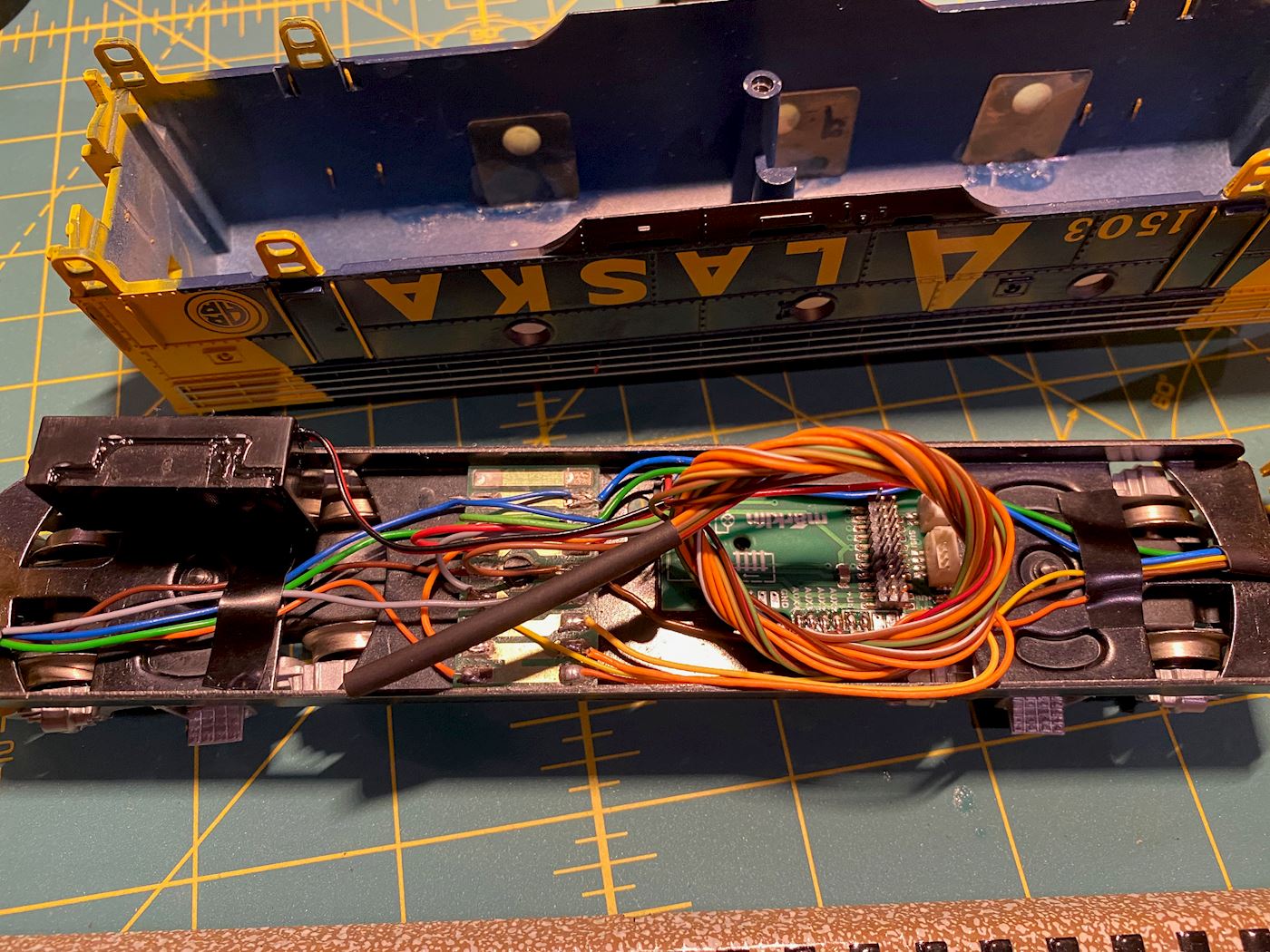

Offline HerrDoktorBD
#15 Posted : 18 August 2020 15:07:20(UTC)
HerrDoktorBD
Joined: 10/07/2019(UTC)
Posts: 25
Digital conversion successful.IMG_7021.jpeg IMG_7026.mov (10,979kb) downloaded 36 time(s).
thanks 2 users liked this useful post by HerrDoktorBD
#16 Posted : 18 August 2020 16:39:52(UTC)
Posts: 6,053
Is the decoder resting on the metal chassis? If so, that would be quite risky...
#17 Posted : 18 August 2020 16:50:41(UTC)
HerrDoktorBD
Posts: 25
The decoder motherboard is in its plastic holder.
thanks 1 user liked this useful post by HerrDoktorBD
