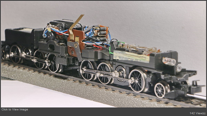

Hi All,

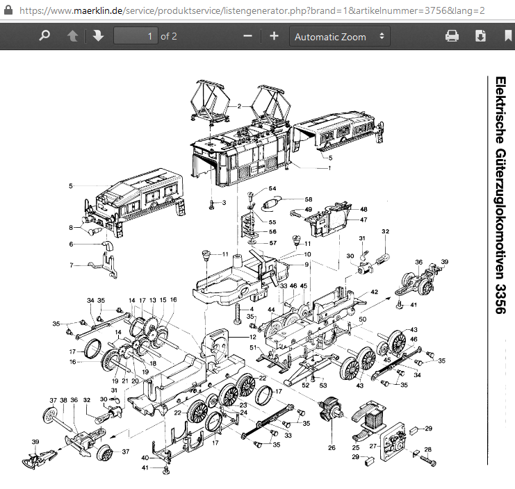

I bought a used Crocodile off eBay and it did not come with a manual. I looked on the Marklin site and it appears that it did not have one originally. The serial number starts off with H00 so I'm assuming that this Croc was manufactured in 2000.
It has a parts list at:
https://www.maerklin.de/...elnummer=3756&lang=2
but the schematic labeled for a 3356. I'm assuming the model number changed but the internals did not.
On the underside, there is a 120 degree angled lever. On the above schematic, it is just to the left of the number 33 (to the left of the 3356 label and below the right pantograph). Does anyone know what that lever does and what position it should be in for various functions???
It almost looks like it could be moved to draw power from the pantographs. Any help would be appreciated.

This is in reference to my original post. I'm new to trying to link to an internal article and pictures. The name of the topic is:
Märklin 3352 Ce 6/8 Crocodile, Digital Conversion
and the picture is the fourth one in posting #2.
Hopefully, one of this links will take you to the photo with the above lever.
https://www.marklin-user...rce.ashx?p=38442&b=1
https://www.marklin-user...ile--Digital-Conversion#
https://www.marklin-user...rce.ashx?i=38442&b=1
https://www.marklin-user...al-Conversion#post541388

The lever is to change between rail and catenary operation.
In my pictures the lever is in the position to take power from the center rail on the rails.
The position in my photos is for the rails feed.
If you post a photo of the loco may be we can tell you witch exactly is.
The 3356 has an old style analogue reversing unit.
The 3756 is the same mechanically but has a digital decoder instead of the reversing unit.

Attached is a photo of the switch position. The switch is to the left of the left yellow hand rail and above the prominent rail wheel. It is not easy to spot so I added an arrow where the point is directly on the switch.
Is it possible for the switch to be in a "middle" position where it can draw current from both the center rail and the catenary?

It looks like the diagram has the reversing unit as I see parts labeled: Fahrtrichtungsschalter and
Schaltschieberfeder for Direction switch and Switch slide spring, respectively.
Does the cover have to be removed to change direction on the 3356? The reason I ask is that there appears to be some electronics on the unit just below the "49" in the attached diagram but the switch itself appears to be mechanical:
This looks like a good candidate for a motor/decoder upgrade. Does this affect the value of a Lok when one goes to sell it?

I was wondering about whether it has a high efficiency propulsion system or not. The 3356 parts diagram shows a 3 - pole motor. This is what came up when I searched on "3756":
You can see the 3756 in the URL window and the 3356 on the parts sheet. Part #26 is a 3-pole motor. Koll's 2019 reference manual lists this Kroc as DIG * (High Performance Drive) which would imply a 5-pole motor and it would go along with what you and your link are indicating.
A Lok built in 2000 would likely need to be upgraded at least electronically to take advantage of the newer features. Is it worth it? I see a lot of "yes" votes.

3356 (3-pole motor / delta decoder) and 3756 (5-pole / 6090 decoder) were both produced approx. 1994-2004.
Both have the 13305 road number as shown in your pic.
If you want to be sure about the motor and decoder, you should open it.
If not:
- The orange H00 serial number proves that it is a 3756 5-pole, unless someone has ripped the motor and decoder
- I suppose you have no box, as that would help: a white 3356 box vs. a grey 3756 box
- If you test drive and start with full throttle: does it have gradual acceleration/deceleration? If so, it is a 3756 with 6090 decoder, if not, is is either a 3356, or a 3756 with acc/dec turned off.
If still in doubt: just open it.
You are correct that the download for 3756 in the Märklin database erroneously links to the 3356 sheet. That is just an error and does not tell you anything about your loco.

If your doubt was just based on the 3356 spare parts sheet that is linked to the 3756 record in the Märklin database - don't worry, that is just a link error.
