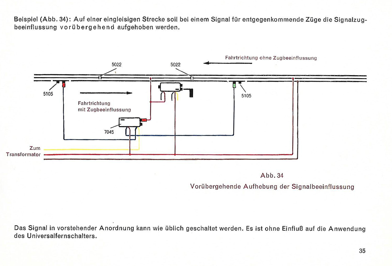

#6 Posted : 16 March 2020 11:43:50(UTC)
Originally Posted by: HO Collector Go to Quoted Post
You have X2 options:
1. Add a parallel section so one track is for the train travelling to the right and the other to the left, or...
2. Go digital with track sensors and computer control, then the computer knows each trains position and can stop the train per the pre set program.
I hope that this helps.
Ben
Hi, there is in fact at least a 3rd alternative...Wink Wink
Those of us who were born before the digital era Wink had to solve the problem "electromechanically" ...
I remember doing this many years ago...more than I care to count!RollEyes
In your case it implies the use of a either 2229 , 2239 or 2299 directional contact track ahead of the signal you'd like to by-pass (because you'd be traveling in the opposite direction. .
These contact tracks are actuated by the loco's pick up shoe.
It would be used to trigger a "universal relay" 7244 whose contacts would have to be wired in parallel with the signal's.
Since you seem to be new to this, I'd suggest you start doing this with one signal first that you only need to bypass when passing it "in reverse"
Somewhere in the old "Signalbuch" is the schematic that will accomplish this.
I'll try today to "exhume" that one from the "old books' library" and scan the picture/schematic for you.
Jacques

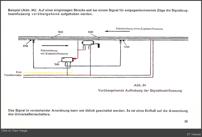

#10 Posted : 18 March 2020 15:54:21(UTC)
Originally Posted by: Primo -23K Go to Quoted Post
Hi Jacques
Thank you for your help
I'll wait for your schematic
kind Regards
Primo/Trainset
OK here it is
Major difference is that the current C-track and K-track have directional contacts , so you can differentiate the action, depending on the direction of travel (which greatly simplifies the connections)
The 7045 equivalent today is 7244, which has 4 set of inversion contacts instead of 2 in the old one.
The sequence of action(s) is as follow
1) The loco travels from right to left ( Fahrtrichtung ohne Zugbeeinflussung. Travel direction without action on the train) ) and activate the first contact track (with the green dot)
2) the relay's contact has now temporarily "bridged" the signal's contact which puts power back on the signal controlled track section (defined by the two 5022 insulators) , but **without changing the signal aspect**
3) the loco travels , passes the signal, passes over the second 5022 and hits the second contact track (with the red dot) which returns the 7045 relay back to its original (open) condition
Et voilà!
I suggest you try with one signal first, using only one of the switches on each contact track ...
After you understand how it operates , you'll soon see that adding the second set of contacts (that will then operate in reverse sequence...) will give you exactly the same effect on the second signal , i.e in the reverse direction
It's not "magic", just "logic"
Don't hesitate to ask for more info or help with translation if needed
Have fun.
Jacques
