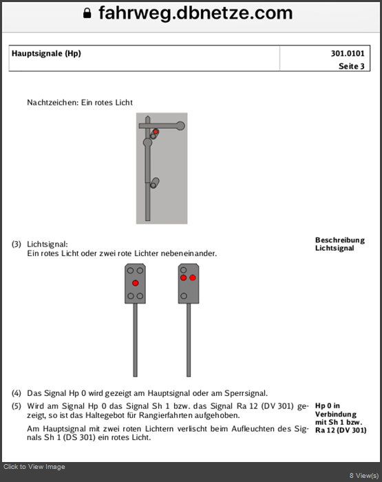

Originally Posted by: thing fish Go to Quoted Post
My guess is that all mainline signals must be red in case shunting allowed, and shunting shouldn't be allowed if any main signal is green.
That is my understanding, too. Below is an excerpt from the “Signal-Buch - DB Netz AG” regarding the combination of HP 0 and Sh 1 /Ra 12 (see note 5).
https://fahrweg.dbnetze....tualisierung_10-data.pdf
Thanks for this link. I knew that such a book of the DB AG must have been somewhere in the Internet, but I had it not found yet. Now I got it. But doesn't make it laughing almost 200 pages for explaining simple signals? Laugh Just wonderful.
