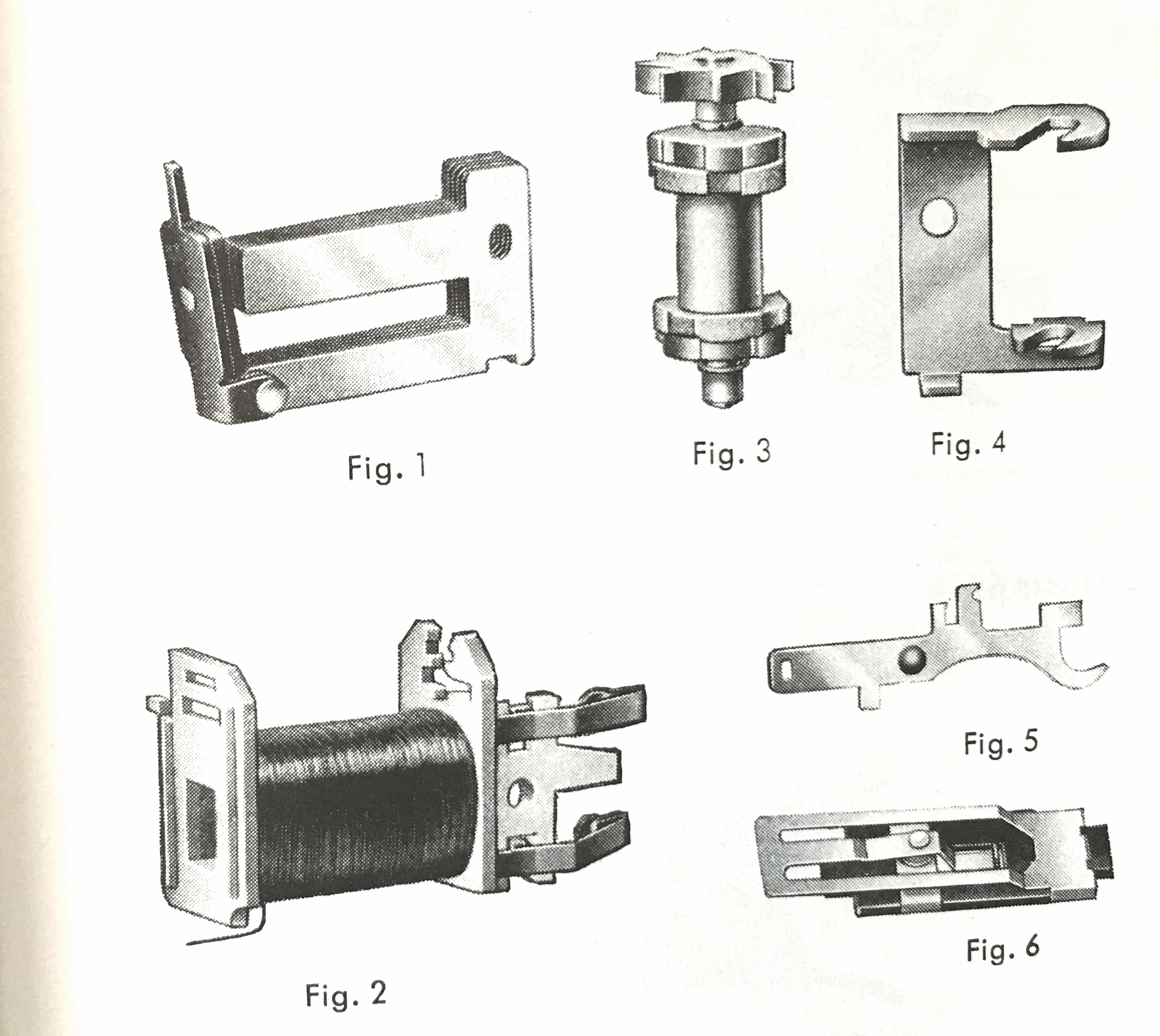

#10 Posted : 09 March 2020 11:13:03(UTC)
Posts: 3,727
Hi Michael
Thank you for the pictures.
Yes it is the good relay. If the coil is working then you can repair it.
One word of advice: be extremely careful when removing the unit (the one screw near the contacts as the tiny enameled wire is connected there (the ground return of the solenoid) and can be broken easily.
Once removed it is easy to disassemble, straighten contacts and clean then
My image hosting is temporarily unavailable so I attach the picture: an opened relay. Telex relay.png
It is made of 7 parts:
- the solenoid supporting also the 3 contacts (2 extreme for motor coils, the center one for Telex)
- the armature and the pivoting plate
- the rotor (sort of drum with circular segments
- the ratchet
- the rotor holder
- the auxiliary contact ((to stop the motor when the relay is activated
- the spring
I hope this helps
Most probably someone has tinkered with contact soldering. When making new solder make sure to make them on the point of attachment (as far as possible from the contact itself.
