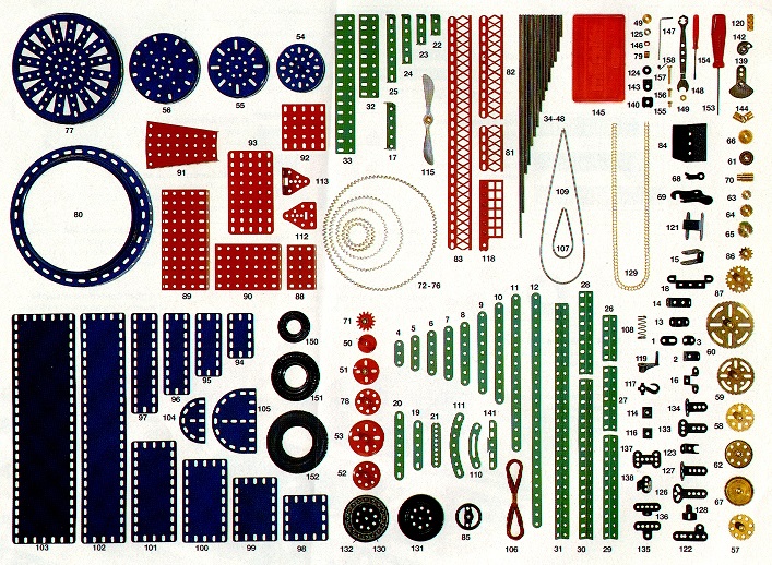

I'm waiting for Markus Schild Offline to join this discussion - what he doesn't know about M-Metall isn't worth knowing Laugh
In the meantime, this site has a brief history of M-M and a nice graphic of the parts available - (ignore the weird links, seems some keywords have become advertising links)
http://www.dalefield.com...s&ends/marklin2.html
A full-size image can be downloaded at the above link
