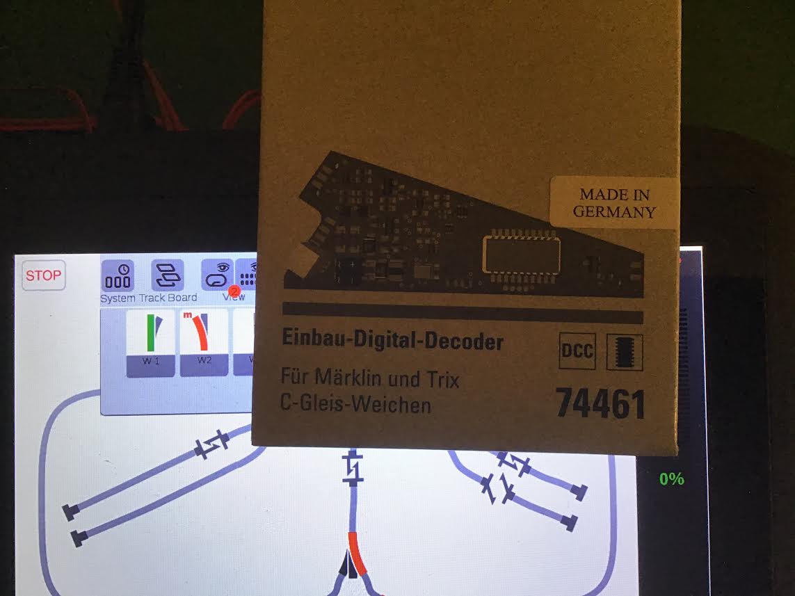

Marklin has updated the 74461 decoders and made them DCC enabled. If you have a MFX contoller it will seek out the factory set MFX address and that will override the dip switch setting. The boxes are clearly labeled "DCC" and when you bring up the attachments setting the switch is labeled with a "m". 2.jfif (63kb) downloaded 59 time(s).

Thanks for your hint. Was not aware yet, Maerklin offers since 2019 (see last Maerklin Catalogue 2019/2020) actually another new mounting decoder for C-tracks, a third one.
74460 with MM (fx) format - no longer build
74461 with MM (fx), DCC format - no longer build
74462 with MM (fx), DCC, mfx format

You are correct. I grabbed an older box which had slid on top of the new ones which are 74462 and have a mfx in front of the DCC.
The 74461 has been DCC capable from the getgo.
Maybe you were meant to say "Marklin has updated the 74461 decoders with a 74462"
(A similar statement can be made about the 74465 being updated to the 74466)
This concept is the same catch up as from the m83 (60831->60832) and the m84 (60841->60842)
At the risk of sounding like a broken record, the mfx reference is for confiuration management only .
There is no such thing for these units as an operational mfx address.
You MAY (see below) use the mfx protocol to configure the MM/DCC address. But when set is is USED/CONTROLLED by MM or DCC.
HOWEVER. While you can set the address with the mfx configuration protocol, you cannot set the MM/DCC mode - this still requires you to know which one you want and to physically set DIP switch position 10 applicably.
