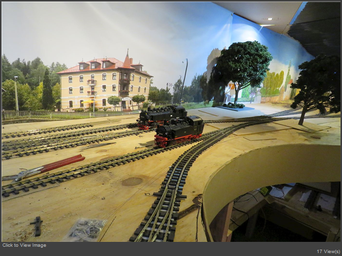

I am helping a friend along with a couple of others to build his layout.
My contribution is on the scenic side These photos are from October 2019

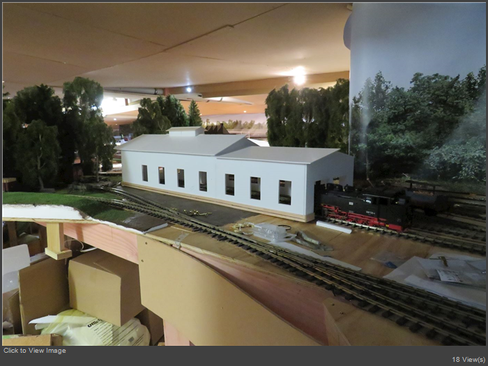

January 2020
Bertsdorf signal box and engine shed made an appearance today to test fit size and placement
The track beside the engine shed can be realigned so that the aisle way will be expanded to 600mm (currently about 470mm)
Backdrops realigned, couple of trees planted, and even a picture of me planting them
Overall a good days work!

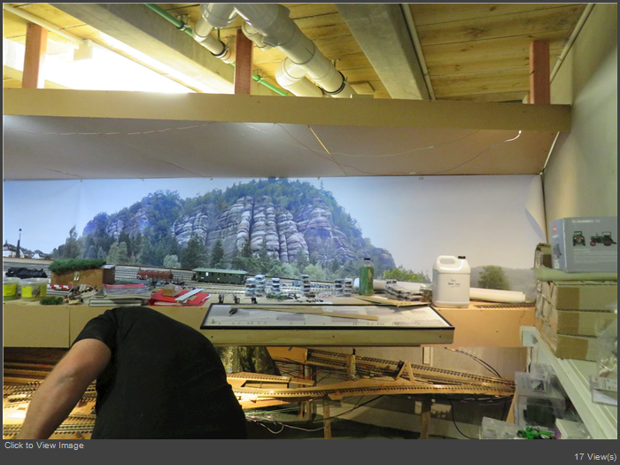

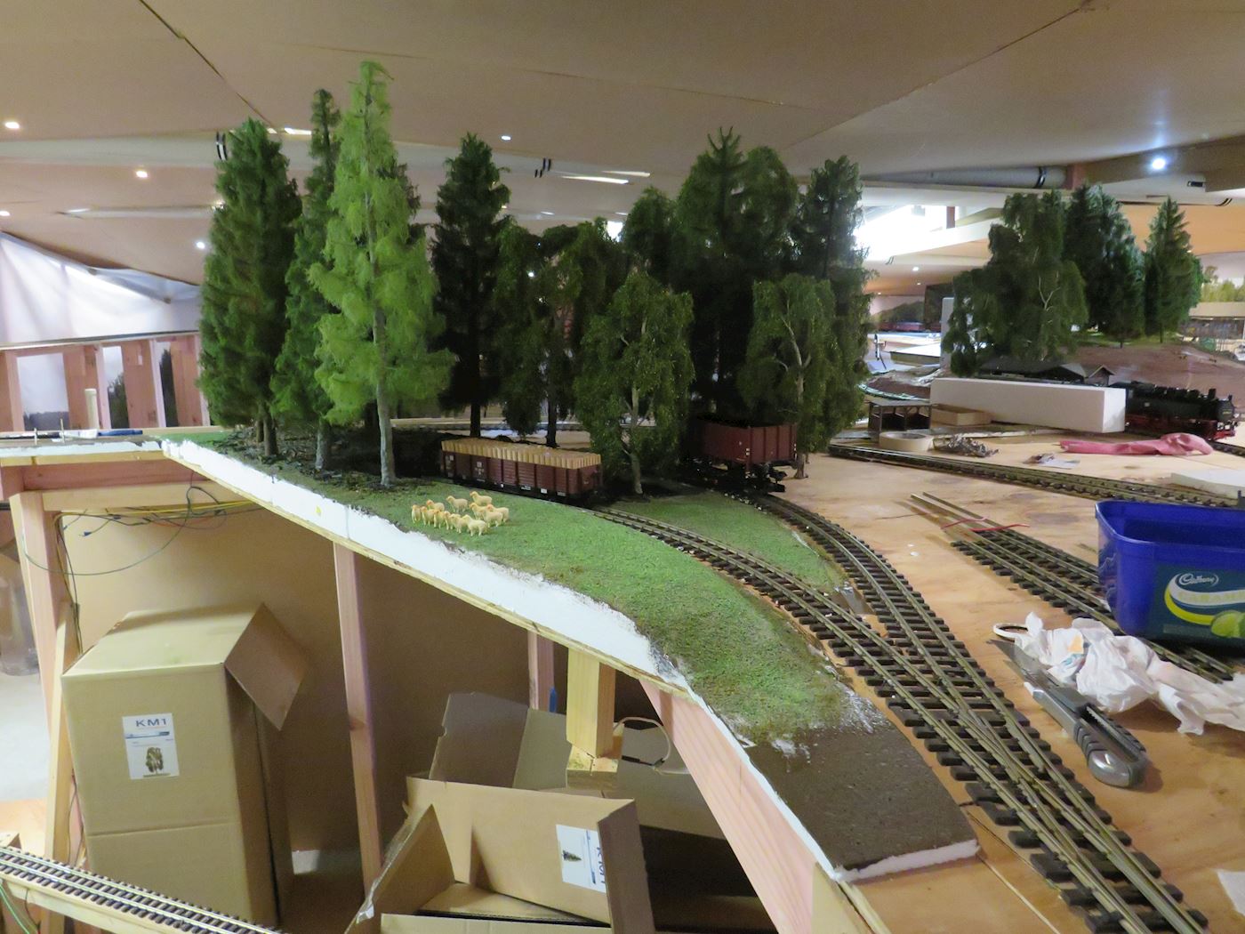

Another productive day on the layout.
The original track plan for the narrow gauge had the line leaving Zittau station and passing under Radeburg to Bertsdorf. It then went either to Oybin or to Jonsdorf and Johstadt. The line under Radeburg never really worked electrically so a decision was made to change the layout to create a loop (Radeburg, Bertsdorf, Jonsdorf, Johstadt) while retaining the point to point nature Zittau, Radeburg, Bertsdorf Oybin/Jonsdorf, Johstadt.
This along with the track realignment between Bertsdorf and Radeburg has taken a lot of time. It is hoped that by the end of the month that the loop track will be up and running. Still on the list of track realignment there is only one road in Bertsdorf that goes to Jonsdorf, so we are investigating replacing the fixed cross over to a pair of points which will open up the three loop roads in Bertsdorf for access to Johsdorf.
We have taken the backdrop behind Oybin down for now so that access can be gained to the standard gauge mainline. A scenic block will be put between the standard and narrow gauge and the backdrop attached to the back wall.
A special one of the layout owner working hard on the brick work for Bertsdorf station.

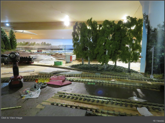

Today was a big day!!!!
Mark has made some more progress on the George Troup memorial bridge. Bridge sleepers are done (3d print) bridge its self painted and weathered.
The Radeburg/Jöhstadt connection is in. Couple of tight spots that may need to be eased, but stock is running through it. Soon to be wired up and trains running
Michael has done some more work on Bertsdorf engine shed

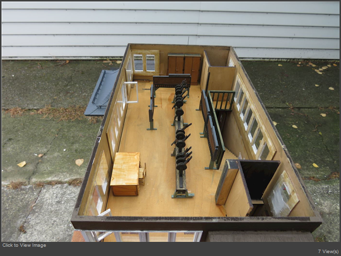

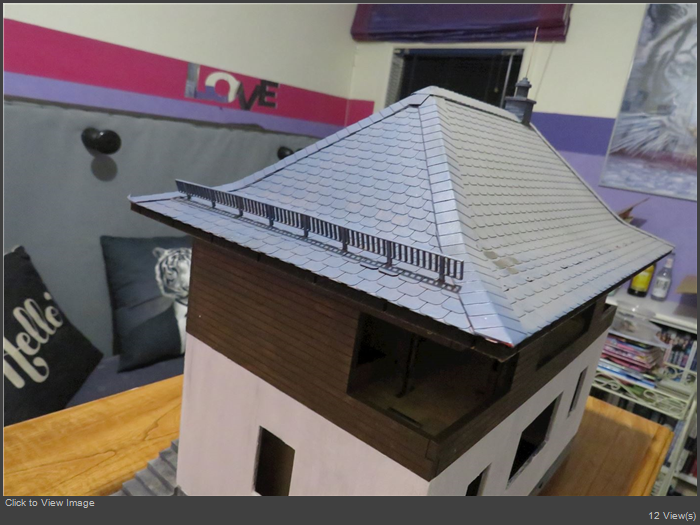

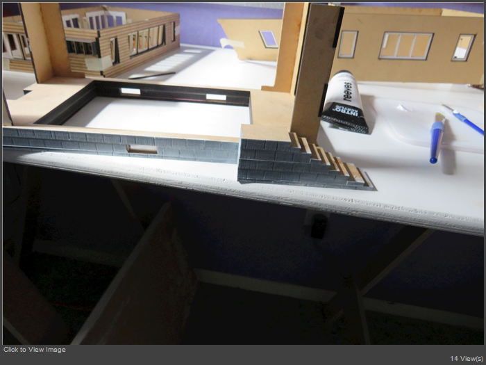

Last night I was given Bertsdorf signal box to paint.
Douglas and Mark decided it would be a good idea to put some interior details into it as well. Very kindly of them!!!!
Prototype picture from Wiki Commons
The Bottom Layer

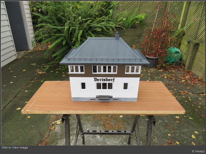

Not to sure about the door colour, but the windows are starting to go in.
Time to mow the lawns, so will think about the colour of the doors

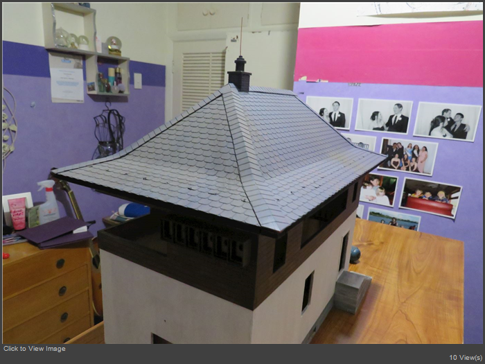

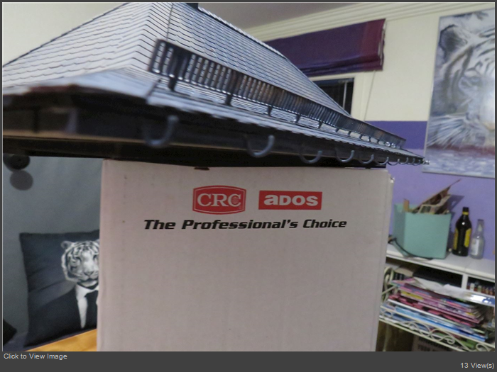

So I am pretty happy with how the Bertsdorf signal box is coming along. The colouring looks good in the natural light.
800px-Bertsdorf-Bf1.jpg IMG_6559.JPG IMG_6576.JPGIMG_6575.JPGIMG_6577.JPGIMG_6578.JPG
It will get a test fit on the layout today, so more pictures later. Some "Round the bays run" is on at the moment so they have shut the roads until lunch time
Lots still to do
  • Glaze windows
  • Finish the roof
  • Guttering
  • Down pipes
  • weathering
  • interior detailing
  • interior lighting

Die Türfarbe ist Grau !
Gruß aus Zittau
Karl-Heinz
*/ Translated...
The door color is gray!
Greetings from Zittau
Karl Heinz

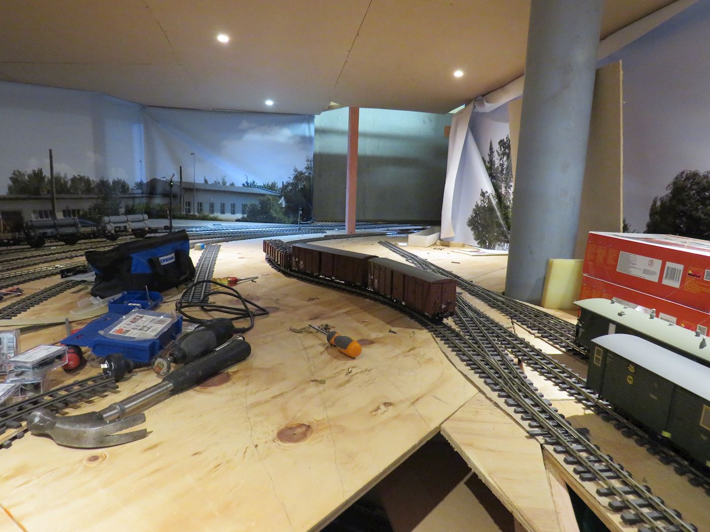

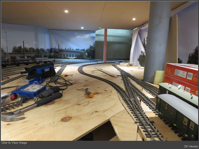

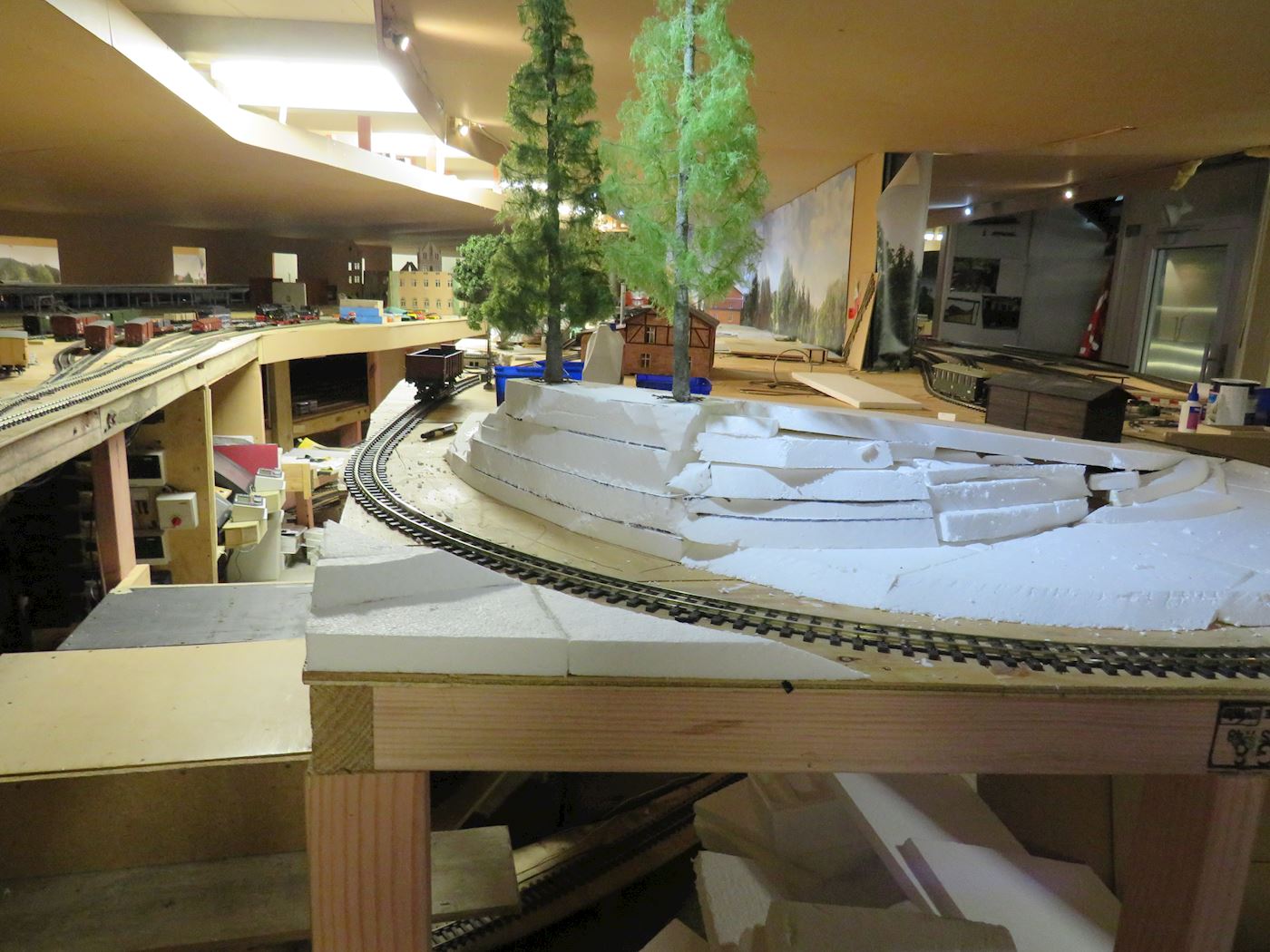

Although on Sunday a big focus was on the running of the trains, some other things have been happening.
Mark relaid the track to create the loop between Jöhstadt and Radeburg
The old alignment had a number of tight spots that derailed the wagons
The new alignment has a gentler curve but has reduced the length of one of the loop roads in Jöhstadt
I started mocking up the road between Jöhstadt and Jonsdorf

Prior to Tim's passing I had started adding details to the Bertsdorf Signal box
The signal box has embossed signage and some thought was put into this. One issue was how to keep it straight when attaching them. I decided to glue them on before cutting them off the sprue.
One issue I came across was that once they were cut off there was a mark on the bottom. Little bit of paint fixes that, but not totally necessary. i suppose.
There are snow guards on the roof, interestingly when they go on they are very soft because of the wet paint. I have used the paint to stick them on, rather than glue. Once the paint dries they straighten up sufficiently to look like they have been used.
The guttering has individual brackets, and while time consuming will look good when finished

Progress continues on the signal box with NZ in lock down
Still some work to do in terms of the guttering, light weathering, and some smaller details, but the building and its interior are now substantially done

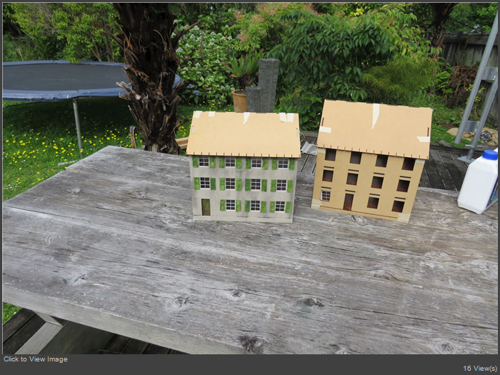

The first step is to disassemble the building, and give it an undercoat of its base colouring.
I decided that with this building, since the blanlk/unwindowed end faces the railway line and is unlikely to be seen, that I would have a raw concrete end as opposed to the white that the rest of the building is going to have.
I have started to test fit it all back together. The building has two floors and a ceiling!!! The front and back door are recessed which requires some internal painting as well
I may or may not put some internal lighting and detailing in it, depends on my level of motivation. Needless to say once the floors are affixed, and the walls go up, there will be no way to add anything!!!!
