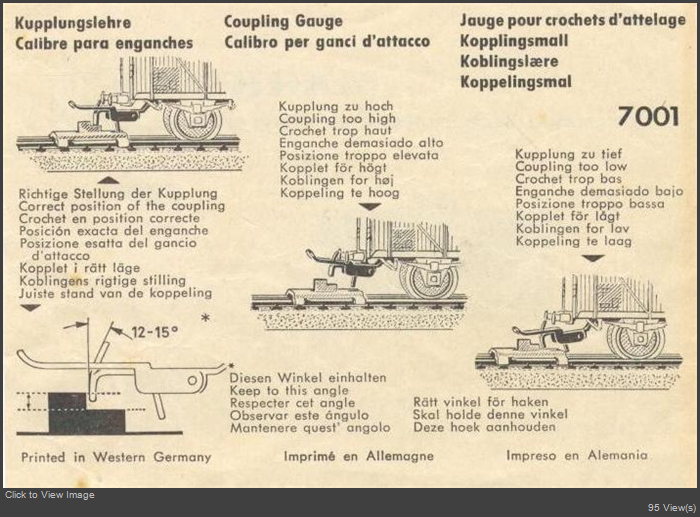

David, it will depend on the type of coupling you are trying to couple to, the close-couplings are more tricky.
However, one thing you can check is that the Loco coupling is adjusted correctly, particularly the height, but also that it pivots smoothly. The black portion of the coupling is somewhat adjustable up and down, but you should use a coupling gauge to be accurate.
Use the gauge to check a few coaches and perhaps some other Loco's with the standard Relex coupler, make sure they are all sitting correctly, then you can try adjusting the V60 (3065?) for a reliable alignment.
Note that any rolling stock with plastic couplings directly mounted on the chassis should not need any adjusting, and there's not much you can do anyway. It's the wagons with metal trucks that seem to become out of alignment more readily.
Here's how to use the gauge (mainly for older models)

I was once sent a 7001 by a retailer that was entirely flat, it had never been stamped into a shape. Of course I sent it back but on reflection I should have kept it, I'm sure it would now fetch millions at auction...

I did a complete audit of all of my coaches and wagons. I found that my Roco wagons and coaches would couple to my V60 but then release after a short distance. I sort of knew this so had ordered some replacement couplers from MSL. What caught me out was that they only had small packets of Relex couplers and a large pack of close couplers. The conversation about Relex hadn't come up here when I was looking so I thought I was doing the right thing in buying two packs. They came today. However, my little V60 will NOT couple to relex couplers no matter how hard I try. I bought some Marklin wagons recently from a friend here on the forum. These wagons couple perfectly with the V60. Here are a couple of images:
A relex coupler on a Roco 4 wheeled coach:
Relex
Here is the standard coupler on my recently purchased wagon:
Standard
Are the standard ones "close couplers"?
Can anyone tell me the Marklin codes for the correct couplers?
Long Haired David
AKA David Pennington
A mystified Maerklin Newbie
Offline Copenhagen
#25 Posted : 27 January 2020 19:44:30(UTC)
Copenhagen
Joined: 23/04/2019(UTC)
Posts: 548
Location: Copenhagen, Denmark
The bottom picture shows close couplers.
https://www.maerklin.de/...ts/details/article/7203/
Offline mbarreto
#26 Posted : 27 January 2020 22:02:36(UTC)
mbarreto
Joined: 18/02/2008(UTC)
Posts: 1,343
From a 70ies catalogue:
The Relex is designed to provide "delayed action uncoupling". This permits you to push the cars after uncoupling without the couplers closing again.
It means both, the so called standard coupler (the one in the top photo) and the close coupler, are Relex due to the above mentioned capability.
Some confusion may come from the fact that the almost all current coaches and wagons (exception to the StartUp range) come with the close coupler 7203. For this reason one maybe tempted to call the 7203 as "standard", but when people refers to standard coupler or Relex coupler usually are refering to the older not so short coupler (the one of your top picture).
