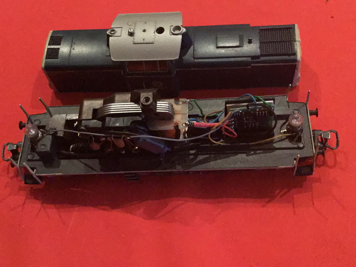

I need your help one more time. I purchased an old Marklin 3147 Locomotive as being digital. I have a mobile station 2 and it is unable to automatically find the loco. I tried then through the database list and 3147 doesn't seem to exist.
Then i tried manually by choosing all the addresses from 1 to 80, and again, the loco is not recognise. The loco turns the front light on, when the MBS2 is finding it, sometimes the lights blink, and some times I can hear a very low and quick sound from the engine, but the Loco never moves.
Am I doing something wrong?
I opened the loco and I can't see any dip switches. I took a photo, could you please let me know if it could be digital?
Thank you,
Paulo

Hi, unfortunately your picture of the decoder (?) is not very clear, but if it is actually a decoder I would guess that it could be one from Uhlenbrock like in this Stummi-Forum thread:
https://www.stummiforum.de/viewtopic.php?t=143431
The 3147 was produced quite a long time ago, and the early models were not yet equipped for digital operation.

Paulo this locomotive has been converted from its original (Analog) to Digital. Simple way to find the address as you do not have the equipment to find the address electronically is to just go through all the address namely from 1 to 80 individually. Its tedious but you will get hopefully a result.From the picture that looks like one of Marklin's FX bottom of the range decoders fitted to "hobby line" locos. Pity the last owner did not tell you what the address was.

It has a large capacitor attached to the decoder, which looks like it is being used as a keep alive capacitor. This could be stopping the controller identifying the address automatically.

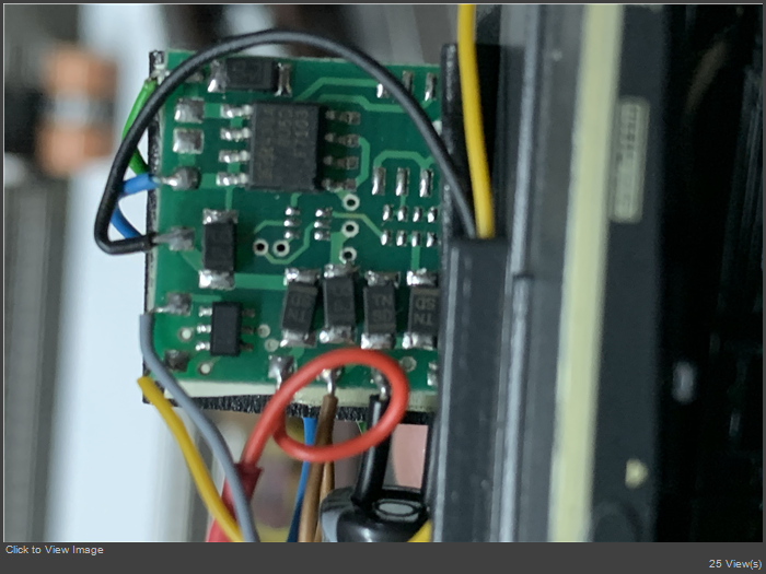

thank you for your answers, In fact I tried 1 to 80 in DCC, should I try the other ones? I think is MM2 Programable and MM2 Switches.
I don't have the original box, so I'm not bale to check it.
I opened the loco again and I took a more detailed picture.
What for me is weird is that the Loco doesn't move at all, when I place some other Delta Locos in the track, and they are in analog mode, the locos start running like hell. This one doesn't move, only turns the lights on.
The detailed picture:
#9 Posted : 24 December 2019 20:00:39(UTC)
Posts: 9,300
You did bought this loco as second hand but did you know if the loco does work before you did bought it??
It seems fault decoder and i cannot identification decoder in the pictures.
I recommended you buy a new decoder from Märklin or ESU lokpilot.
By the way...what kind of motor is it?

I believe you have a LD-W-3 decoder from Tams Elektronik GmbH (tams-online.de)
Try to reset and reprogram the decoder according to the manual:
https://tams-online.de/epages/642f1858-c39b-4b7d-af86-f6a1feaca0e4.sf/de_DE/?ObjectPath=/Shops/642f1858-c39b-4b7d-af86-f6a1feaca0e4/Categories/Download1/Anleitungen_fruehere_Produkte/Lokdecoder
try that, before you start replacing the decoder. If you need a new decoder you can start looking at this simple option, 60906. several makers have more advanced ones with sound etc. Its quite doable if you have some soldering skills.

Bph gave you a link already; but here's a link directly to the relevant manual: https://tams-online.de/W...003_LD-G-3_LD-W-3_GB.pdf
Start on page 35; which will tell you to read on page 33 RollEyes Confused Blink

There's a small chance you can run your loco, if you try this, and then find the right address:
1: Do a factory reset on your MS2
2: Enable only MM2 / disable DCC and MFX
3: Find an old loco in the loco list, e.g. 3618
4: Try all addresses from 1 to 80 by changing the address of the 3618 in the MS2
This is not programming your loco to any other address; but hopefully finding the address used by the previous owner.
If this doesn't work, I have no more ideas; maybe others here can help.
