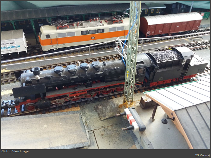

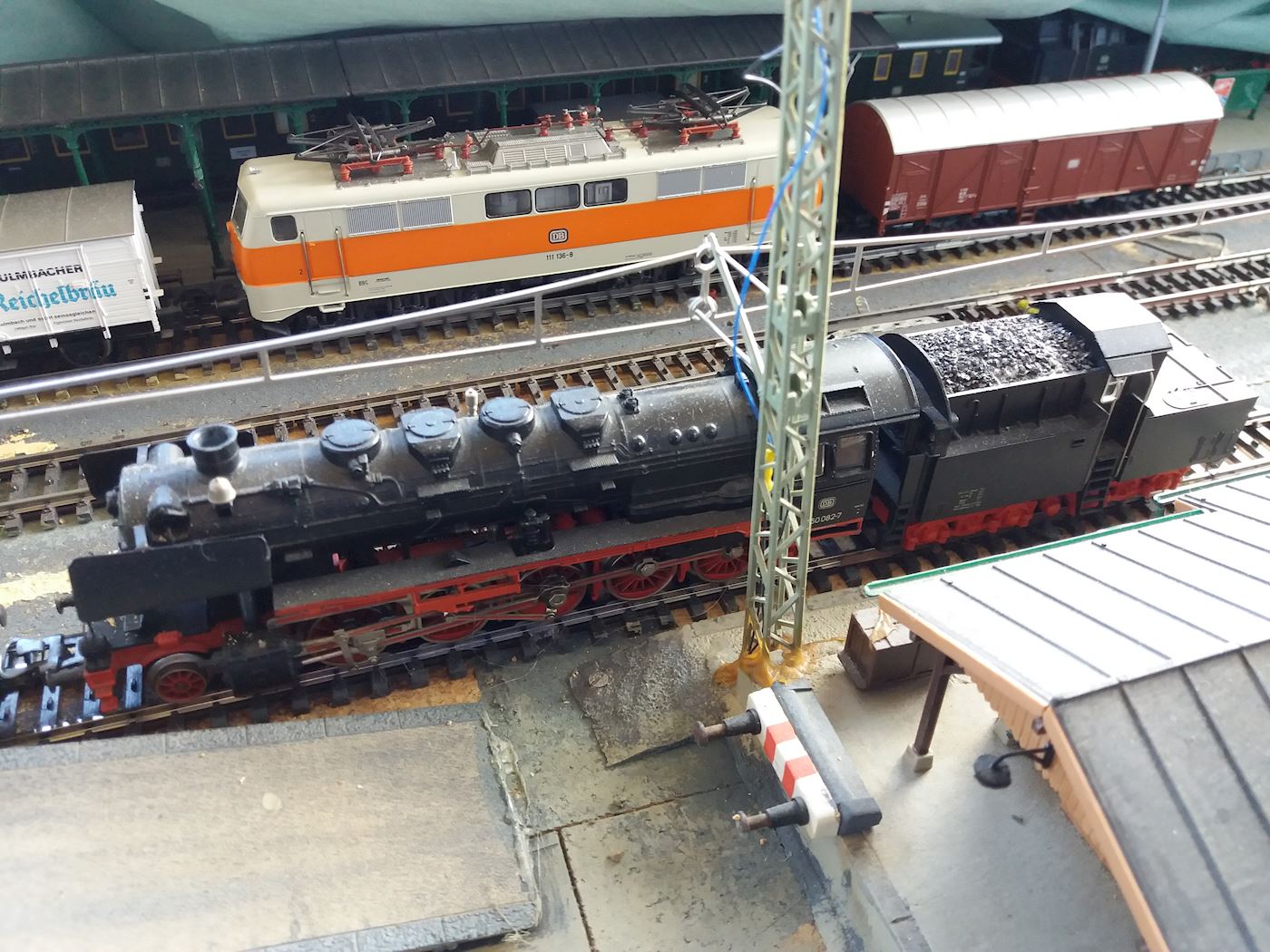

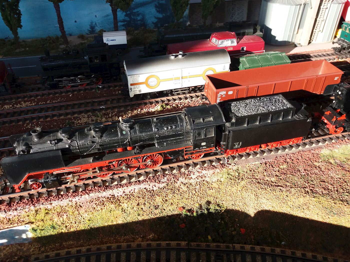

I did it in the past, I used basically the same method as you, diluted white glue, and real pulverized coal, I think it was from a Spanish brand Aneste, but it will be worth any brand, I gave a layer of white glue over the simulated coal of the tender, I put the real coal, and then with a syringe I poured the glue diluted with water and a few drops of dishwasher on the real coal, and that's it.
I did it in 2 or 3 locomotives, in the first one I liked the result a lot, in the second not so much and I liked it less in the third one, so I didn't do it again.
I show you some photos of one of them, I don't remember if the 2nd or 3rd, the märklin 3684

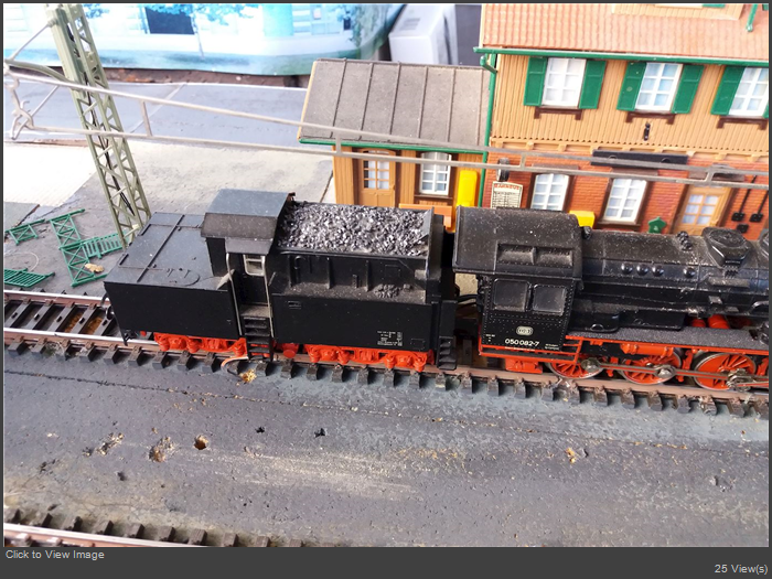

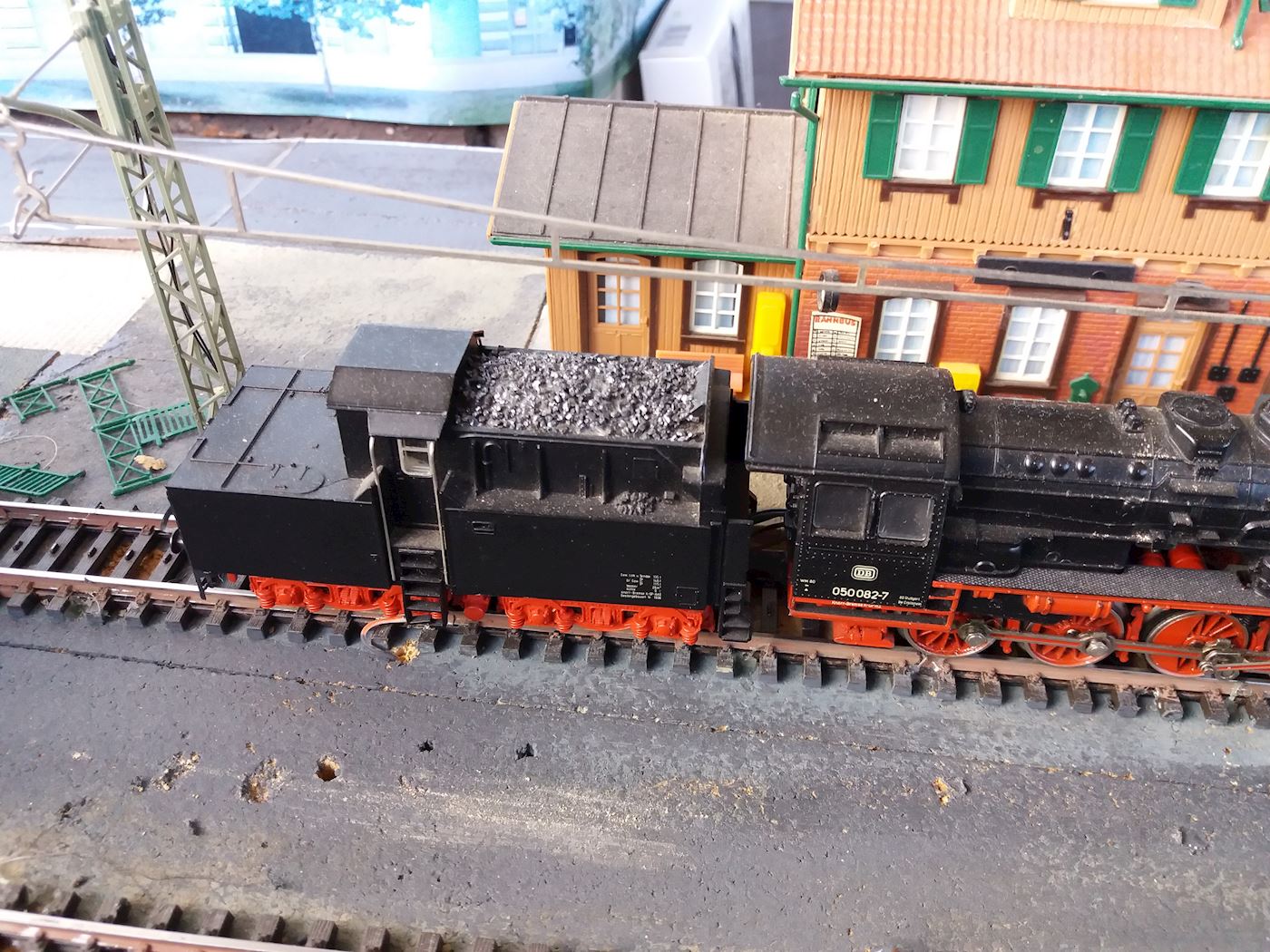

Hello
This is a BR 41 märklín 3082 with real coal on tender

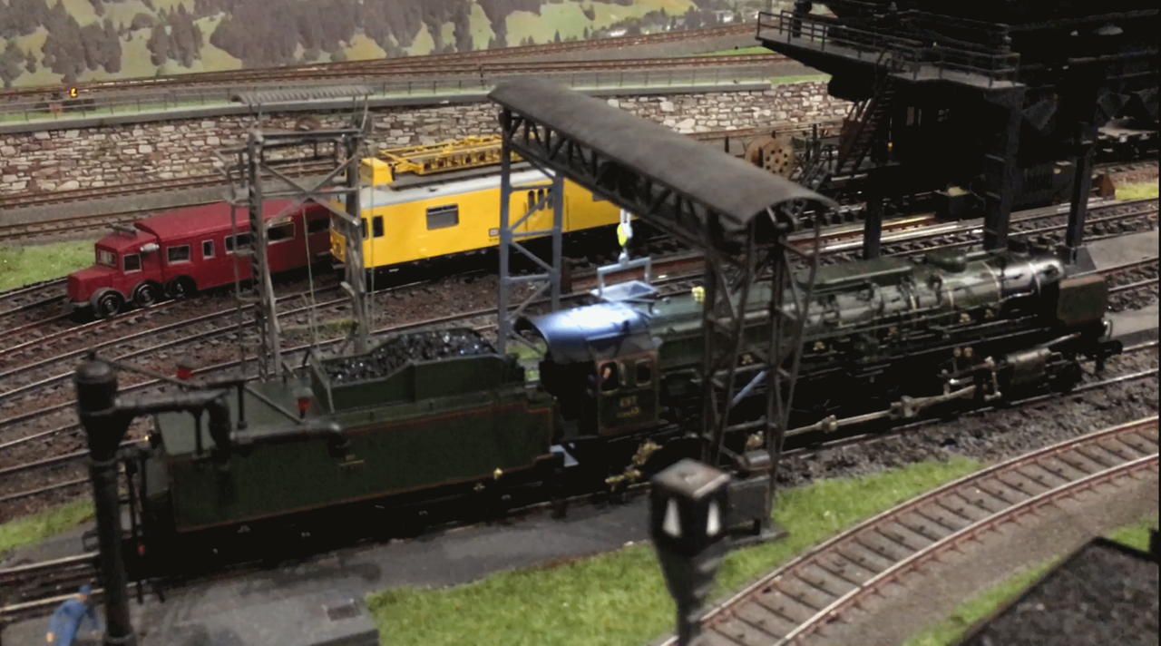

#15 Posted : 16 December 2019 18:08:13(UTC)
Posts: 3,571
Some of Märklin reproduction of coal is poor so like some of you I glued (using white glue and coal-like black crystals to improve it).
On latest metal tenders the coal bunker is plastic and removable, so it is better to remove it before the "operation"
Here the result on my latest steamer
Sorry for the poor quality picture. It is extracted from one of my movies
