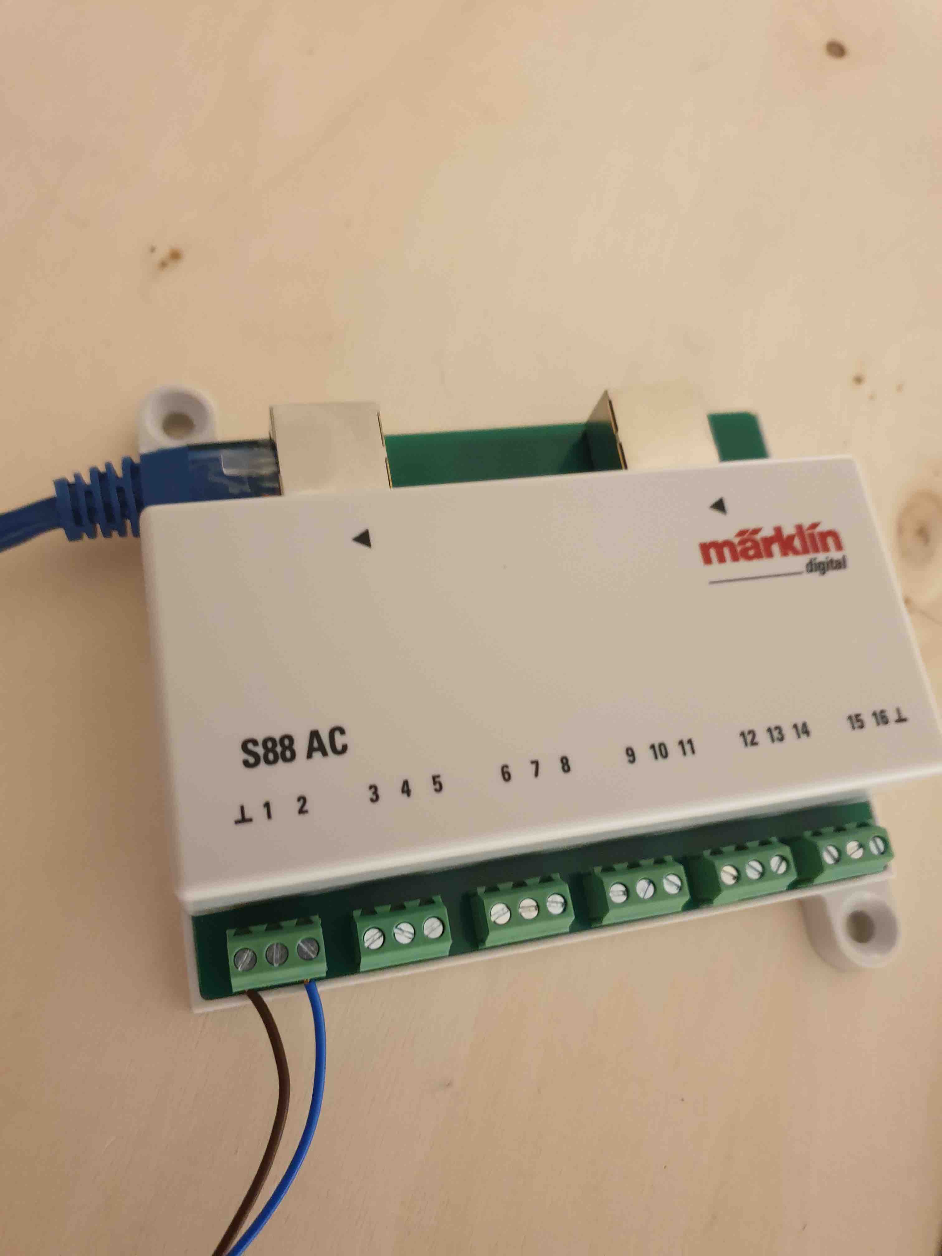

I am new to this and thought I bought the "easy" way out Confused

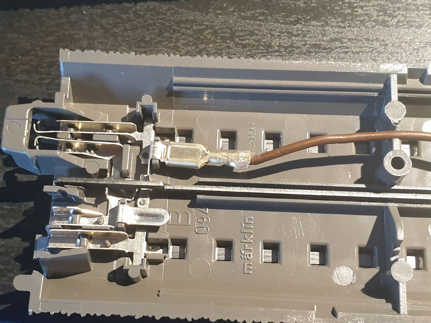

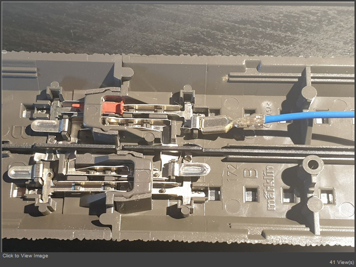

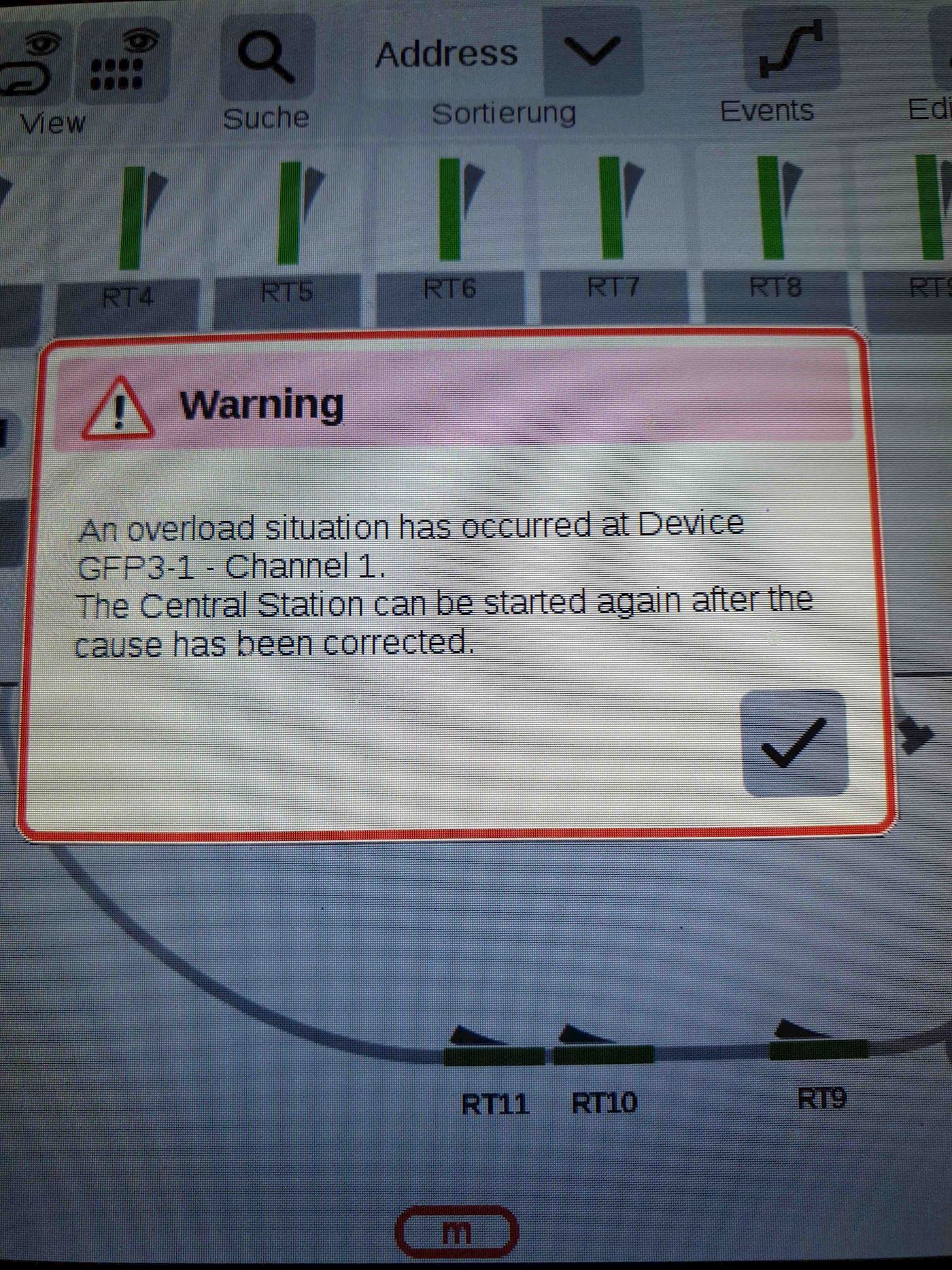

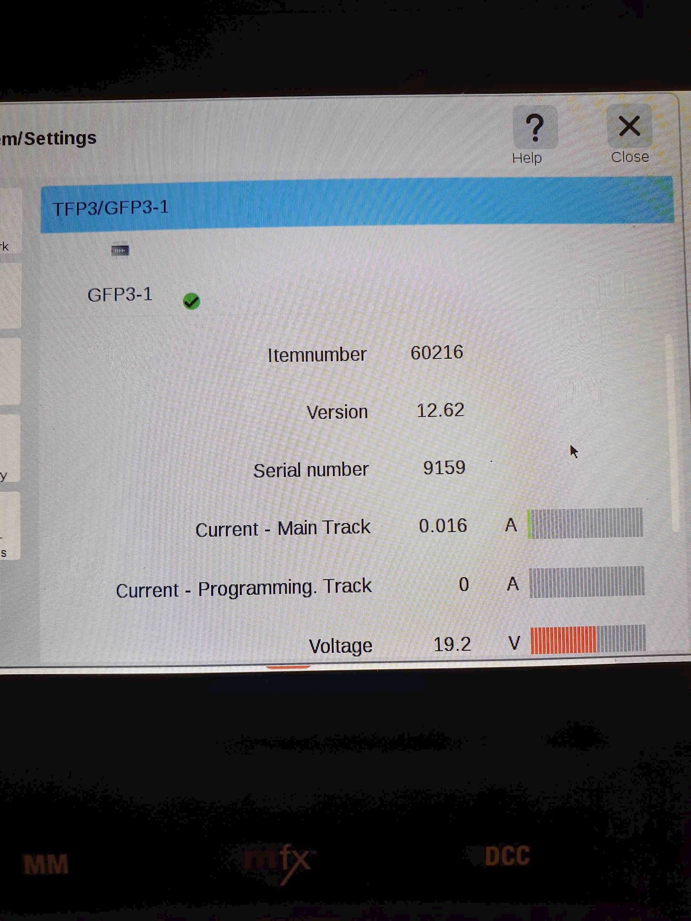

when a wagon crosses the 24995 contact track I hear 3 clicks and then the Warning pops up on the display.
A train just stop and I hear the same three clicks and the same warning pops up on the display.
My CS3+ is updated and there are no red marks.
The S88 AC has one brown cable connected to 0 on the track (outside of the contact track area) and ground on the decoder.
The blue cable is connected to contact no 2 on the decoder and the 0 on the contact track (the middle one between both 24995), and that track is cut and isolated.
The S88 AC is connected to the underside of the CS3+. (no link should be necessary)

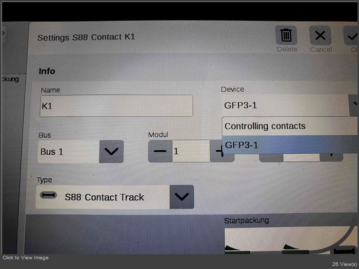

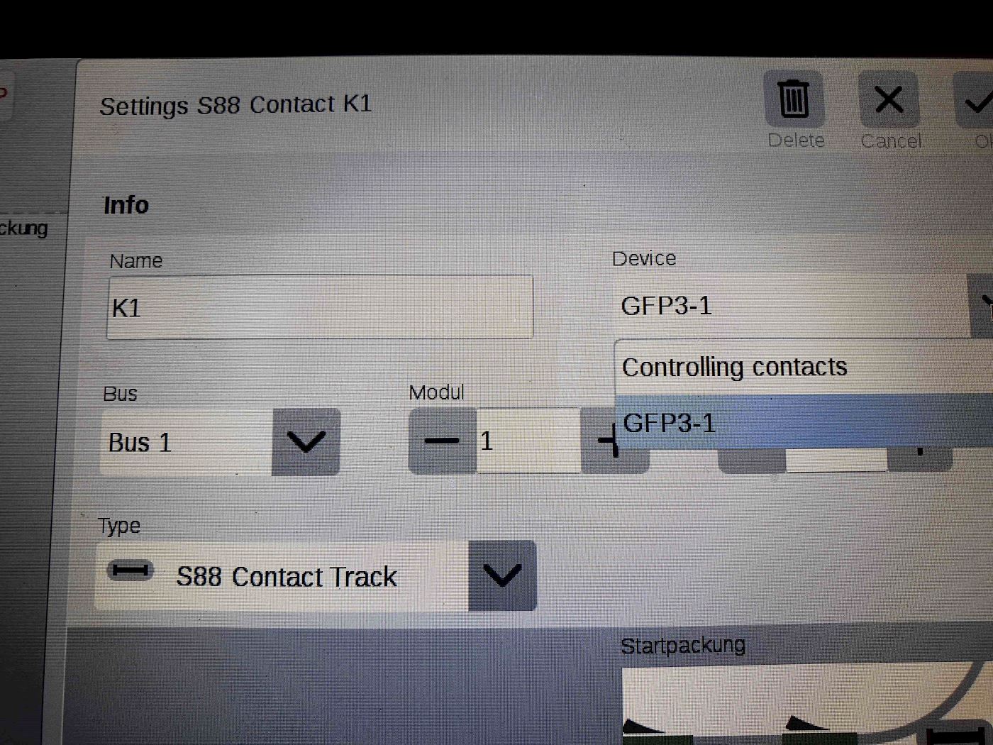

In the setup display for the S88 Contact track - I can choose between device Controlling Contacts or GFP3-1 (neither works)
Only one bus1 (no choice)
I have now used 3 days, evenings and nights to google, read here in the forum and looked at various clips on YouTube, and still I have not found the solution.
I have no clue how to move on to make this work and would appreciate help from You guys.
Nils

S88 AC are feedback decoder designed to be connected to L88 (60883).
Voltage is supplied to the S88 by means of L88.
You need power pack for the L88 too!
Opsss...you have CS3+. Blushing
I was thinking about 60226 CS3.

Have you tried to write another name in the device?
For exemple LinkS88-1?
#6 Posted : 30 November 2019 10:15:07(UTC)
Views messages in topic : 9,332

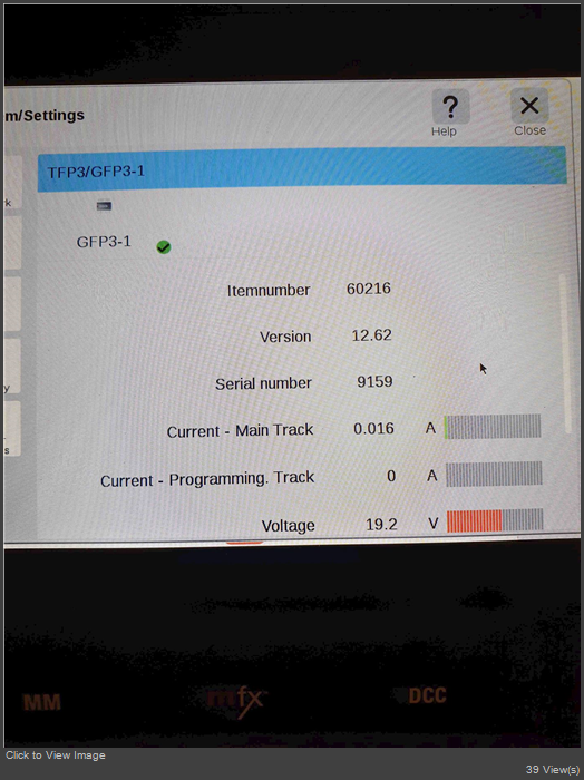

Another question:
How did you set LinkS88 in the system settings?

I have no Link, and what I have read I don't need one, and there is not possible to set up as link.
regarding the name K1 - I have changed it, but it do not solve the problem.

I would say the problem is with the contact track which might be causing a short. Just a guess.

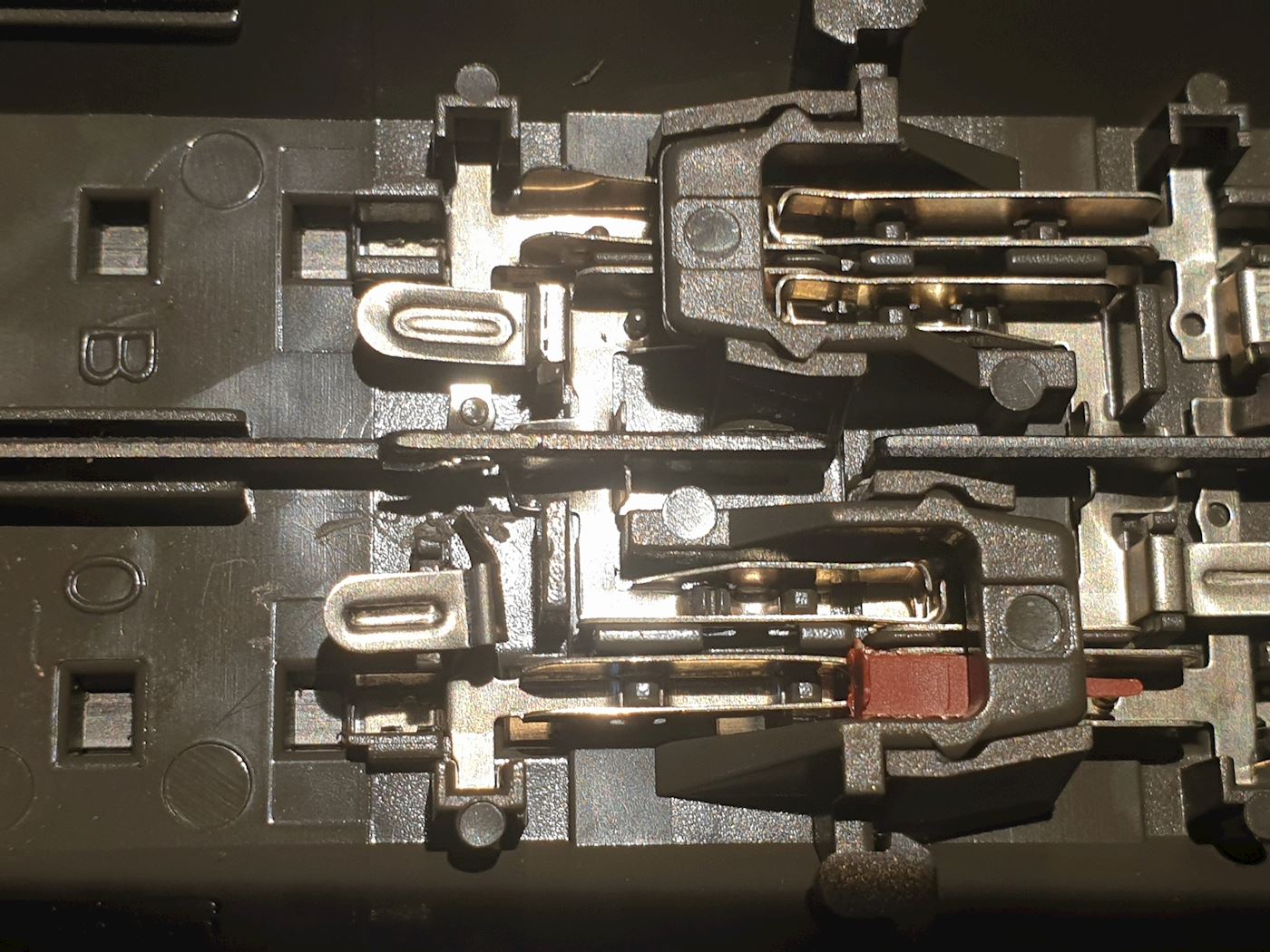

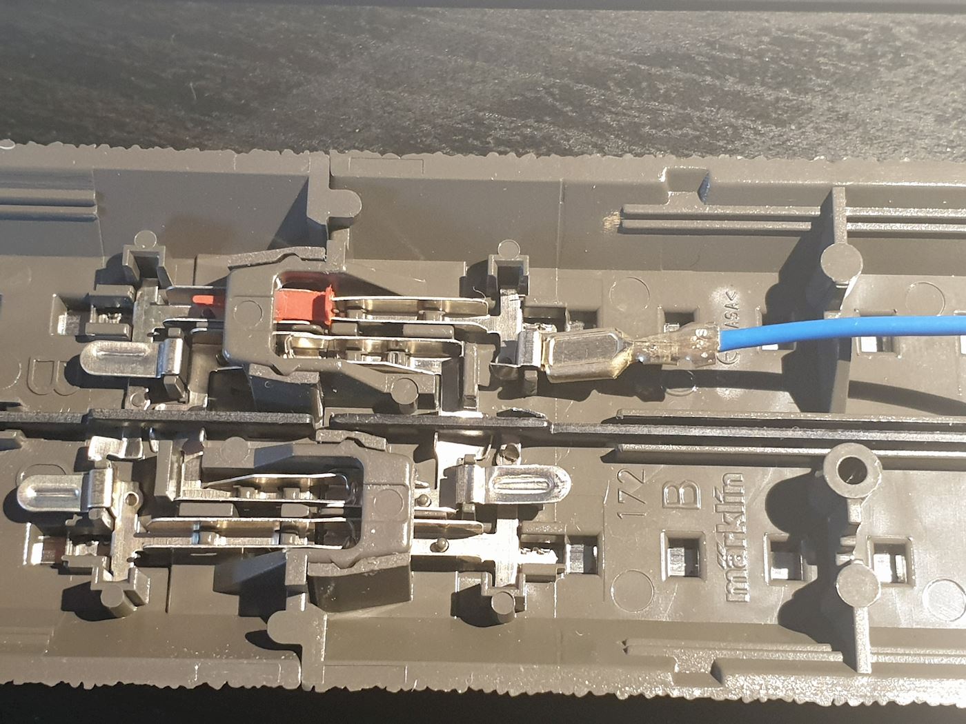

Here are my connections - new contact track made, but same miserable result.
still the same 3 clicks before the warning pop up.
Confused

First thing is remove the contact track and just make momentary connection between your brown and blue wires. It will let you know if the S88 is working ok in the system.
About your question on he signal, is it depends on what you want to do. The contact track is just for detection of a train. You will need other device, like a home signal for example, to create a block.
Anyway you must make the S88 work ok.

For the short
In your first two picture (post #11) the cut tab has been folded and is touching the stud rail
Offline nkd1969

P.S. if the 2nd image of post #11 is the other end of the same piece of track in picture 1 , then you have the insulator on the wrong side
Also BOTH your insulators are upside down.
The purpose of the protruding tab is to separate the pieces of track a fraction so the the actual rails do not touch.
In general I have found the track manufactured to good tolerances and may not need this, however there is a risk if , for example, your tracklaying kinks upward (into an incline), or you screwed track to tightly when it was cold.
Thank You very much for all the help.
Ive changed the contact area and pushed the clipped part down and changed the isolator to the other side on the next track.
This have solved a lot but it is not complete yet.
The warning for the S88AC is not popping up anymore, and when I use a railcar on it it works and gets yellow in the track plan. BigGrin
I finally got it to work. Finally a breakthrough BigGrin
Confused
I think so too, you got a short. Why are you connecting the brown and the blue cable with 0 (as shown in your pictures), which is the mass? The brown cable is for the mass contacts. In my opinion the blue has to be connecten with B. B = Bahnstrom = traction current.
https://static.maerklin....32d591f8271572012973.pdf
http://www.dieter-muc.de...elfarben/kabelfarben.jpg
Offline nkd1969
#26 Posted : 01 December 2019 21:13:30(UTC)
nkd1969
Joined: 07/02/2019(UTC)
Posts: 14
Location: Oslo
Thank You
i will try again and start from scratch with a new track.
Nils
Confused
Hello again.
I did IT like that because this is what i see in the video from maerklin.
Mearklin 24995
At 3:55 in the video.
But IT works now... BigGrin
Thank You again.
You have forgotten the other picture right at the top where he shows the s88. The blue cable goes to input 2 on the s88.
#28 Posted : 02 December 2019 01:01:26(UTC)
Posts: 3,533
It's not the colors of the wires being in a way you don't understand that's making a short. Cool
Even though you've now posted PDFs to "Märklin standard wire colors" a zillion times, there's still people in this world
using different colors, and yet they can have a working layout and trains running without problems............. LOL
Nils have found and removed the short, it was not the wires or the wire colors causing it. Laugh
Offline TEEWolf
#29 Posted : 02 December 2019 01:11:44(UTC)
You are right, indeed I did. I was so often wrong by using blue cables, so I started only using grey cables for this connection. But it looks like, I am still thinking in the wrong way.
