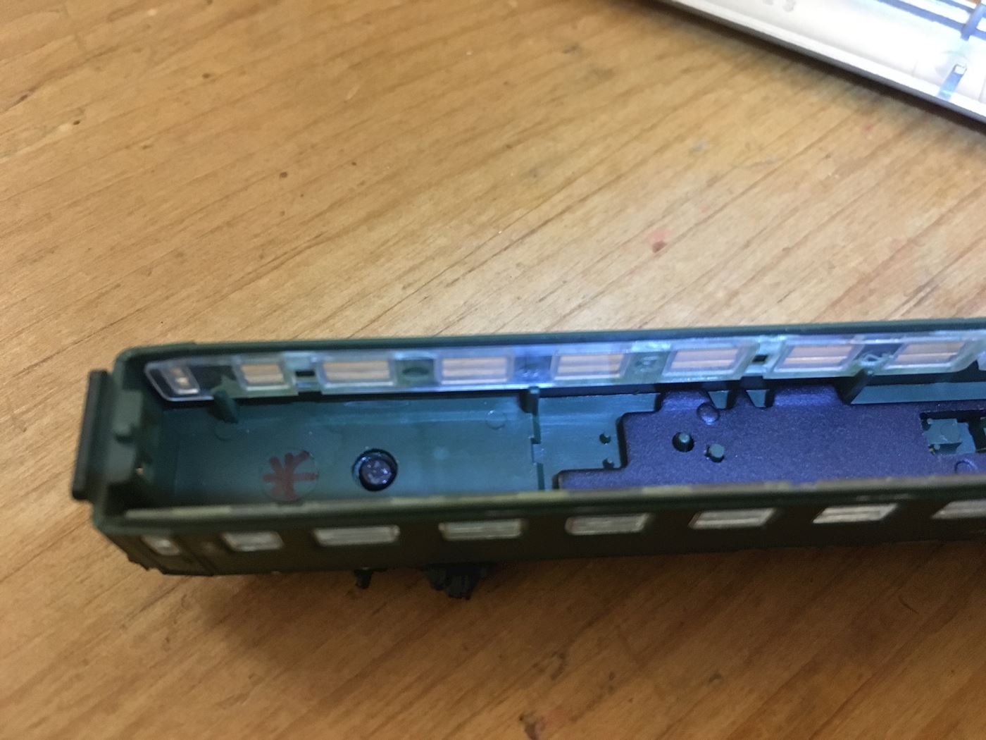

For the benefit of anyone else who finds themselves in the same predicament, I'll answer my own question.
The inside of the coach looks like this
Using my usual "brute force and ignorance" approach, I found that the bogie can be removed simply by pushing down on the black "pip"
Once off, I found that the metal plate that holds the coupling in place was loose at one of the plastic rivets. I held the plate down whilst melting the rivet a bit more and now all seems to be well. I'm not really sure why this has cured the problem but the plate does extend under the pivot of the bogie, so I think it must have been forcing the bogie not to sit flat.
Hope this turns out to be helpful to someone at some point.

Apologies for the poor picture quality, but I think you can make out the important details from this picture.
This is a different bogie from the one I dealt with last night (I didn't want to risk undoing whatever I had done yesterday). I noticed, though that the metal plate isn't clinched tightly under the rivet I point out and you can see the plate slope up away from the coupling. This tends to suggest that it was something else I did last night that got the coach running nicely and that clinching the plate more tightly under the rivet was not necessary.
In answer to TEEWolf's question, there is nothing to see on the underside of the bogie. The post with the retaining "pip" at the top is moulded into the bogie.
Hope this is of help
Chris

Sorry I dropped the ball on this one.
On these coaches, actually , all you need is to insert a little screw driver between chassis and bogie, and twist .
Otherwise you have done exactly what was needed to correct the problem of the interfereing spring plate.
Happy Z-training!
