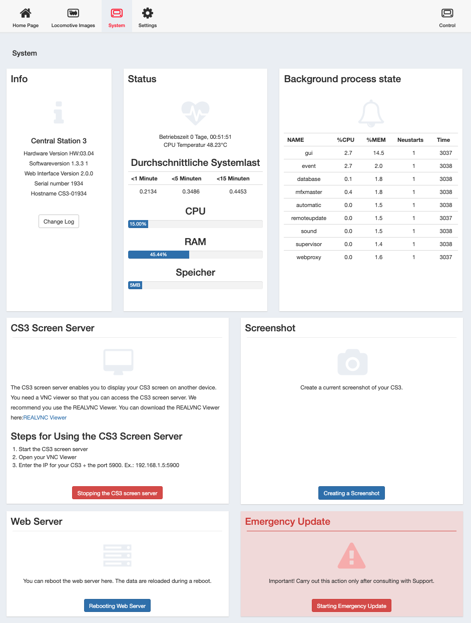

Yes, I should have included VNC server when asking about the web server; they are not one and the same thing and my thinking wasn't sufficiently precise. On my CS3 I don't see any button or menu to start the VNC server, but I didn't realize (or remember) I had to connect directly to the web server and perform this function. I started the VNC server and all is very well in my world.
Regarding how to configure the CS3 to start the VNC server automatically, there isn't any method I can find directly on the CS3 itself nor through the web interface - when trying x.x.x.x/vnc/status or x.x.x.x/vnc/config, I get 'page not found'. I'm concluding we have different s/w versions or something else is different with my CS3's web server. I did just install the very latest update, 1.3.3 1, and the web server is version 2.0.0. I included a screenshot. For the heck of it, I tried different browsers and from a Mac and PC, but no differences.

Many months ago when I had the VNC server-viewer working correctly, I could not control the CS3 through the browser, it was necessary to use the VNC viewer. With this most recent update to the CS3 that I installed yesterday and when connecting to the CS3 via its IP address, I noticed a "Control" button on the far right of the main page - you can see that on the screen shot image I included. Clicking on that, I am able to completely control the CS3 directly from the browser. I may be wrong but I don't recall this being available before. Thus, I conclude, VNC viewer is not needed. Apologies if this is already widely known and I am just discovering it.

Yes, you have an old version of firmware on your CS3
No, the Control (Web App for operating a CS3) does not total supplant the VNC capability
