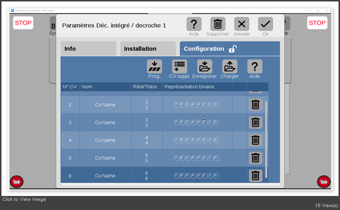

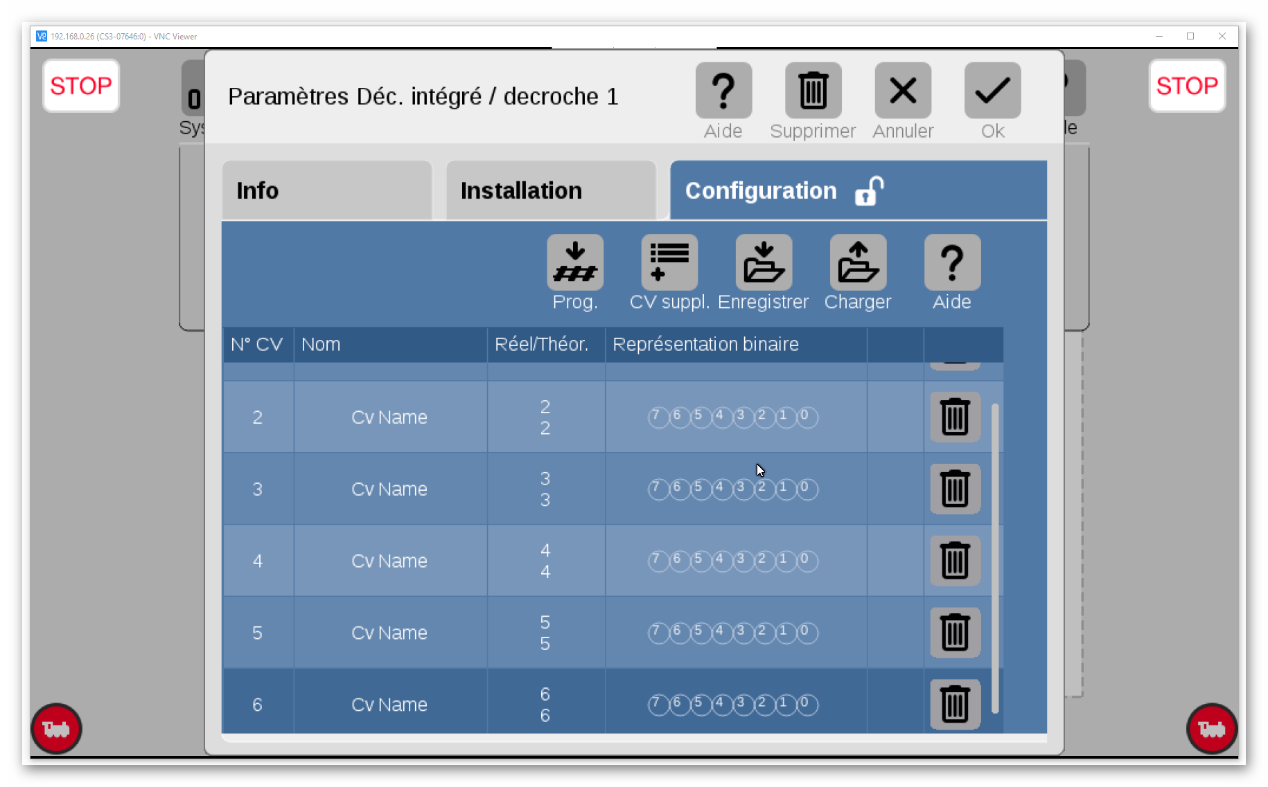

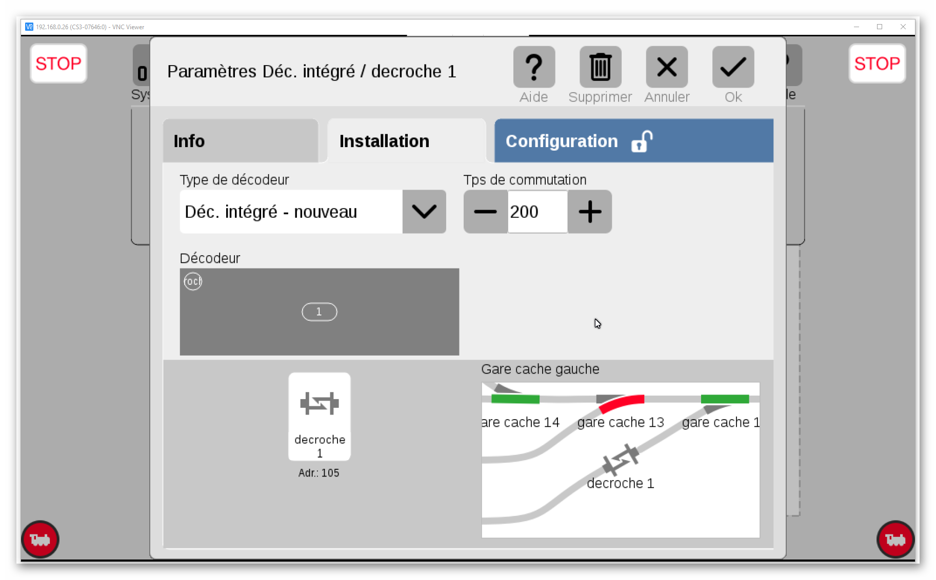

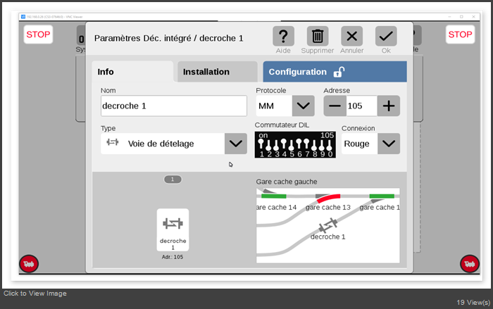

I am new into the miniture world of train, I am trying to set up some uncoupler with a M83 decoder and a CS3 using MM not DCC, when I do a FMX search, it does find the turnout tracks, but not the Uncoupler Track. I tried to set them manually, but it does not seems to work. You can see the picture below of the set up. If someone could help me to solve this little problem.

I am not sure how similar the M83 and M84 are but this is how I was able to connect the uncoupler track symbol to my CS3+ https://www.marklin-user...652-m84-screen-questions
Thanks, I got it to work. But I take all the help I can get... all that stuff is pretty new to me.
