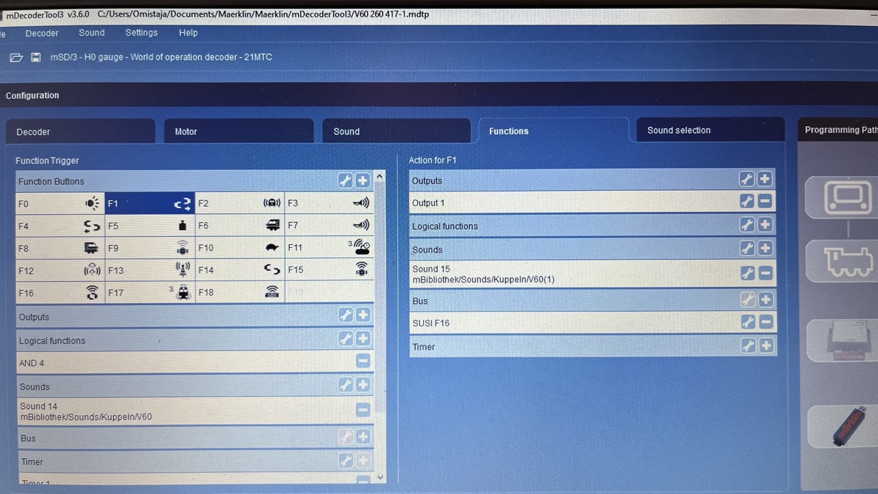

Hi again Jean and others,
Can you please verify that my settings in mDT are correct, please see the images below?
I've entered the value 8 to the turn of delay. What should the dimmer value be and what is the period field about?
Also, should the function be switching or momentary?
Thanks,
-Eino
EDIT: Figured out something myself and edited images.
#19 Posted : 18 July 2023 12:33:12(UTC)
Posts: 3,688
Hi Eino
It looks good: one Telex per AUX, settings as a Telex, max turn off 8 seconds
Just, when finisted, verifyr, when turning on one of the Telexes, it goes off under less than 10 S
Usually I do all this on my CS2 or CS3 because it is immediate (fonction mapping)

So the mobadapter NEM pockets and the Telexes fi ally arrived and are now installed in this old V60.
They work. However I was foolish enough to think that they work with relex too. Damn. Guess I’ll be looking to replace relex with SC, but on many wagons, it can’t be done. Or is there a hack/fix for this?
Strange thing with the mDT setup though... The coupling sound is played when I activate the telex and then the function stays on. Telex does shut down as supposed, but I then have to activate the function again to ”turn it off”, and it plays the sound second time… I wonder what I did wrong.
The decoder is the 8-pin version as the V60 would not fit 21pin mtc. So no way of getting it attached to the decoder programmer anymore… Guess I need to find someone with CS3 in my area.
-Eino
#24 Posted : 04 August 2023 16:32:22(UTC)
Posts: 3,688
Hi Eino
When installing a Telex (E117993) on a loco fitted with mSD3, mSD2, mLD3, mLD2:
- configure the AUX as Telex or as Dimmer (set to max)
- dont forget to make it a timed fonction, shutting itself OFF after 9 seconds AND VERIFY IT DOES SHUTS OFF.
- even with MDT always verify the mapping of things (often in correct on M projects
Hi, yes I’ve done that, but now that I try the loco, the telex works as supposed, but the function is left on. I need to turn the function off before I the telex will work again. Sound is played on both times, when turning it on (telex triggers) and when turning off.
Thanks!
