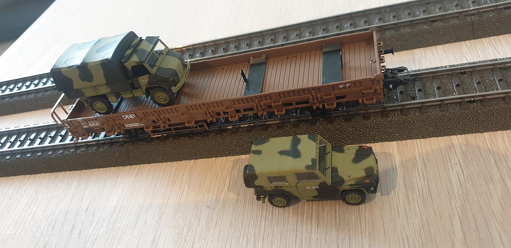

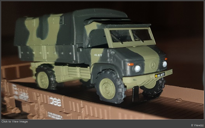

I purchased the Märklin 46934 "Military Transport" Low Side Car Set that just became available.
The set consists of four M113 APCs, one truck and one jeep.
My question is, how do I prevent the cargo from rolling back and forth?

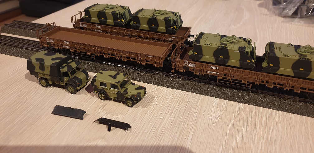

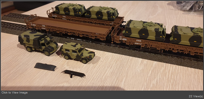

The set did come with a few parts that you can attach and also with instructions on where they go. Each car also came with four black metal thingies (without instructions) that I guess is meant to prevent the cargo from rolling but I haven't quite figured out how they are supposed to be fitted.
I've added two pictures with two of said metal thingies in the front in one of the pictures. Anyone have any tips on how this is supposed to work?

The metal things are chocks which go behind and in front of any wheel to hold the vehicle in place on the flatbed. I recently bought a set which included a truck and a flatbed and it had two of those and I finally saw the same set online with the chocks in place. Would have been nice if Marklin had included a picture with them in place.
Thanks for your reply!
So something like this then?
For some reason I thought the chocks were supposed to be 90 degress from what they are on the picture and the center metal stud was meant to attach to the flat bed in some way.RollEyes

The chock to the right in your picture is the only one I have and the way it is sitting in the picture is the way I think it is supposed to sit on the flatbed. That way the small leg hits the groove in the flatbed and keeps it from moving. I put the larger section against the wheel and the small leg away from the wheel. Not sure about the metal piece on the left. Does it still slide around the way you installed it? If not I would try installing it so that it makes a triangle on the flatbed, if possible, the same way the other chock sits in your picture.

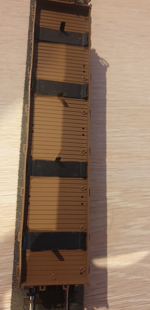

Well after learning that it was called chocks (not metal thingies Smile ), it was easier to google. I found some sets with similar chocks and also some youtube videos with the same sets running and there was no visible chocks. I also found some pictures of chocks that looked more prototypical so my guess is that the ones that I have are not meant to be very visible.
So far it doesn't seem to slide around so I think I'm going to keep it like this.
My only issue is that it seems to be pushing out the walls of the flatbed a little. That can be fixed with adjusting the "wings" of the chocks but it also means that the tension is high enough so it doesn't move around.

Hi, good man, you have correctly installed the "chocks" on the low sided wagon.
You can play around with the Mil trucks, and see if you place them right over the upright pin so that it may prevent any movement of the truck. Then you will be using only one chock per truck and the wheels will stand the loading surface of the wagon and not on the angled surface of the chock.
But for me, more importantly is the bulging of the side wall of the wagon. Leaving the chocks in position for a long time you will find that the wagon wall stays distorted. That I do not like at all.
So I bend the chock's dual pins more inward and then I use a very small amount of putty/press stick to hold it in position on the wagon's loading area. No damage at all.

This is what I ended up doing. Took a couple of tries to get it right, it was either to much pressure or to little but it is possible. The M113's doesn't have any wheels that will make them roll back and forth so I'm not going to use the chocks on them.
