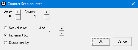

I just added a new feature to the RemoteSign Sequencer...
It now has 9 general purpose counters! These can be set, incremented, or decremented as needed and then also sent to any RemoteSign using a new Counter macro!
I plan on making up a sample file to show how they can be used to simulate train axle counters that were used to compare the number of axles coming into a block of track, to the count of axles going out...

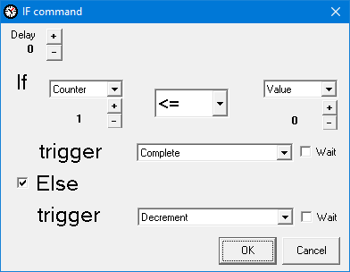

I had to do it.......
Today I implemented conditional branching in RemoteSign Sequencer!
What that means is, scripts can include If statements that can branch to other scripts based on the values of counters!
Using this feature one can, for example, make an axle counter display automatically reset itself if the two counters match each other!
The sample file that displays two counters on a single display has been updated to take advantage of this new feature...
