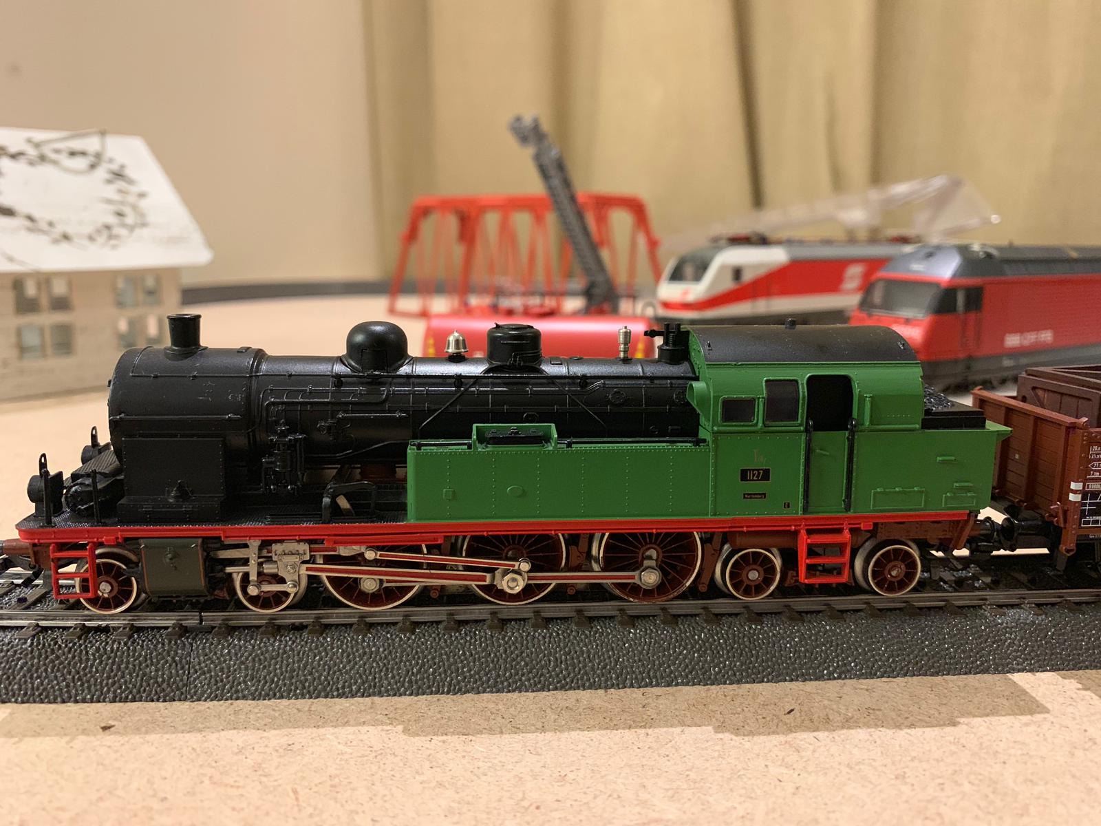

I recently bought a used digital steam engine ( MARKLIN 3607 / Wurtt T 18 ) over eBay. Seller claimed the unit in perfect working condition. Manual shows loco address as 19. I have a digital setup with a MARKLIN MOBILE STATION 60657 which came along one of the stater sets.
MY PROBLEM
1)The loco does not registers on the mobile station.
2) The loco starts running on the track ( full speed ) the moment I place it on the track. The only way to stop it running is when I press STOP function on the mobile station. All this while, the mobile station display reads 'NO LOCO'
Can someone help to identify and resolve this problem ?

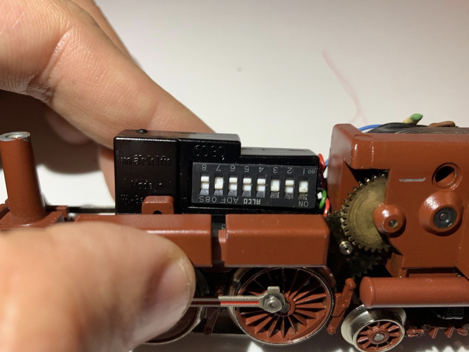

Meanwhile, I opened up the loco and found the decoder. I set the dip switches to 1,3 & 7 ( ON ) which corresponds the address 19 as stated in the manual. However, the result is the same. I am coming of the view that the decoder itself may be faulty. I checked the connections / soldering etc. but am finding that to be fine...
Hmm, are you sure that is the 'on' direction? What happens of you switch ALL the switches to the opposite side and try address 19 again?

You have contradicted yourself in the switch settings and the photograph. Adress 19 should be switches 2,3 and 7 on
Offline amartinezv
#10 Posted : 26 August 2019 10:20:26(UTC)
amartinezv
Joined: 25/08/2004(UTC)
Posts: 334
Location: Madrid,
Yes it is true address 19 is switches 2, 3 & 7 to on. (and you have 1 to on instead of 2)
Best regards and thanks @Rwill

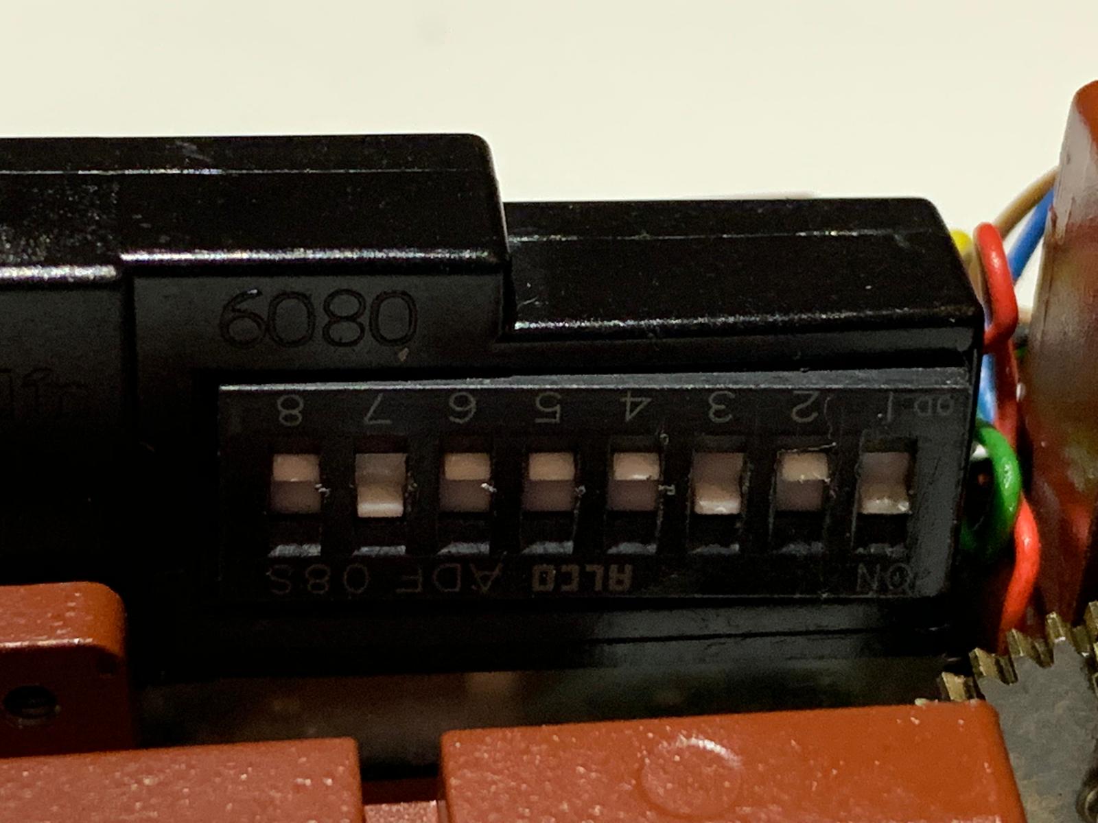

Actually, I posted the wrong photo which is for address 18. I earlier tried address 19 ( 2,3 & 7 ). Since, this did not work, I tried to use address 18 as well. The loco just runs the same without me having any control.....
I subsequently tried the 'FIND LOCO' option on my MS. I was careful to put only the present loco on the track. The MS starts searching for MFX and then MM2. All the time, the loco keeps running on the track. At one time ( and only one time this morning ) my MS recognized this as an 'MM2-18' and I saw the loco headlight tuning on.... for a few seconds and then it was gone .....
Unfortunately the country i live is does not have a hobby store where i could take this unit for a check up. In all probability, the decoder is at fault. does anyone know how much will it cost to have this replaced ?
Also just to correct myself ... the loco is fitted with a 6080 decoder.
It is a 6080 decoder AKA c80 decoder.

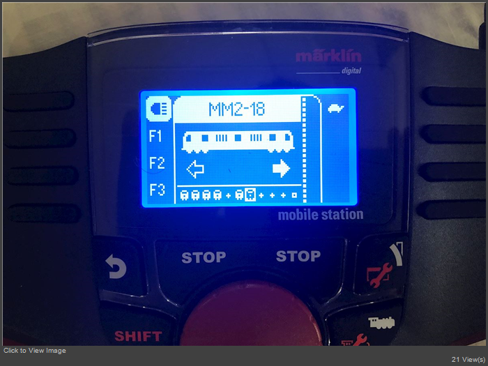

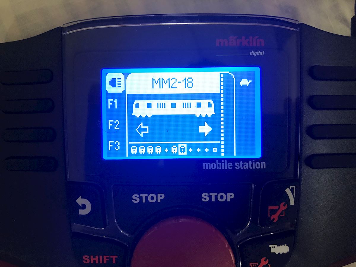

Guys ! Some good news at last !!!!BigGrin I managed to finally register the loco on the MS and it has now started to obey ! Love Love
WHAT I DID
1) I read somewhere on the forum that at times changing the track piece is a good idea. So I interchanged the track from my layout and re connected the wiring.
2) Activated the 'FIND LOCO' option on the MS .... the loco registered itself as an 'MM2-18' ... I am now able to control it through my MS
3) The dip switches are set at 1,3 & 7 which means the address is 18 which corresponds to LOCO 3609 as per the manual.
WHAT IS STILL NOT WORKING
1)Once I switch off the power completely and turn it back on, the LOCO disappears from the MS. I once again need to go to the option of 'FIND LOCO' and it registers itself again. Tried repeating this process 2 -3 time and its the same every time I do it. I have no clue as to why this happens. It is still a faulty decoder playing its tricks ?Blink
2)The loco is actually working at address 18 ( 1,3 & 7 ) instead of address 19 ( 2, 3 & 7 ) which it is supposed to be as per the manual.
3) The loco registers itself as 'MM2-18'.... Really do not know what is this supposed to mean.
f462550d-ffca-4abc-b9ee-0b5d754458ae.JPG2f1baedb-9bac-4cb0-8cb8-3e9f0b4acfbd.jpgIMG_4892.jpgIMG_4909 2.jpg
Edited by user 27 August 2019 07:53:40(UTC)  | Reason: Not specified
So what happens if you search the database for either a 3607 or 3609 (depending which address you have the switches set to) and select that as the loco, instead of using the 'find loco' function?

MM2-18 means that this is the second MM (Maerklin-Motorola) locomotive registered and this one has the address 18.
I do not know if the MS/CS will detect a classic decoder. I know that it will identify ESU type plug and play decoders, but it may not ID older 6090/6080 with dip switches.
You may have to manually enter a lok with MM (Motorola) address and that will then allow you to control the lok. You can then save that info to a lok card for future reference.
You may be able to find the lok in the database, but I have not checked if it includes ALL Maerklin models or just the ESU/FX/MFX ones.

Thanks Mike .... the way I understand, my MS ( Mobile Station 60657) recognizes MfX, MM2 and DCC decoders.
Reagrds,
I could be wrong, but I think "MM2" stands for the MM2 protocol while 18 is just the address.
The MS2 will typically append "(1)" or "(2)" and so forth to avoid duplicate names.
And theoretically the MS2 can find locos with any MM decoder, including the 6080 and 6090 decoders. Practically it fails if F0 is unused or draws very little current, e.g. locos with LEDs instead of light bulbs.
No mfx locos in the database, but all locos with factory-installed 6080 or 6090 decoder should be there. No ESU models there.
So I tried your suggestion yesterday... I chose 3609 ( address 18 ) instead of 3607 ( address 19) on the MS database . The lok registered and I was able to run and control it. However, once I power off my MS and switch it on again, the lok disappears. I need to register it again to have it back on the MS. I tried this 2 - 3 times and every time ,the result is the same. So while the MS is registering the lok, it's not saving the setting.
Any suggestions on how to resolve this ? Mellow

Have you tried registering other locos? Do they persist? Pick an unused address (maybe 77), register a loco entry for that address and check if it is still there the next time. If it persists, just change your loco to that address...
Make sure you use any of the slots 1 through 10 for the loco, not slot 11 which is volatile by design.
Is the loco still in the loco list even if it loses its slot?
Have you tried resetting the MS2?
The MS2 has a file system and sometimes one has to delete files from this file system to restore proper operation - files that can be corrupt, but persist a reset.
Rohit
In addition to @H0 suggestions, how many locos do you have?
The MS 2 database has a maximum for 40 registrations places since software version 3.55 for a MS 2. Before it were 10 registration places. Well yes, I do not write locos, because e.g. mfx decoders in a coach take a registration place too. So it can be a registration data is not saved because of an overflow of your database. But myself I realized, even at a CS 3 sometimes mfx registrations were lost. But because after setting a loco on the tracks again, it is quickly reregistered and so no problem by that.
Besides a databse overflow must exist other reasons for loosing registrations. I read somewhere, somebody had tested how many locos a CS 3 can register. After 2.000 (yes two thousand) registrations he stopped doing it. Also Märklin has a function in the CS 3 "searching mfx decoders". They do not write why, they only write, it can happen and therefore this function exists.
BTW which software version do you have on your MS 2?
