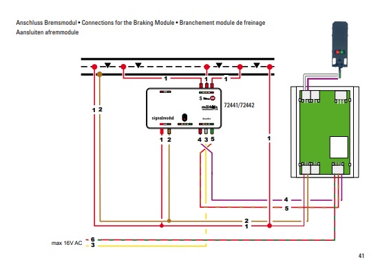

I'm trying to install a 72442 Braking Module with a 76495 (Color Light Home Signal with a Color Light Distant Signal). I'm clearly doing something wrong because my train is coming to a power-off stop as soon as it hits the braking section (after the transition section). I am using the wiring diagram for the braking module from the manual for my signal.
I first suspected that I had mixed up the braking and emergency stop wires, but I've checked them, and they are correct. I've also verified with a meter that I have a connection with the plug and the track for each of the three wires coming from the braking section of the braking module (upper right in the wiring diagram) and that I'd correctly attached each to the "B" spade of the track. I also double-checked each of the other wires coming into or out of the braking module.
The one area of confusion I have is regarding the wires going to the 16v power. For powering this I'm using the constant 16v connection of a 6646 transformer. There are two wires being shown going to the 16v power in the diagram: the yellow wire (number 3) coming out of the braking module and the red-green wire coming out of the signal controller (number 6). I couldn't find any documentation telling me precisely how these wires should be connected to the transformer, so I assumed that the yellow wire (number 3) should be connected to the yellow terminal of the transformer and the red-green wire (number 6) should be connected to the brown terminal (the one nearest the yellow terminal) on the transformer.
Have I made correct assumptions here? Assuming I have, does anyone have any suggestions as to where to look to try to figure out what I've done wrong? I've checked the usual suspects and as far as I can tell, I've set things up correctly.
Thanks in advance for any help anyone can provide
Lee Sauer
Sacramento, CA
Offline clapcott
#2 Posted : 19 August 2019 22:59:49(UTC)
clapcott
Joined: 12/12/2005(UTC)
Posts: 2,448
Please check the voltage from the middle output of the 3 "1's" at the top right.
- when signal is green it should be AC
- when signal is red it should be DC (expect around 22 v)
You should first try this while the wire iss NOT connected to the track , in case there is a short occurring out on the layout
You make no mention of the capability of the locomotive you are testing with.
Is it capable of honoring the "DC=Slowdown" behaviour.
If the decoder is theoretically capable, has it been been disabled.
Hi Peter,
Thank you for the very quick response. I'll check the voltage of the three "1's".
The loc I'm using for testing is the 2018 Insider Swiss Crocodile (39567). I've made no modifications to the decoder, either physically or via the CS3+, so I don't think that's the issue.
Lee Sauer
Sacramento, California
Lee Sauer
Sacramento, CA
Offline leesauer
#4 Posted : 25 August 2019 02:12:17(UTC)
leesauer
Joined: 24/01/2008(UTC)
Posts: 92
Location: Sacramento, CA
I finally got it working. I was a bit surprised that none of the functions (e.g., turning lights on or off or sounds) worked while the loc was stopped in the braking section while the signal is red. That's a tiny bit disappointing since I'd hoped to have the sound of squealing brakes while the loc was braking, but it is what it is.
Thanks for your help, Peter.
Lee Sauer
Lee Sauer
Sacramento, CA

I'm having somewhat similar problems with a 72442 and 76494. I have wired up the setup according to the diagram with the relevant isolation done.
Here's the problem:
1) The loco Br 94 (mfx) stops as soon as it enters the first (green) section. There's a buzzing sound, like a short circuit sound from the loco when it stops.
2) Heeding your advice, I have checked the voltage:
When the signal is red:
Section 1: 0V
Section 2: 15V DC
Section 3: 0V
When the signal is green, it's 0 V across all sections.
I have been trying various methods to troubleshoot but to no avail and hope to leverage on your expertise in this matter to resolve the problem. It's driving me crazy! Confused

Offline James Yao
#15 Posted : 29 May 2020 10:03:49(UTC)
James Yao
Joined: 14/09/2009(UTC)
Posts: 41
Location: Singapore, Singapore
Hi TEEWolf,
Thank you for providing the various information. Love It certainly is helpful in helping me figure out the problem.
It turned out that the wires from the "Signal" plugs on the braking module were reversed. I managed to put them in the right order after some trial-and-error. Now the braking behavior is observed with braking sounds too. I also tried with a retrofitted (ESU DCC) Piko Br 218 - it just took off in the braking sections. LOL I guess it's because of the lack of braking command interpretation as mentioned above. But no worries on that one.
All is good now. BigGrin
James
